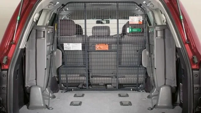

If anybody wants a crash tested Milford Barrier, this person is selling them on eBay. I don't think anybody will be importing these again if the current exchange rate holds. These are full barriers that will help prevent the seats from giving out too.
Important to note that it states these are tested to 130lbs at 30mph. Aside from these being relativly low numbers, the bigger issue with this claim is that it is not actually crash tested in the vehicle. The barrier may be fine but my concern is how the barrier interacts with the vehicle and vice-verse.
I do love the pics on their website though. I would be willing to wager that there is more than 130lbs behind everyone of those.
http://www.milford-auto.com/products/cargo_barriers

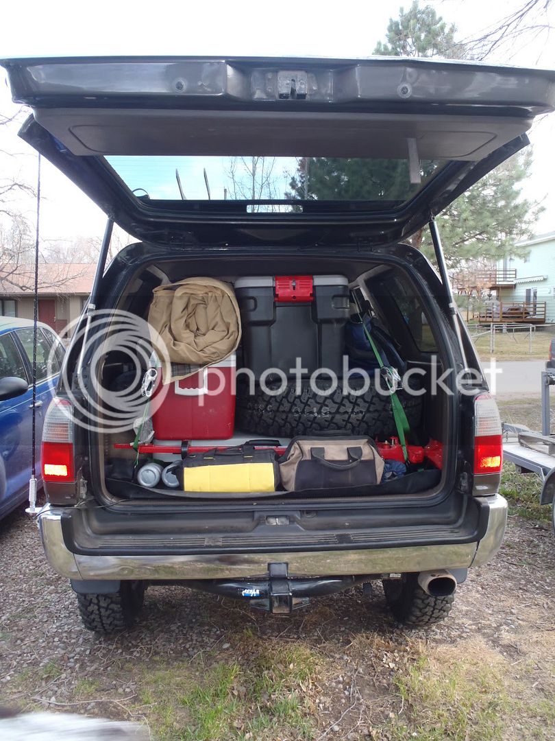

Here are some photos of the interior of the 4Runner. As you can see, this guy doesn't mess around when he goes camping, he lives large and packs large.
It's hard to see see in the photo but everything was tied down to the 4 factory mounting locations in the truck. You can see the green strap loop around the hi-lift and into the floor mount. A lesson to never underestimate what can move around even when secure, imagine if this was a 70-80mph crash.

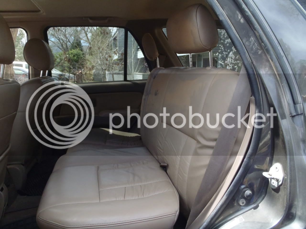

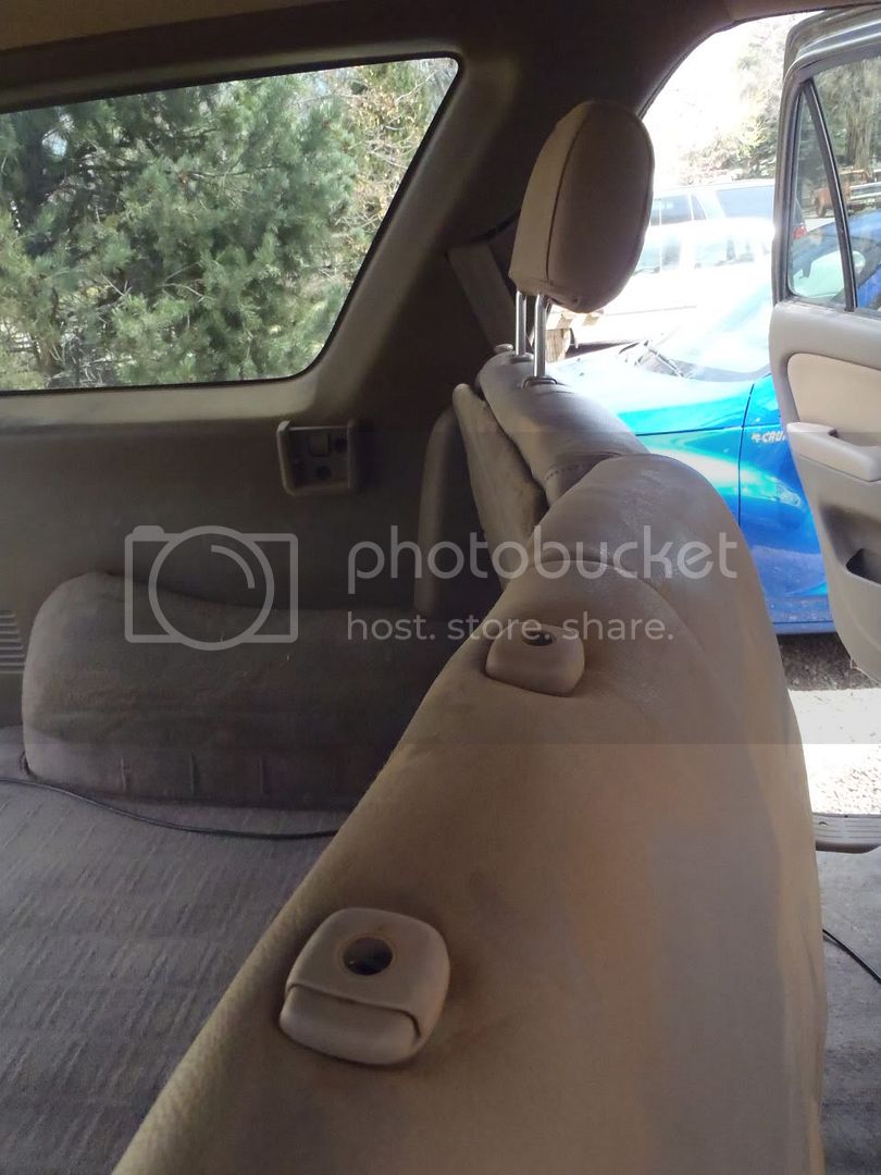

Here is the aftermath. This made me especially glad about the drawers I have because this movement has potential for injury for second row passengers.
There is more to it than just the one 130lb impact at 30mph. The 130lb is a single object which can potentially cause the most damage. They also need to withstand 265 lbs of loose objects not weighing more than 44lb each and 640lbs of objects not weighing more than 9 lbs each.
True, not of their barriers are "crash tested." They do make hundreds of different models and to do such would cost an extreme amount of money. However, they DO crash test some vehicles when auto manufacturers requires it.
I do not have any documentation that Toyota required crash testing, however, Milford is the OEM manufacturer for Genuine Toyota Cargo Barriers. For such a large manufacture to not require this in addition to their own testing would surprise me.
It would be great to see those data. Maybe all this talk of a metal barrier potentially being unsafe is hoopla. I still feel that a nylon barrier would be safer if the mounting points could be figured out.
I do think metal barriers can be dangerous if not designed properly. But with the Milford barriers, I don't see any obvious impalement hazard. The mounts have bends in them and are designed to absorb the impact. I'd even say the full height barriers would offer "some" added rollover protection.

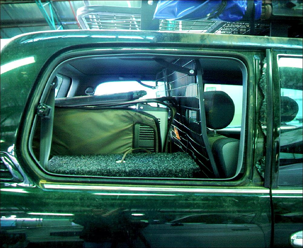

I stumbled onto this pic... it doesn't really show anything except that it was crashed.
http://autospeed.com/cms/A_1134/printArticle.html
