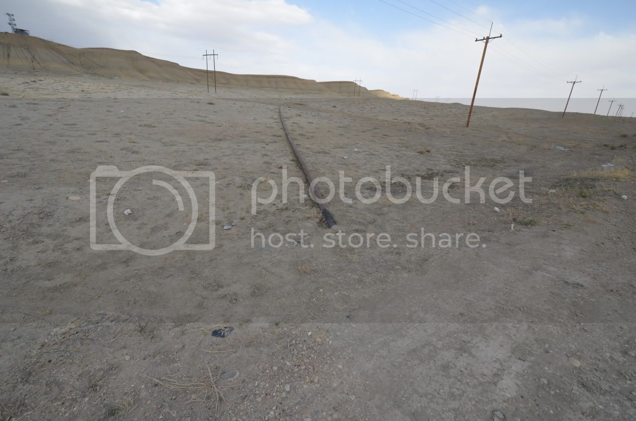

A half mile down the road and everything was going fine, the road was overgrown and rough in areas but nothing was severe. We were cruising along at 40-50mph (no speed limits were posted) and enjoying the scenery. A lot of abandoned equipment can be found all over the area making it hard to keep ones eyes on the road. This Pipe was visible snaking across the landscape, at the point where it crossed the road, the installers (probably many years earlier) had not repaved the crossing and it had eroded to a ditch nearly a foot deep.
http://i1095.photobucket.com/albums... 2012/2012-04-01BCCSanRafaelOvernight2454.jpg
I saw the ditch ~100 feet away and realized that it was really deep from about ~50 feet. I hit the brakes hard and slowed to cross it gently. The next few seconds are very clear in my memory and I feel are accurate.

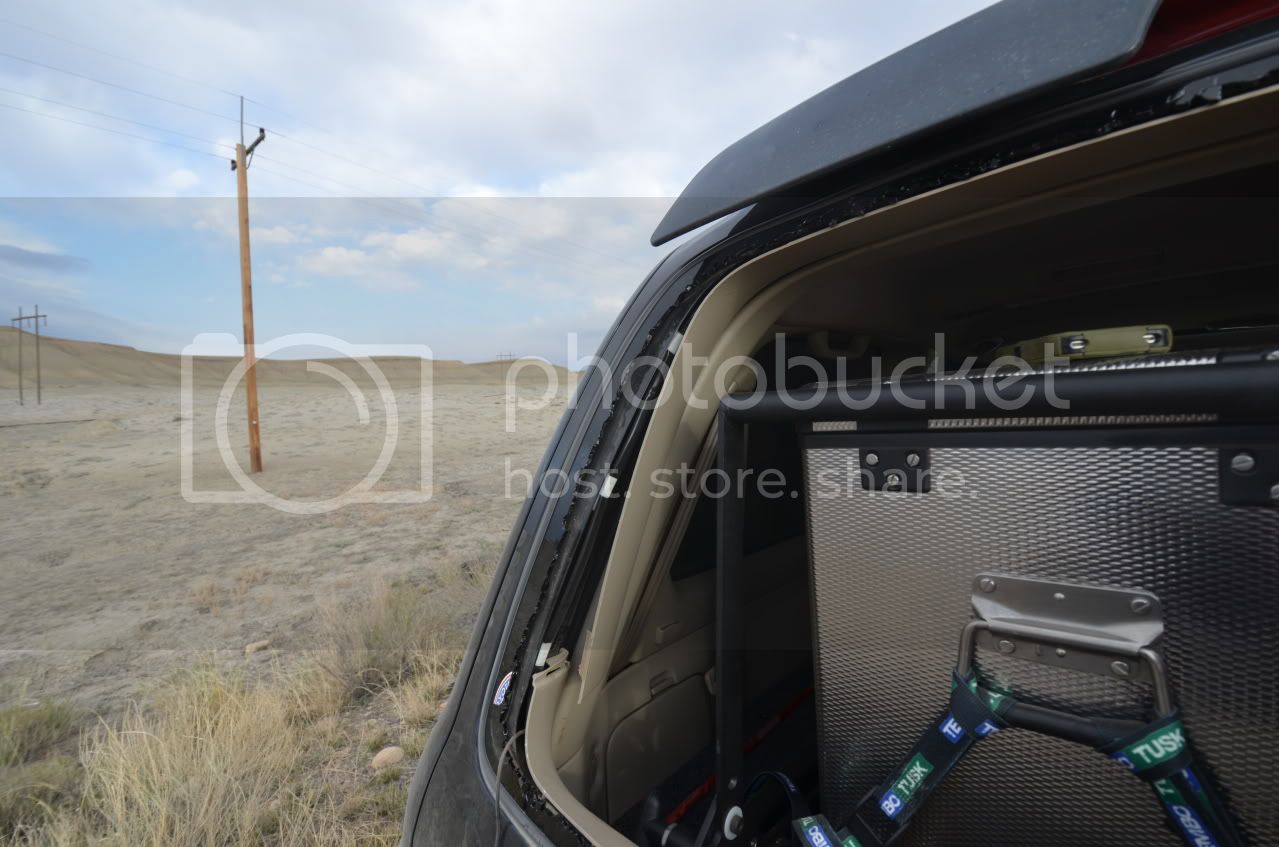

Now some would look at these photos and say that the tire carrier and hi-lift caused most of that damage. This is an accurate statement but I feel the damage would have been many magnitudes greater if I had a stock bumper. Yes the glass, tail light and rear hatch were broken by the movement of the tire carrier but all of that would have been destroyed anyways with a regular bumper.

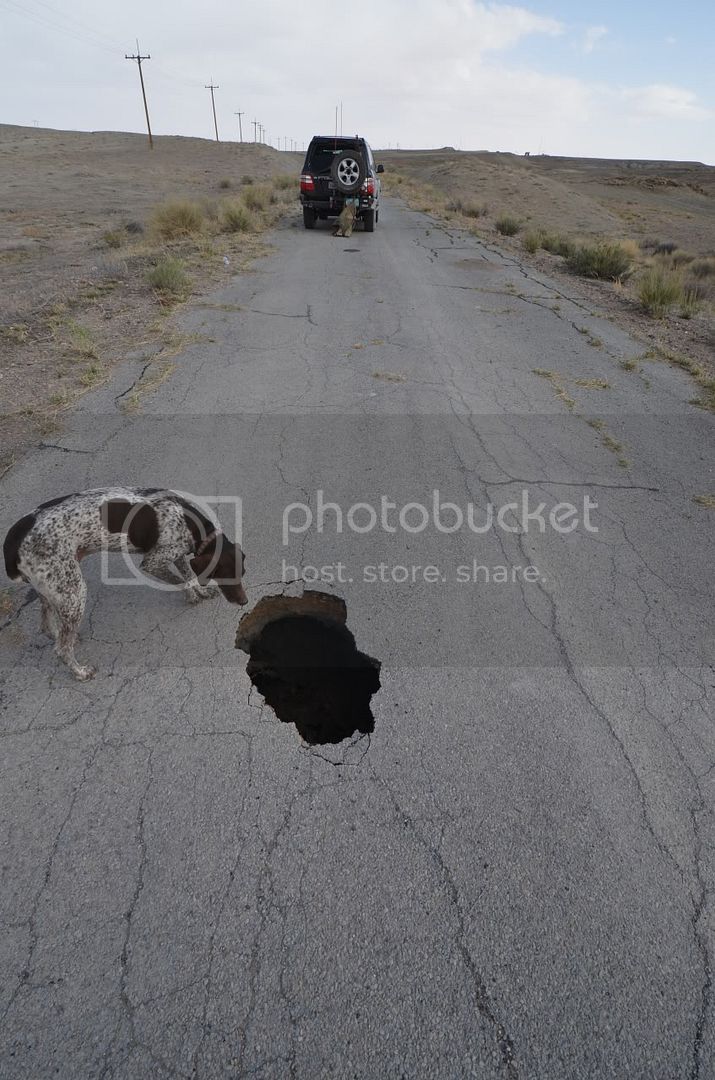

Here are a few wide shots showing the surrounding. The hole in the second pic is big enough for me to get into.
