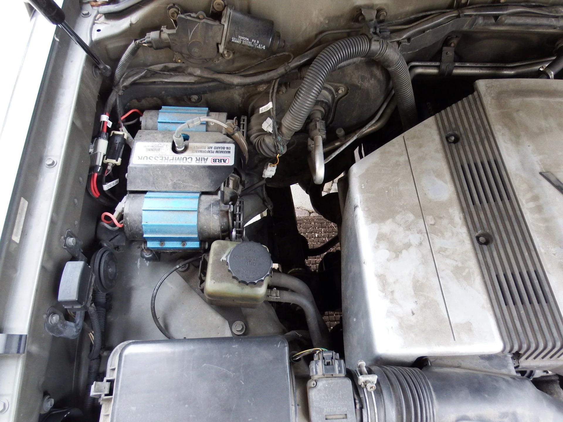

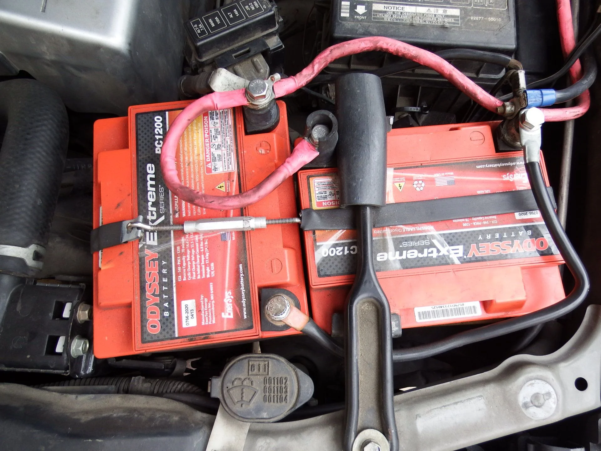

Here are a few pic's of my battery setup and where I mounted the compressor. Note the simple plumber's strap and turnbuckle. I used shrink tubing over the plumbers strap to avoid sharp edges and reduce the amount of exposed bare metal. The plumbers strap get looped ALL the way under the factory battery tray and up and over the batteries. Yes there is a section of 2" x 12" under the batteries to lift them up a wee bit. I still use the factory battery strap, but it won't work for two batteries, thus the plumbers strap.
Cheers!
