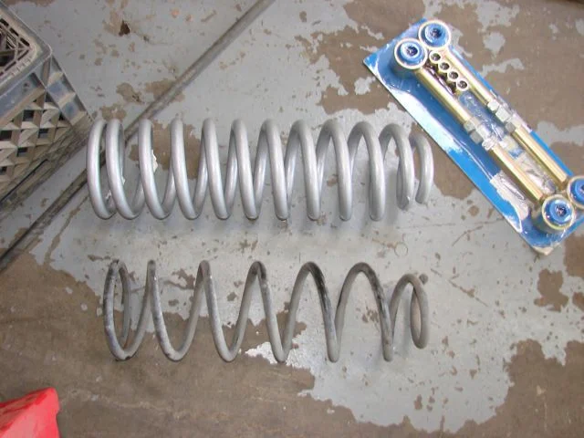

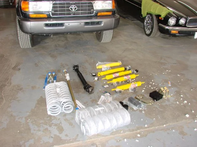

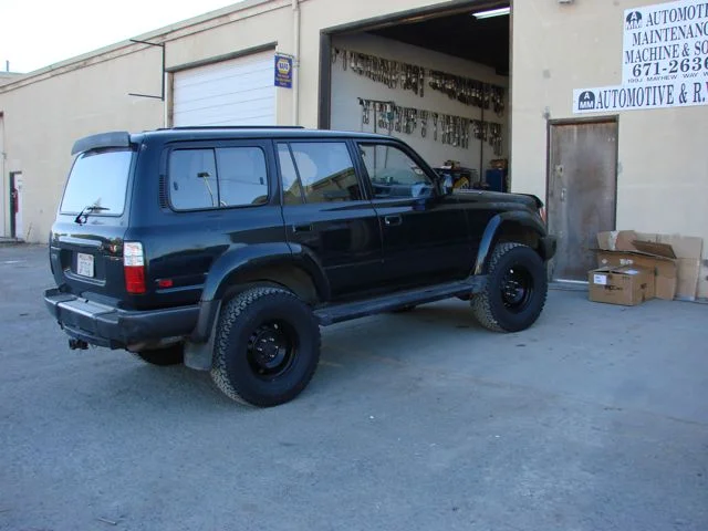

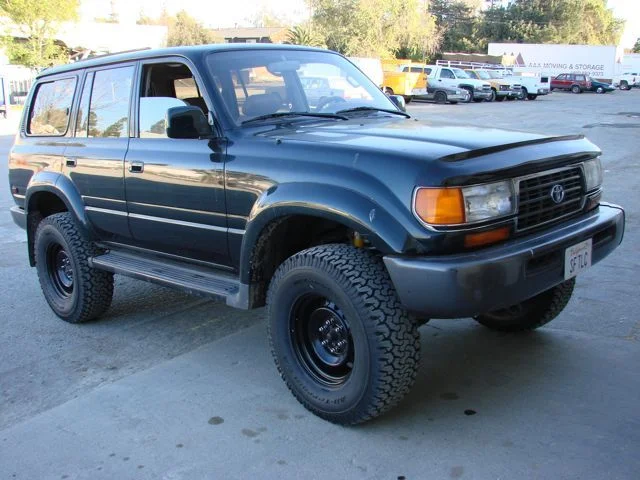

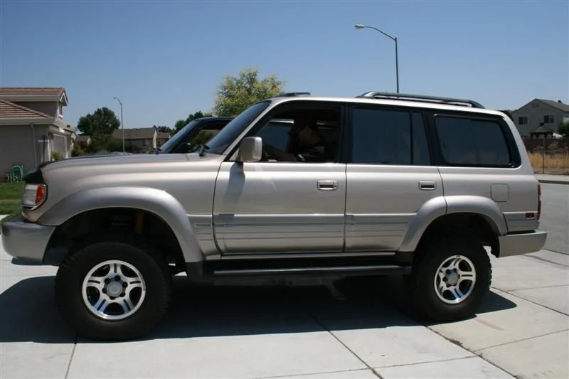

I put a slee 4" lift on my '95 along with some 315 BFG AT's on FJC steelies. The most difficult part was the camber correcting plates & grinding drown just the right ammount on the stock mounts to get them to fit.

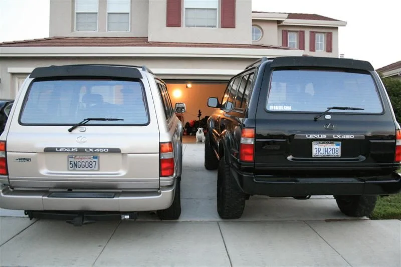

Here's the before and after hub - flare measurements:
Before:
DS Front: 19"
PS Front: 19.5"
DS Rear: 20"
PS Rear: 20.5"
After:
DS Front: 24.5"
PS Front: 24.5"
DS Rear: 25.5"
PS Rear: 25"
I'm really happy with the end product, now I just need to get some weight on the truck to get rid of the bounce. It no longer sloshes around the corners.
Looks awesome man. Love the stealies.

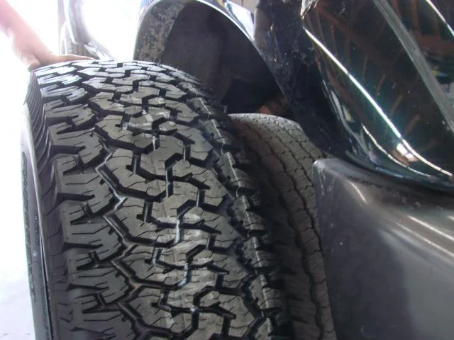

I like the FJC rims, what's the backspace on those?
Not sure what the FTC steel wheel backspace is, but I did have to use 1.5" spacers to get them out to close-to-stock width and no rubbing on the inner wheel well.

oh and for the tech question.... how long did the instal take?

The lift took me about 8-9 hours to complete, but I took my time doing it. I feel I could do it in 5-6 now. I really took my time on fitment of the caster plates, I wanted to grind off as little as possible.

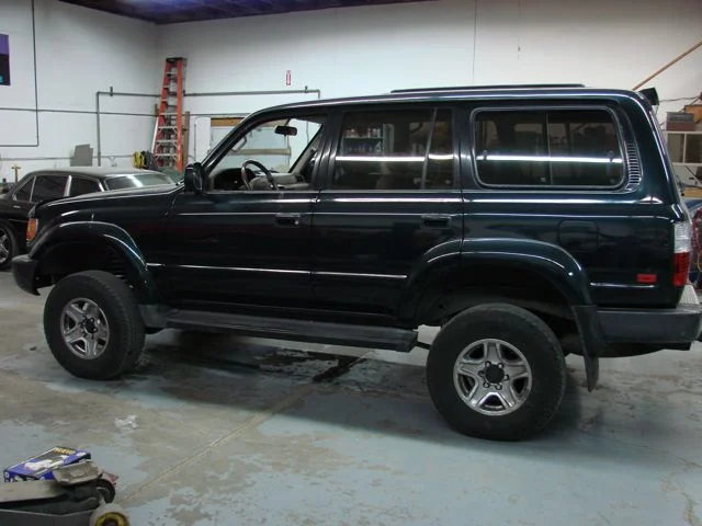

Looks good SF80. But I already had a good look at it up at 4x4 Labs. I was the guy picking up his bumper just when Luke was finished tacking yours together.:beer:
