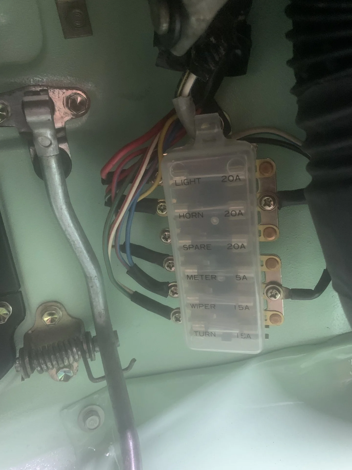

Gauges work! Kept blowing the 5A fuse and finally figured out the alternator power wire was never tightened: sometimes I do too many things at once. Since tightening that and new fuse block installed, the gauges work fine. But..... my front heater core is dripping. About 3 drips out of the heater box a few hours after I shut it off. It was pressure tested but I’m guessing adding heat and pressure took its toll. Out it comes and I’ll send it in Monday to get repaired. Meanwhile, getting the roof cap ready for paint and install. My wife’s birthday is next weekend and I’ve been telling her all along we will take it for ice cream on or around her bday. Maybe just with no roof cap!

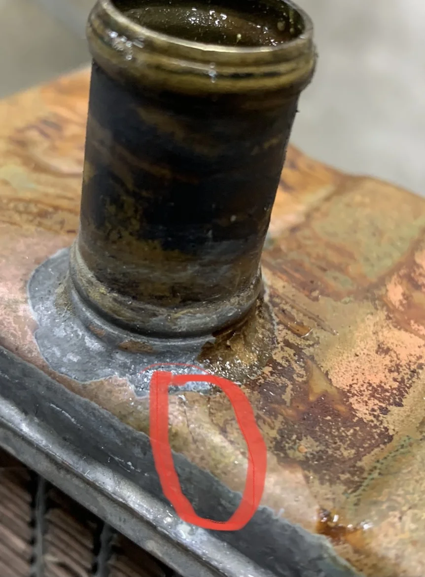

Found my heater core leak. Tiny crack next to one outlet/inlet. Holds air pressure but the slightest movement and it leaks. I’ll see if the local radiator shop can repair it, if not I’ll get one coming from cityracer.

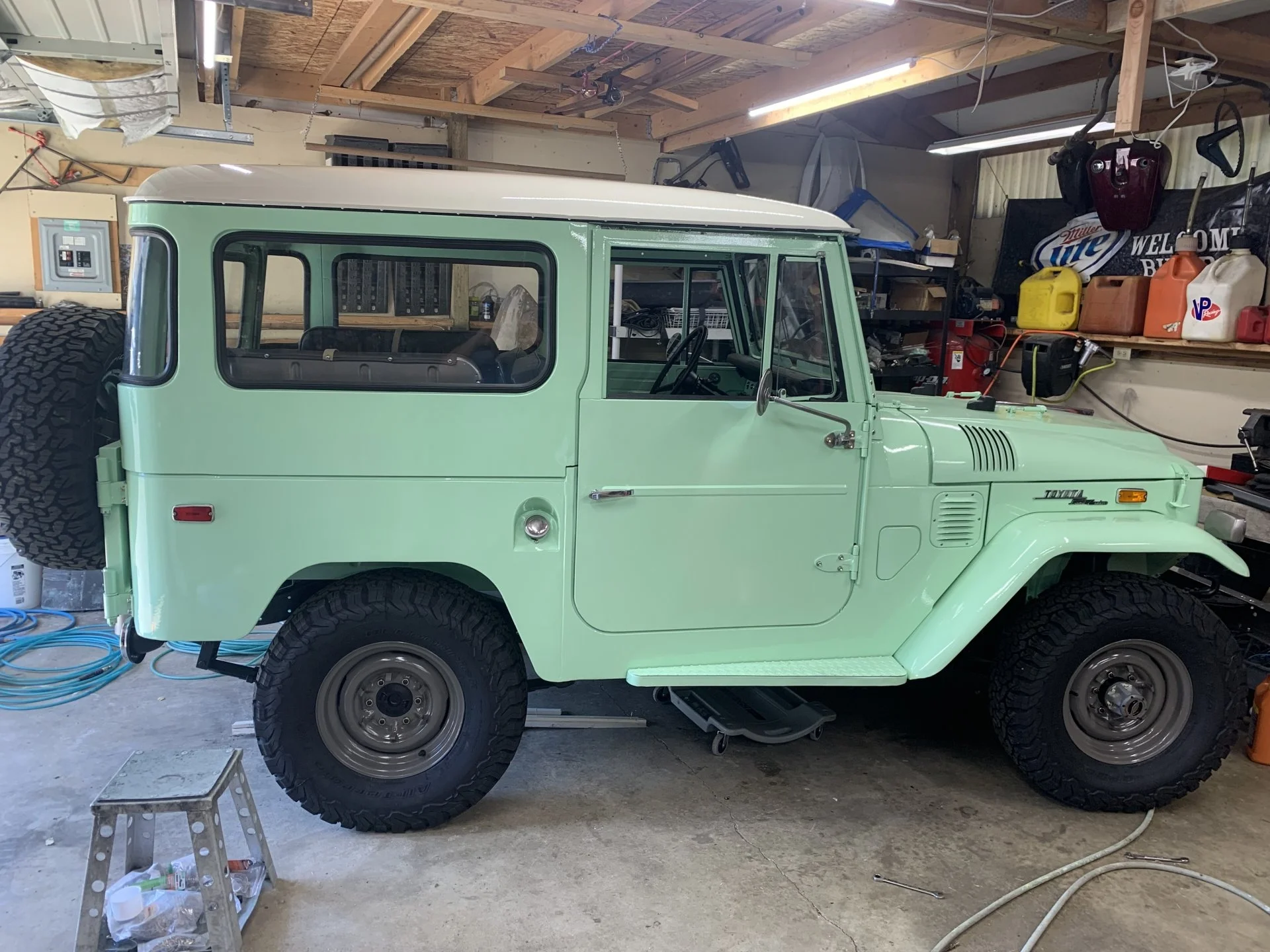

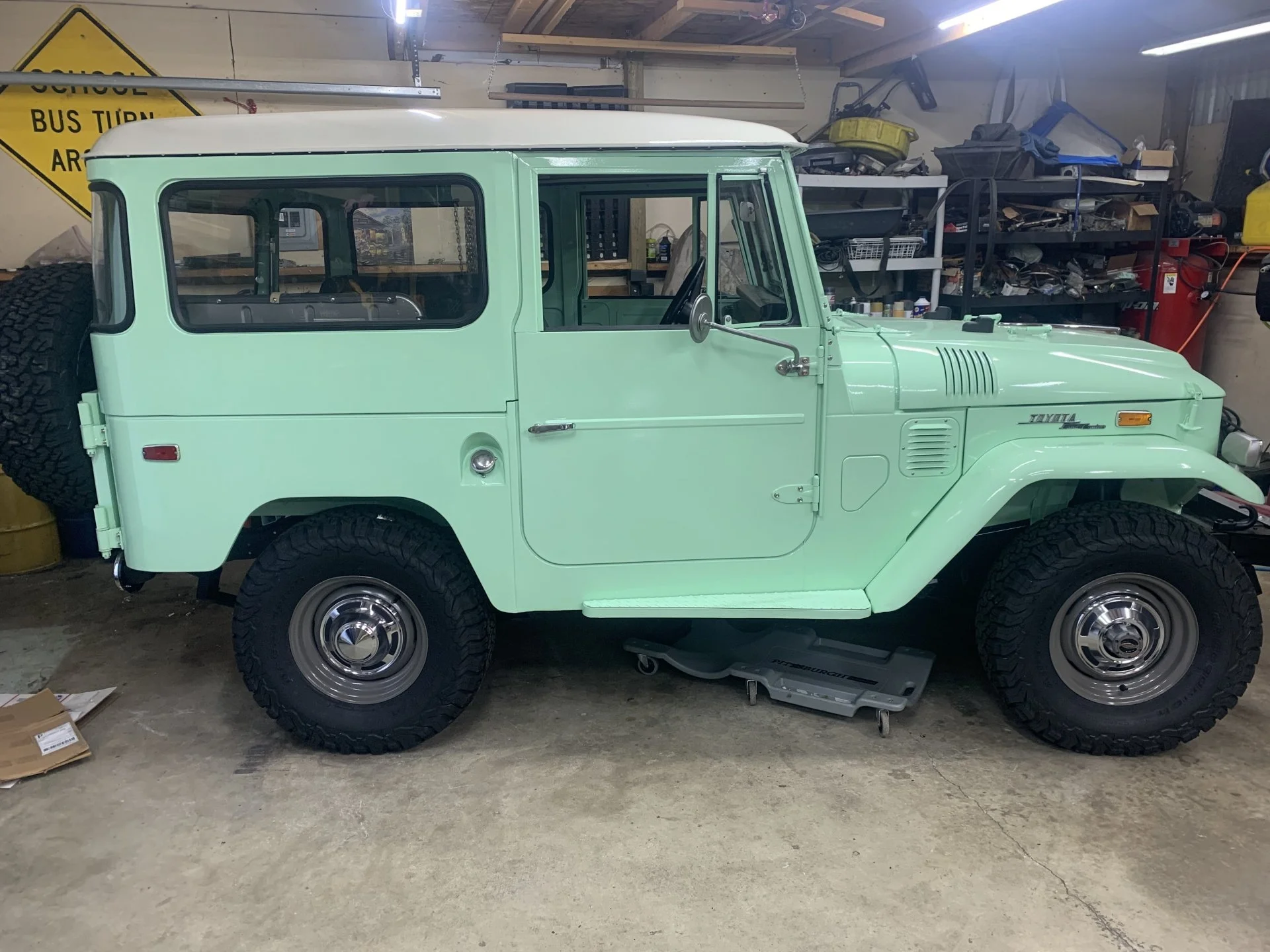

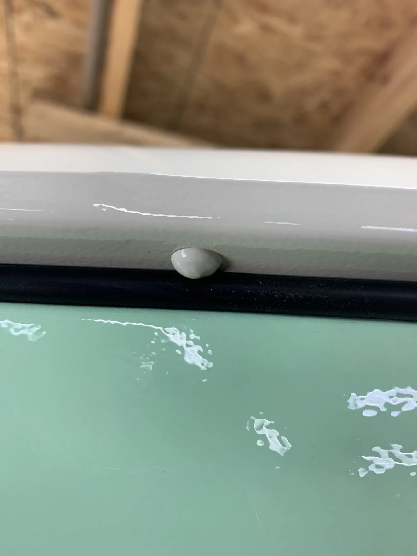

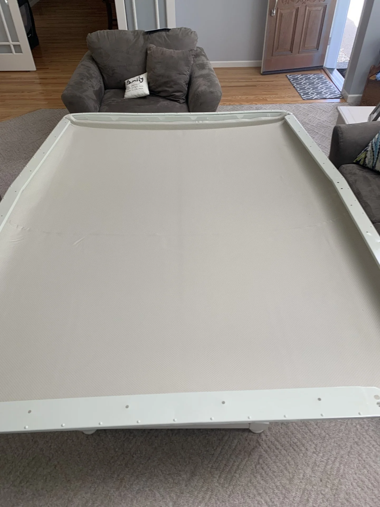

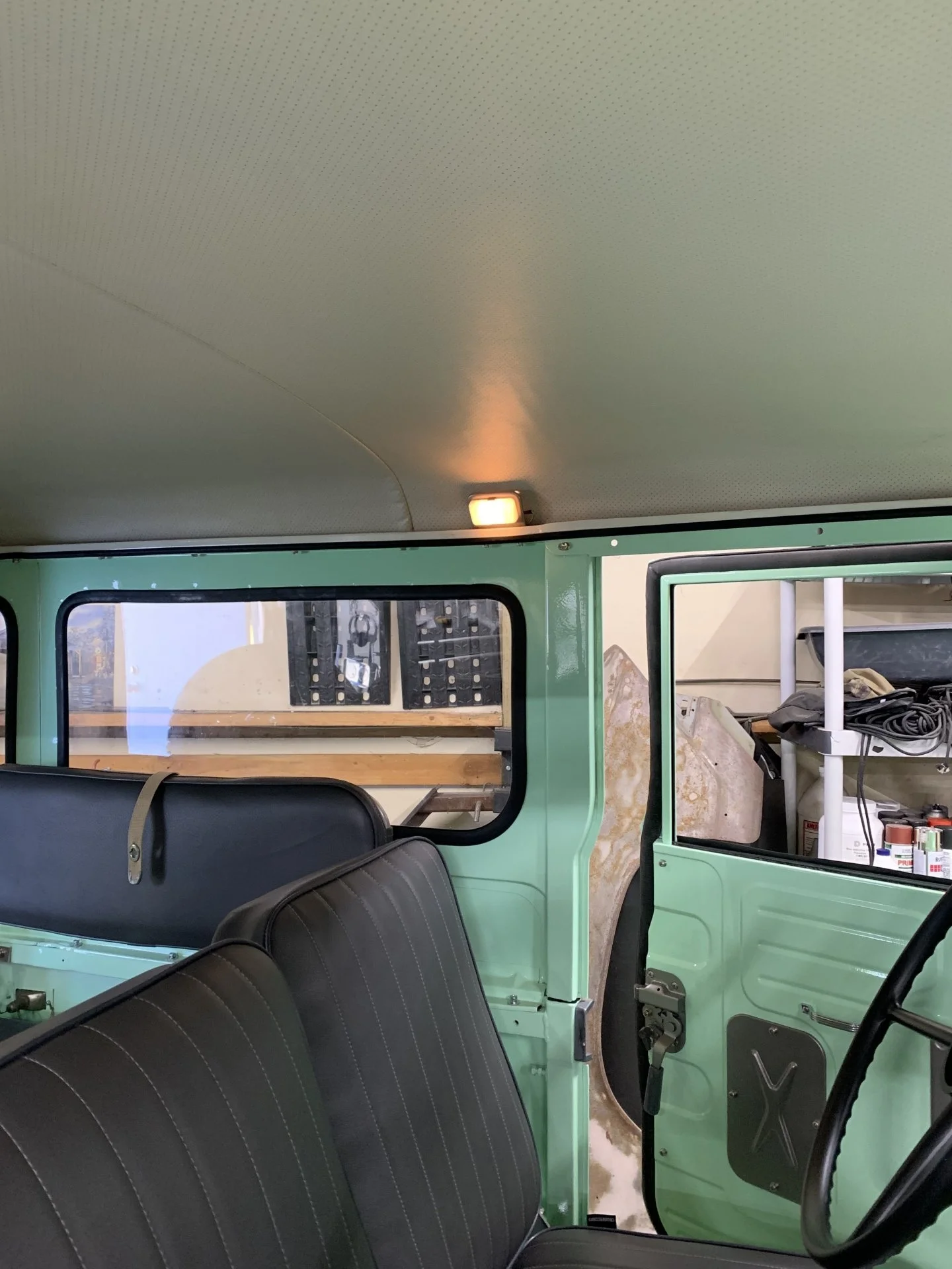

Been a month! Lots of house projects so cruiser hasn’t had too much attention. New heater core and water pump are in and no more leaks. Got the roof cap holes fixed and riveted back onto the rain gutter and seam sealed it all up. Took about 1.5 tubes of seam sealer; SEM 39387. Painted the bezel and top cap last week, did the headliner a couple days ago and top cap is on. Even the courtesy light is working.
For my own or anyone else’s future reference, for the bezel and top cap I used TCP Global single stage acrylic urethane (same as body) in Cygnus White T012 for a 1974; their system didn’t show anything for earlier than that. I bought a half gallon kit and used about 2/3 of it doing 4 heavy coats over white epoxy primer.

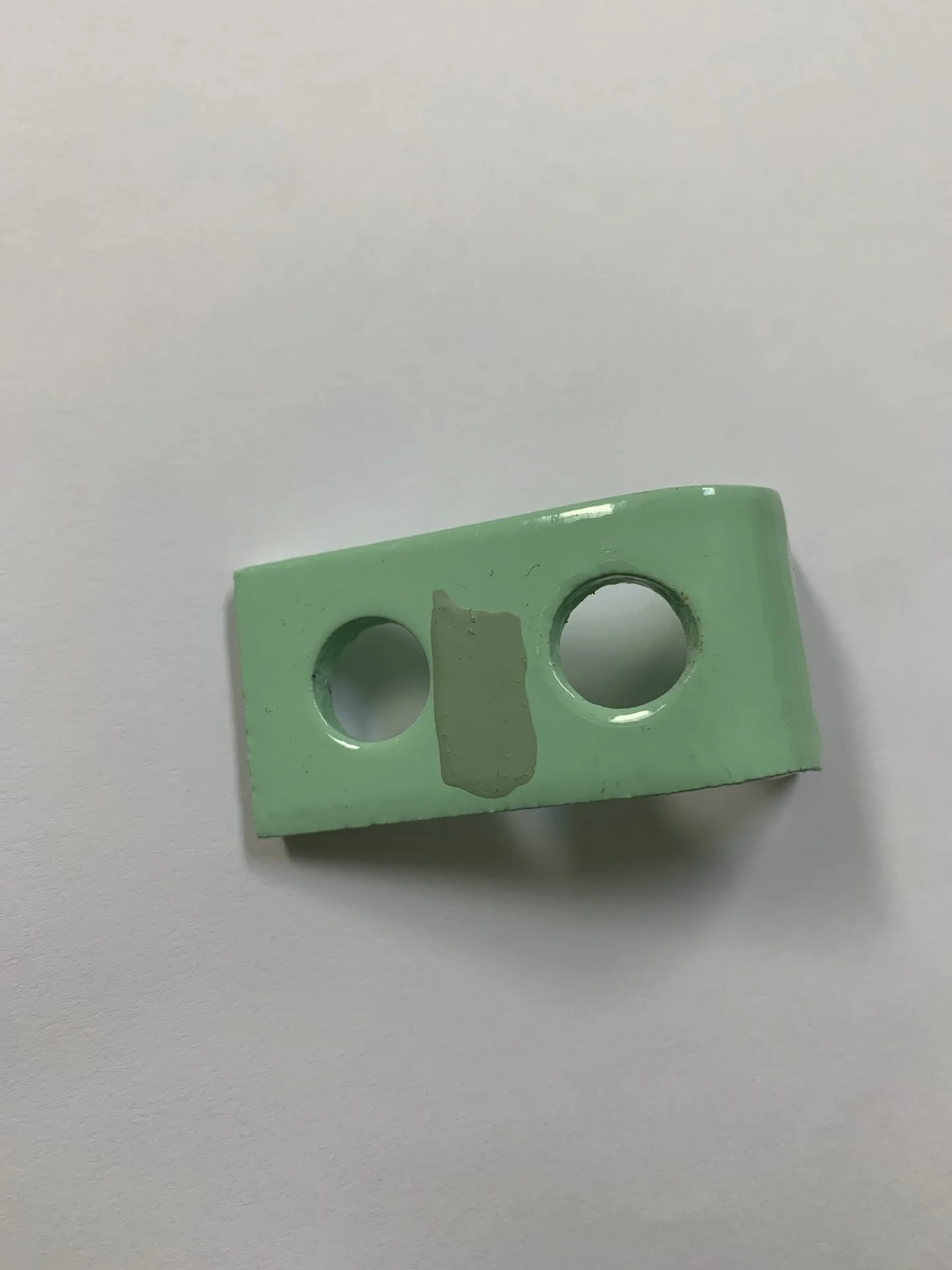

A side note; I got a couple very minor chips during assembly and ordered a touch up kit from Automotive Touchup but it’s way off, even though the code is the same. But, it looks identical to another friend’s Fashion Green 40. Pic below of a spare piece I painted on white paper for color comparison.

A side note; I got a couple very minor chips during assembly and ordered a touch up kit from Automotive Touchup but it’s way off, even though the code is the same. But, it looks identical to another friend’s Fashion Green 40. Pic below of a spare piece I painted on white paper for color comparison. View attachment 2713709
Just looking at your Spring Green part, it does look a bit different than what I have seen in past, but who knows where the paints and trucks were from.

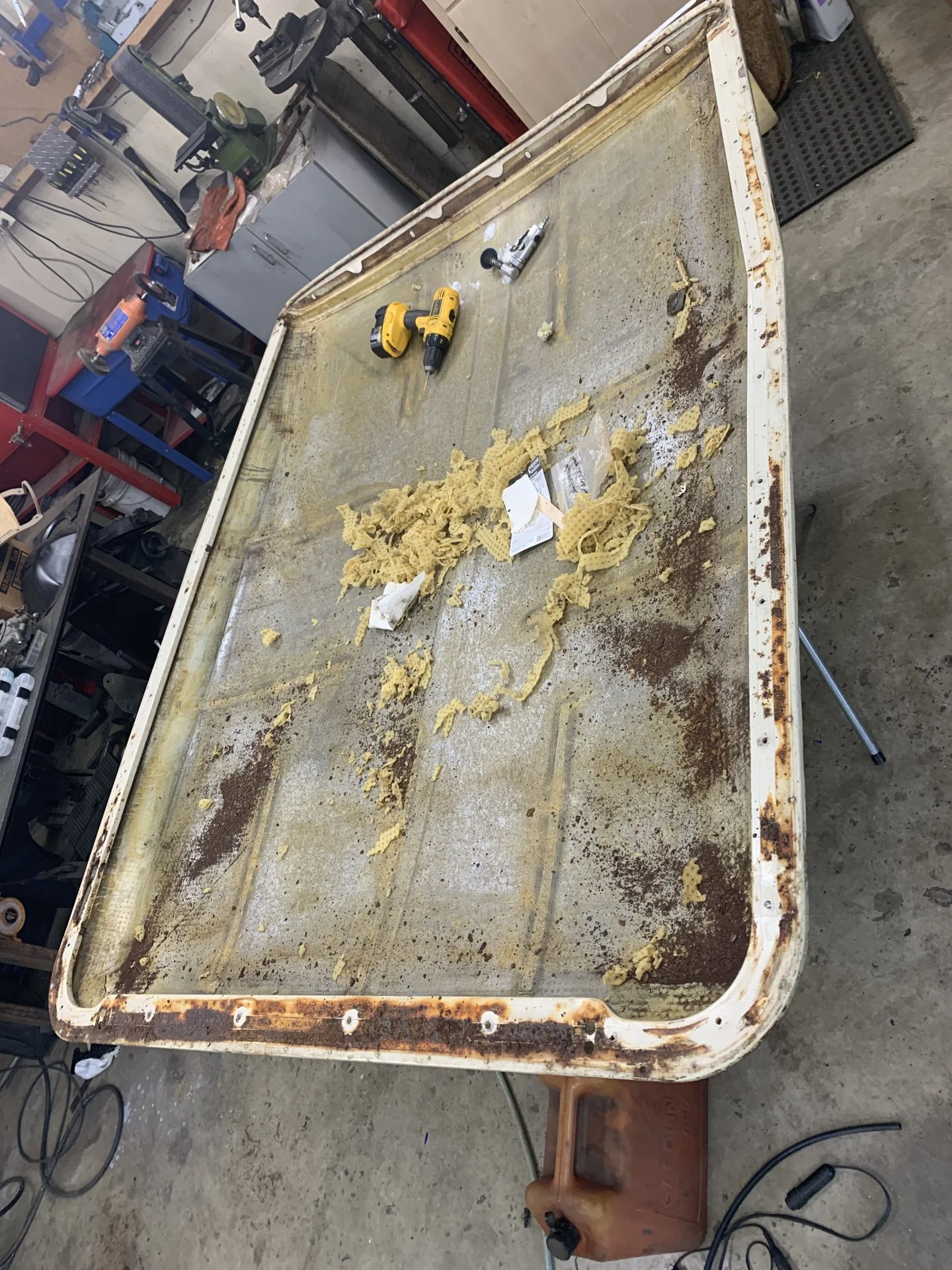

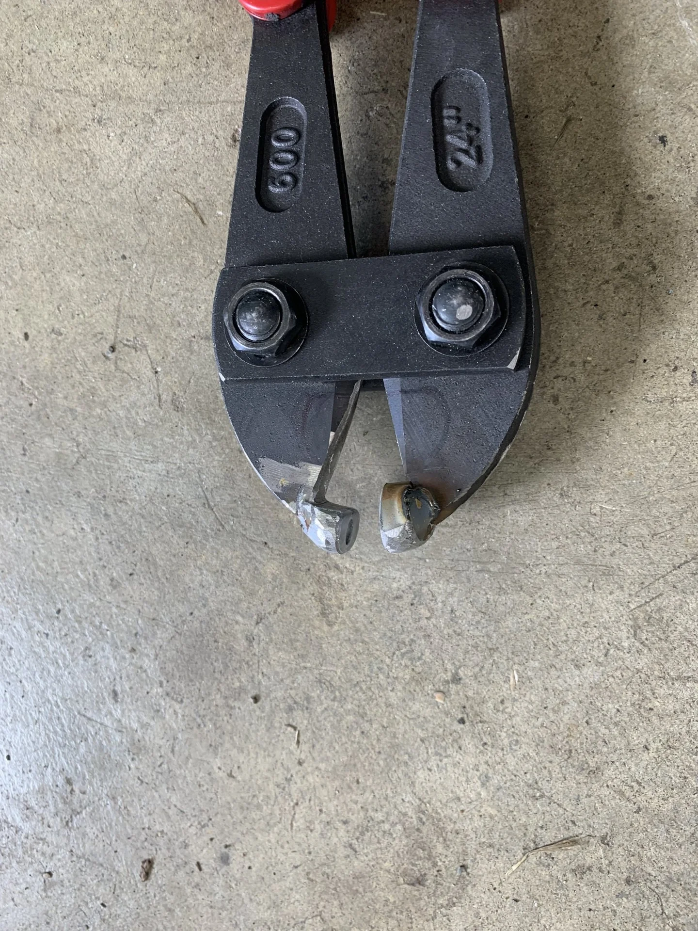

can you give more details on your riveting tool you made? Or even better, you willing to lend it out? :)
Ya man!
First, full disclosure, I copied the idea from an older post I saw. It’s a set of harbor freight bolt cutters. I ground the cutting teeth down and also ground down a set of dies I got for some craft making something that I found on Amazon that had the right diameter dimples and welded them to the bolt cutters. Boom! Done. They work awesome, though the head side shape does make the dimple a little pointier than stock appearance.
As for loaning out, you betcha. I have another top to do at some point but currently no cruiser for it to go on so these will be collecting dust for awhile. PM me and we can figure it out if you’re interested.
Here’s two that show the worst of the “pointy-ness”. 75% of them look normal but some got this little point.

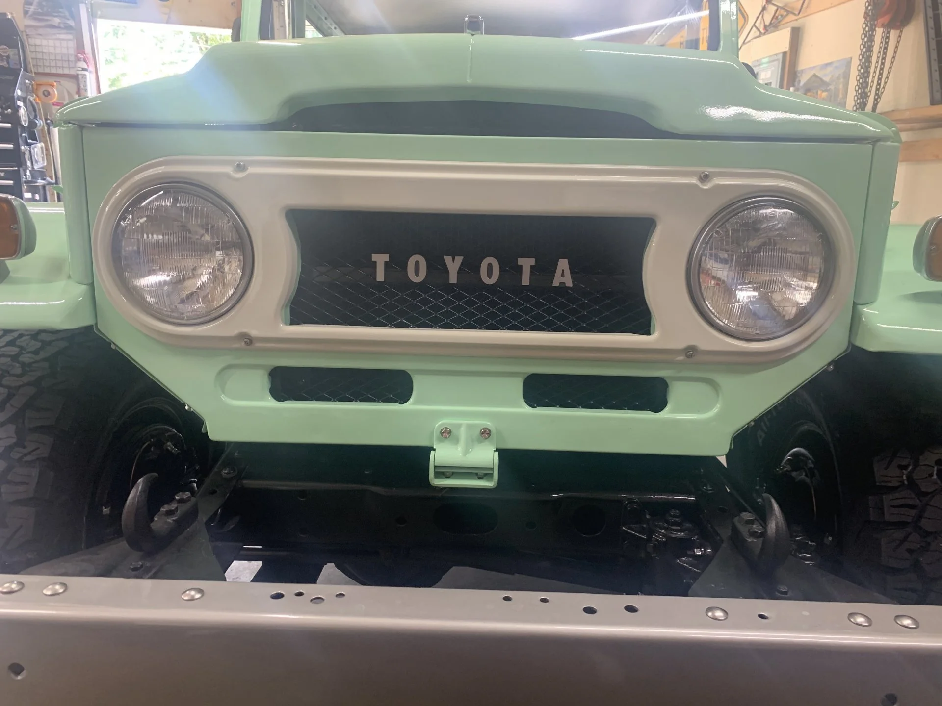

Bezel and hubcaps are on, made a list of the last bits before I can call it done. Hoping to get some done on it this week because I’ve got a busy few weeks coming up; we will see.
