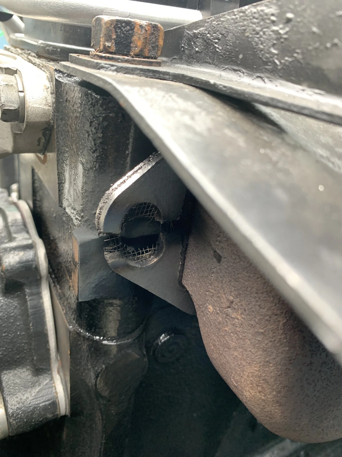

Happens to all of us LOL. Do you by chance know where your exhaust leak is? I think i still may have a leak on my build, however i have a nice thick gasket, and installed a header. Torqued the bolts to correct torque. So im not entirely sure where the leak would be.
Yep. Leak is right at the front where the manifold meets the head. Started as a small tick that I actually thought was valvetrain noise at first, would go away once it warmed up. Now it’s just worse every time I start it. It’s a remflex gasket and that’s what I’m replacing it with. This is the first one I’ve ever had fail but I attribute it more to the F exhaust design than the gasket.

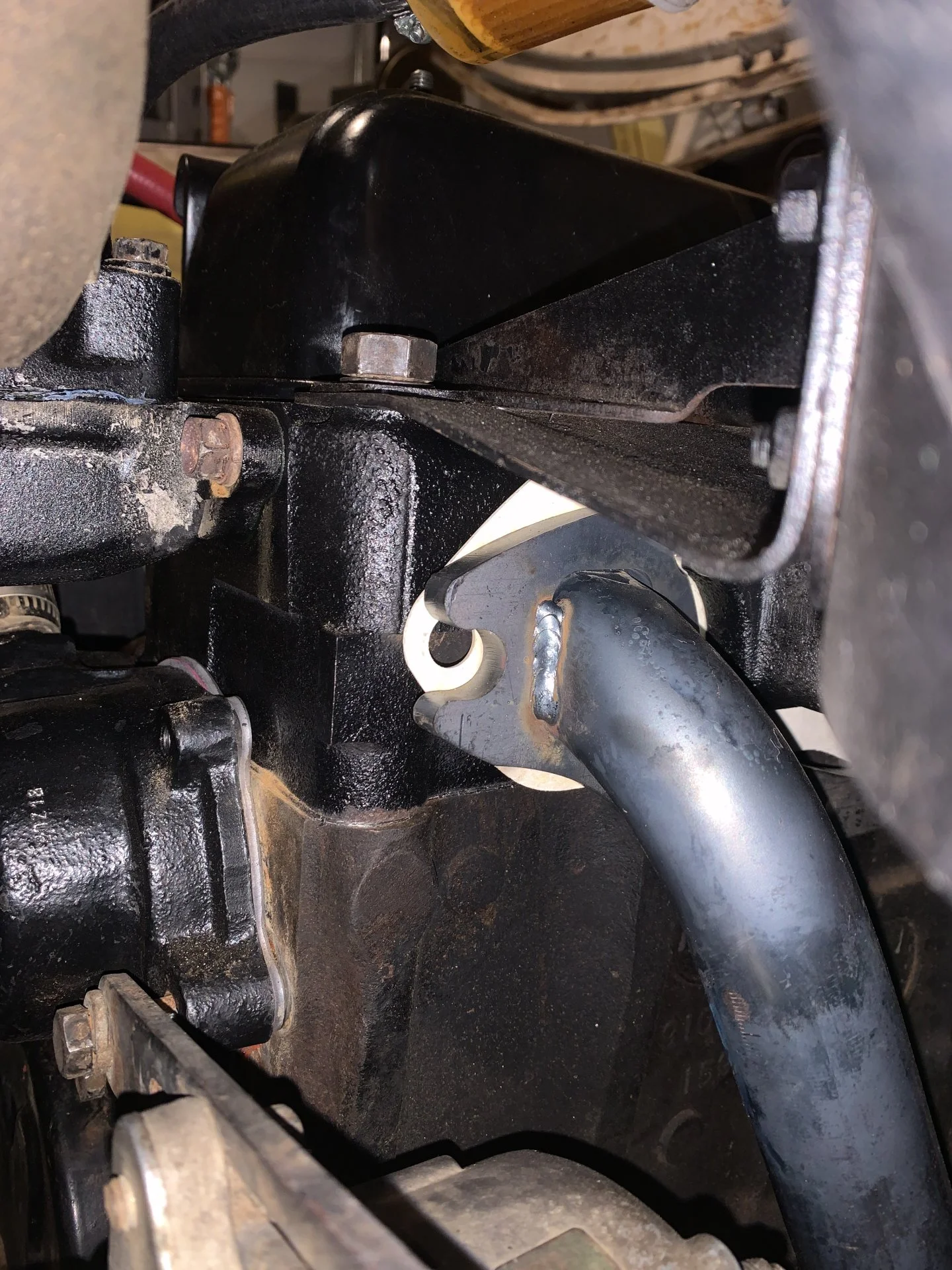

On mine, there is a hole in the gasket and it looks like there should be a stud through there, but there isn’t a hole drilled. Maybe this gasket and header are for f or 2f?
You need your own thread instead of hijacking skreddys build 😉
That gasket and header both look suspect.
F engine problem/design. No outboard stud/bolt hole for the very front of exhaust on an F or 1F. So essentially, every header and gasket made are for a 2F that has that hole. Also, the stud sizes are different between F and 2F so you need to take care to center the gasket and not rely on the studs or there’s a chance to get leaks.
