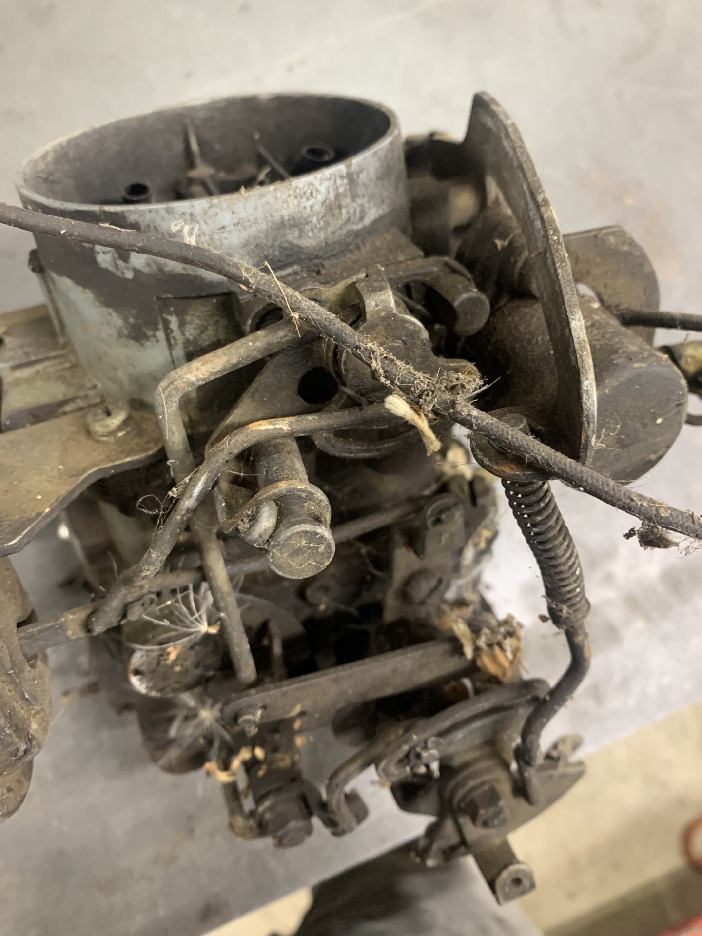

The rusty piggy I bought had a 1970 carb in a box of parts in the back so I rebuilt it today and went for a good, 60+ mile drive (I know because my Speedo is accurate and odometer works now). It runs way better than the one that came with the 40. Only issue I have is a stumble/bog from idle to get going or a pop out exhaust when shifting gears. Need to look into it more but when I give it throttle, it seems like the butterfly moves too early compared to the accelerator pump squirt. We will see. But the long drive is showing my engine leaks are gone, just the very slight one from tranny. But damn! That plastic 6 blade fan I put on is loud! Sounds like the engine is just screaming but it’s all fan noise.

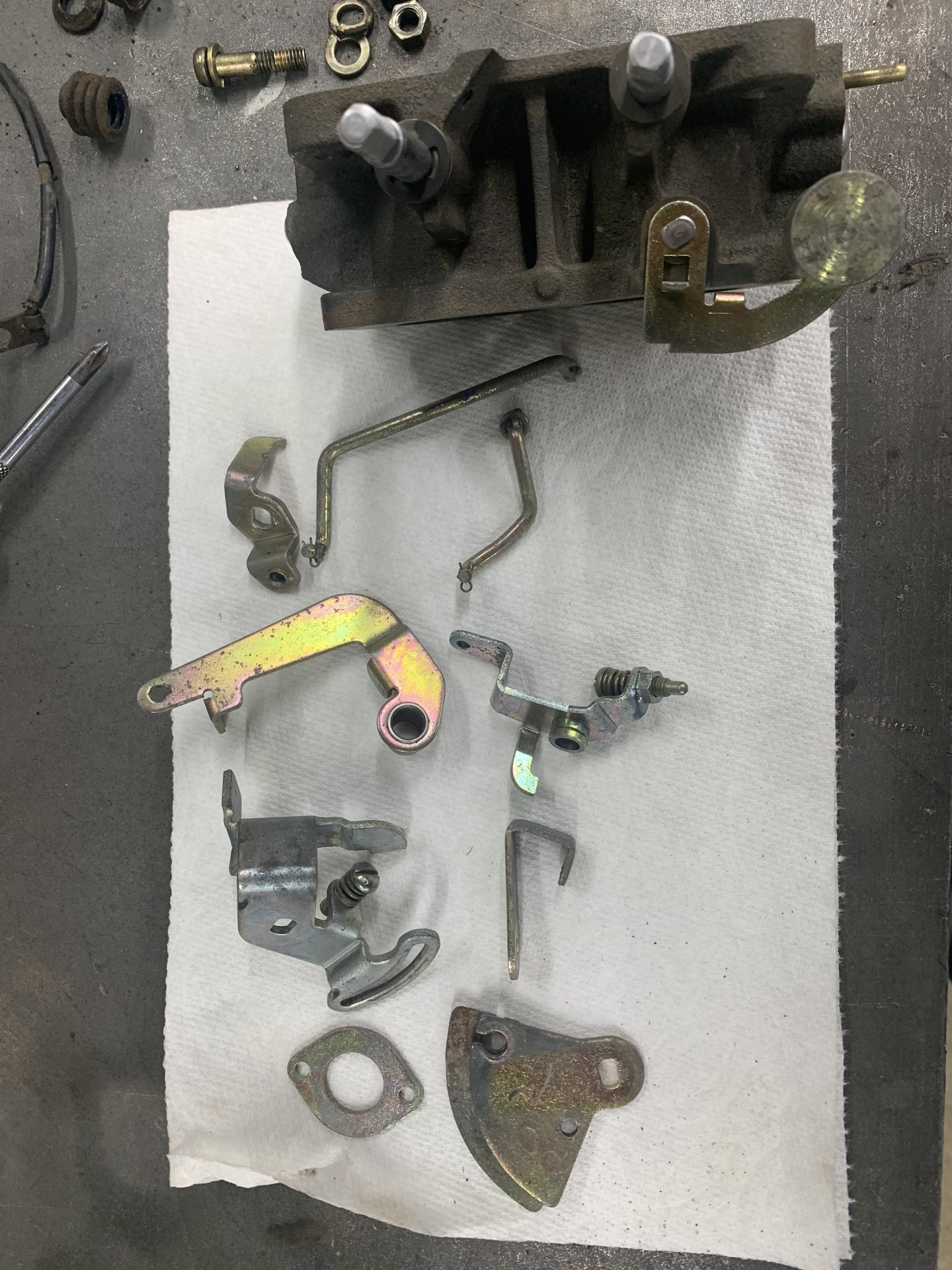

Pulled the carb apart and blew air through passages, ran fishing line through where I could. I poked a huge ball of what looked like fur out of the accelerator pump nozzle: much better stream now. I was excited and got it back together but still have the stumble off idle. It’s better, recovers quicker and doesn’t die but it’s still not right. I don’t believe it was doing this with the other carb I had on there that had the bad throttle blade shaft so I may try it again and see. If that one doesn’t do it, maybe I’ll switch the lower body between the carbs and see if that makes a difference. Tempted to try one of those $75 carbs I see on Amazon but not giving up yet.
Did you replace the pump plunger when you rebuilt the carb? The rubber ones in the keyster kits are pretty crappy. The leather ones give a much better burst of fuel. Did you try changing that main jet while you had it out? Maybe @FJ40Jim will chime in with ideas.
I did use the keyster plunger. While I had it apart, I filled the bowl with fuel, stuck my finger over the accel pump nozzle cavity and pushed down on both plungers. They seemed to squirt the same, but who knows. Did not replace the main jet yet. But it’s on the list.
