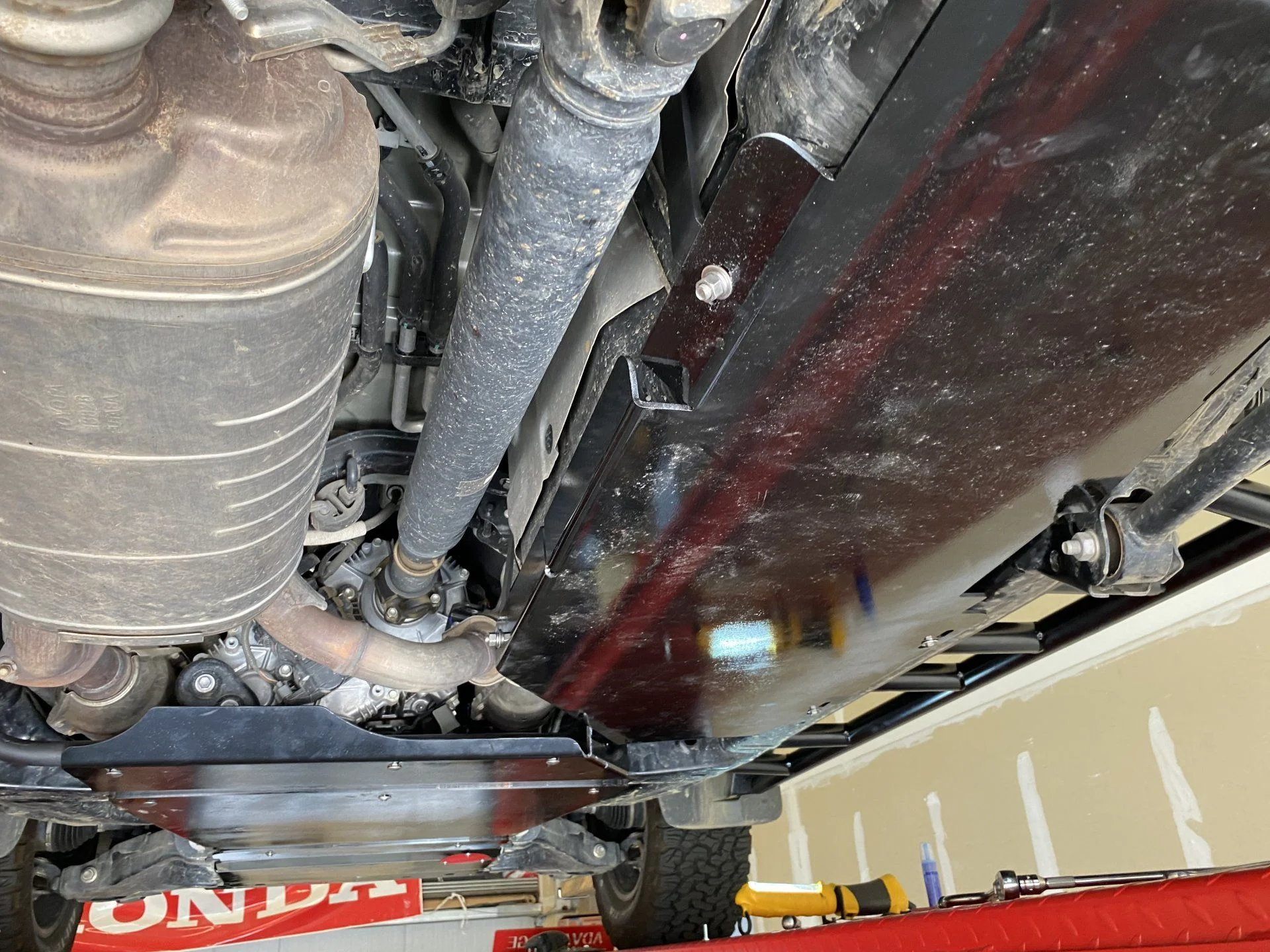

Thanks for all of the input. One more question that i emailed Budbuilt about, but figured I’d ask here as well, as it seems like a question others might have.
I’ve seen stage 4 mentioned several times throughout this thread, but only see stage 3 on the website. Does stage 4 still exist or did stage 3 become stage 4?
Stage four is adding the fuel skid.
Edit no, it isn’t.
Well ill wait for Budbuilt to confirm, but it looks like that’s in stage 3 now. Unless I’m looking at it wrong.
I don't see a stage 4 listed... I wonder if they changed their nomenclature. The annotation on at least one of the stage 2 pictures says stage 3.
I don't even think they still sell the three piece expedition one I bought without the transfer case skid. It'd be like a stage 1.5... :)
Metal tech 4x4 calls the budbuilt stage 4 what the budbuilt website calls stage 3 - adding the fuel skid as mentioned above.

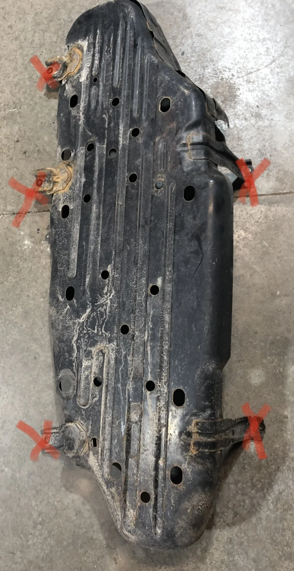

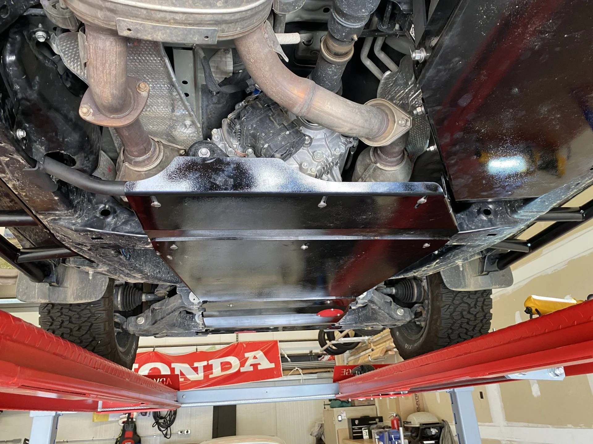

Install question. Can the factory fuel skid come out after the BB front, engine, transmission, and transfer case skids / cross member are installed? ... or is the crossmember/trans skid in the way?
The mounting points for the factory fuel skid are not obstructed by the Budbuilt transfer skid.
Thank you. Yeah I just wasn't sure if the transfer skid complicated removal. I removed the factory fuel skid when I did my sliders. It came out a little wonky if I recall.
I believe there are three bolts along the frame rail (two in the underside of the frame rail itself and a third in a bracket on the frame toward the rear tire), then the two that mount to “straps” on the inboard side.
I seem to recall the fiddly part for me may have been getting the straps around the driveshaft area? I don’t recall exactly - I have an aftermarket aluminum skid now.
