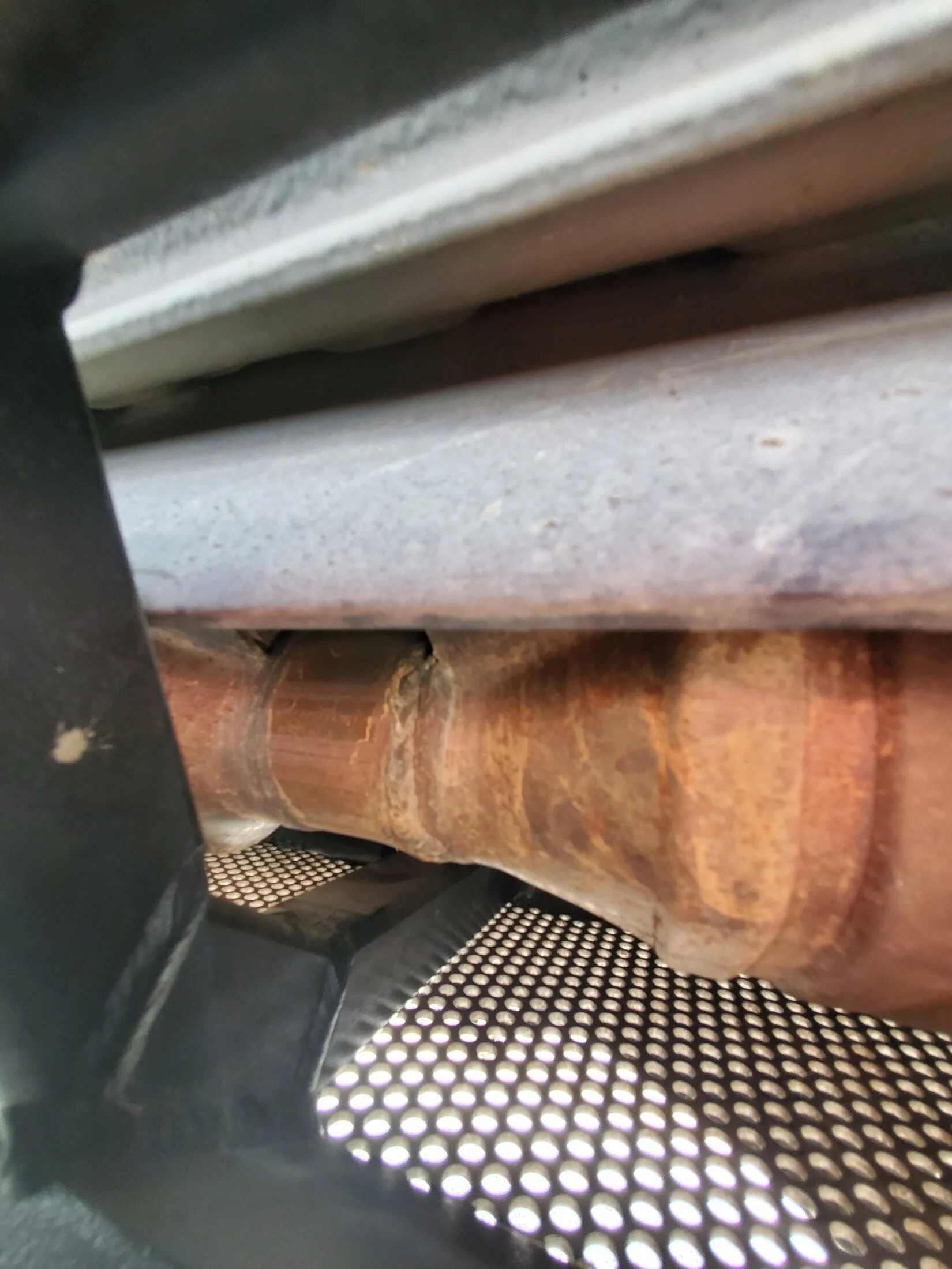

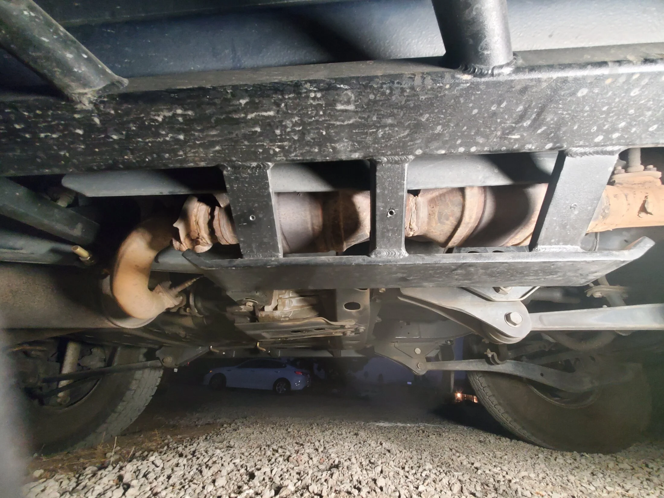

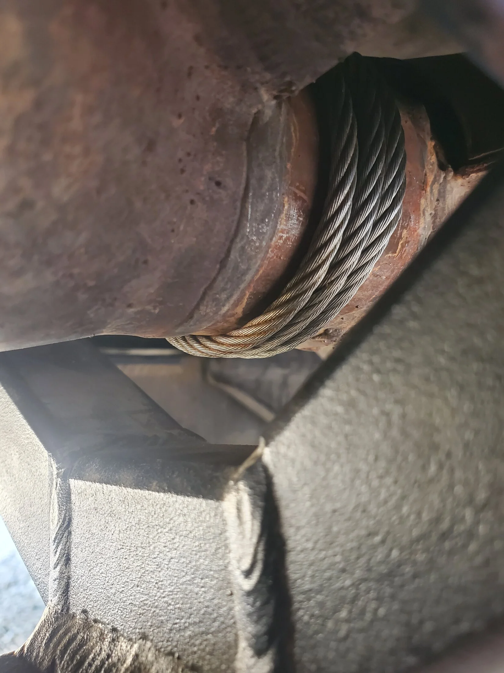

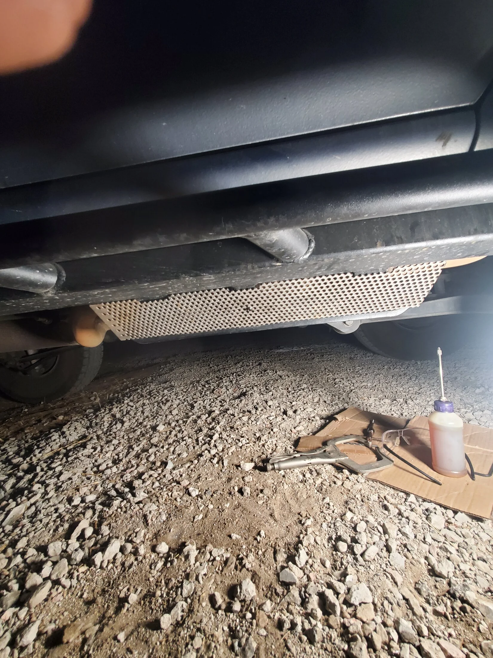

I posted these on a different thread but I added perforated steel to my white knuckle sliders, I also wrapped wire rope around the center of the cats so if they are cut they won't be able to be slid out.
