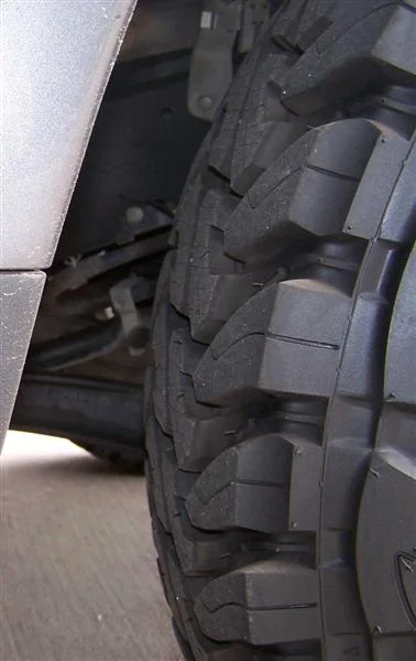

Can you post pics of how you had them siped. I have a relatively new set of Toyo Open Country MTs and they were factory siped. It would be interesting to see where you have the extra siping.

Hope these help - I didn't have any pictures of just the tires so I had to crop some photos to get these. And the 800x800 limit for MUD pics doesn't lend itself to great clarity.
You can see how the inner and outer lugs "overlap" and why if you have the tires siped that you will either have to live with not having the inner lugs completely siped or accept some siping on the outer lugs. Also helps to show how important it is that you are CLEAR to whoever does the siping on exactly what you want. My LX is 90% road, 10% offroad so having the inner lugs completely siped was more important to me than concern about chucking of the outer lugs.

That will do nicely, thanks. That looks like the same style siping machine that was used on my old MTs.
