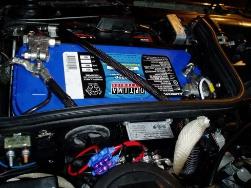

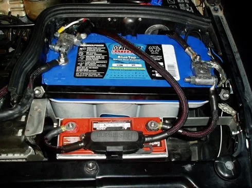

Here is another dual battery install.......
This is a little different due to the cramming them both in one tray.
I went this way because I didnt think I needed a full size # 2 battery.
I was just looking for something to start with if I managed to kill the main.
Main players:
Optima D31M
Odyssey 680 MJ
Hellroaring BIC
Custom mount for the Odyssey.
So far so good , I do need to tidy up a bit and secure some of the wire.

(gizmo):
The mount is an aluminum tray that is made for the 680 and some fabbed 6061 1"x1/8" angle and 6061 1-1/2"x1/8" flat bar to attach to the vechicle.
The #2 tray sits on the oem tray for full support but for full security is attached to the 2 bolts on the top rad support and one bolt (threaded hole) on the driver front 1/4 panel.
The cables are locally available marine cable with marine tinned crimp connectors.
For the svelt "cool guy" look its covered with 1/2" "Clean Cut" PET anti fray sleeving. available @ good electronics stores or McMaster #2837K32
The ends of the cable on top of the sleeving is heat shrunk ?? word?

You have done an excellent job with the wiring. I need to get some wire braid and replace the main battery body ground as you have. Neat.
Be sure to use some good battery terminal covers. I would like to see what you come up with on those. My dual battery setup uses the military terminals with covers donated by a generous 'Mud member. Karma all around.
Are you planning to secure that big Bussman fuse?
Like TrickyT, I am a fan of having all loads to a single battery and having a fresh, unloaded battery in reserve. This is an excellent way to do that and keep everything in the stock location. That deep cycle Optima is HUGE.

The Bussman fuse is was kind of an issue , I wanted to mount it on the tray but its Maxed out on space. so right now its held down with HD velcro and the 4 ga wire. The plan is to leave it that way , it is working well as of now.
Yes the Optima is defnitly huge , I really dont think I will be able to kill it.

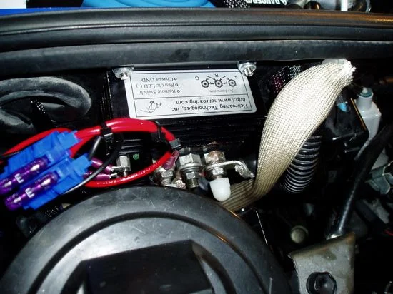

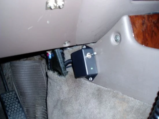

Can you post a wiring diagram? What is the small black box with the switch for?
This page as a basic drawing : http://www.hellroaring.com/4wheel.php
The black box is the "remote module" this switch allows you to change the battery config in cab.
Its a 3 position switch
1- combine (winching)
2- auto normal charge and isolation
3- off , total sepration
