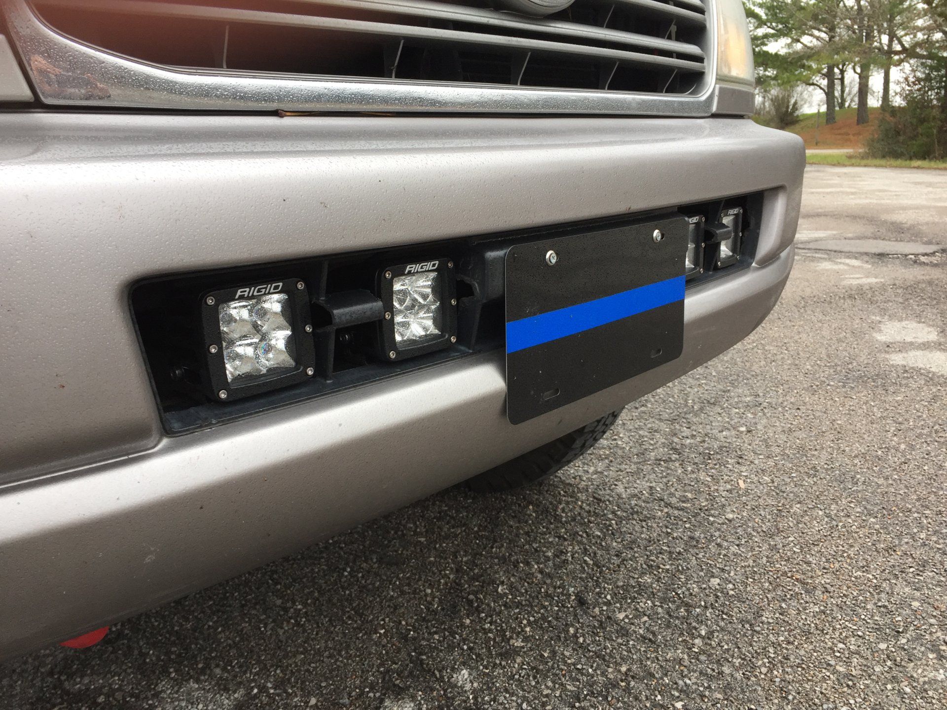

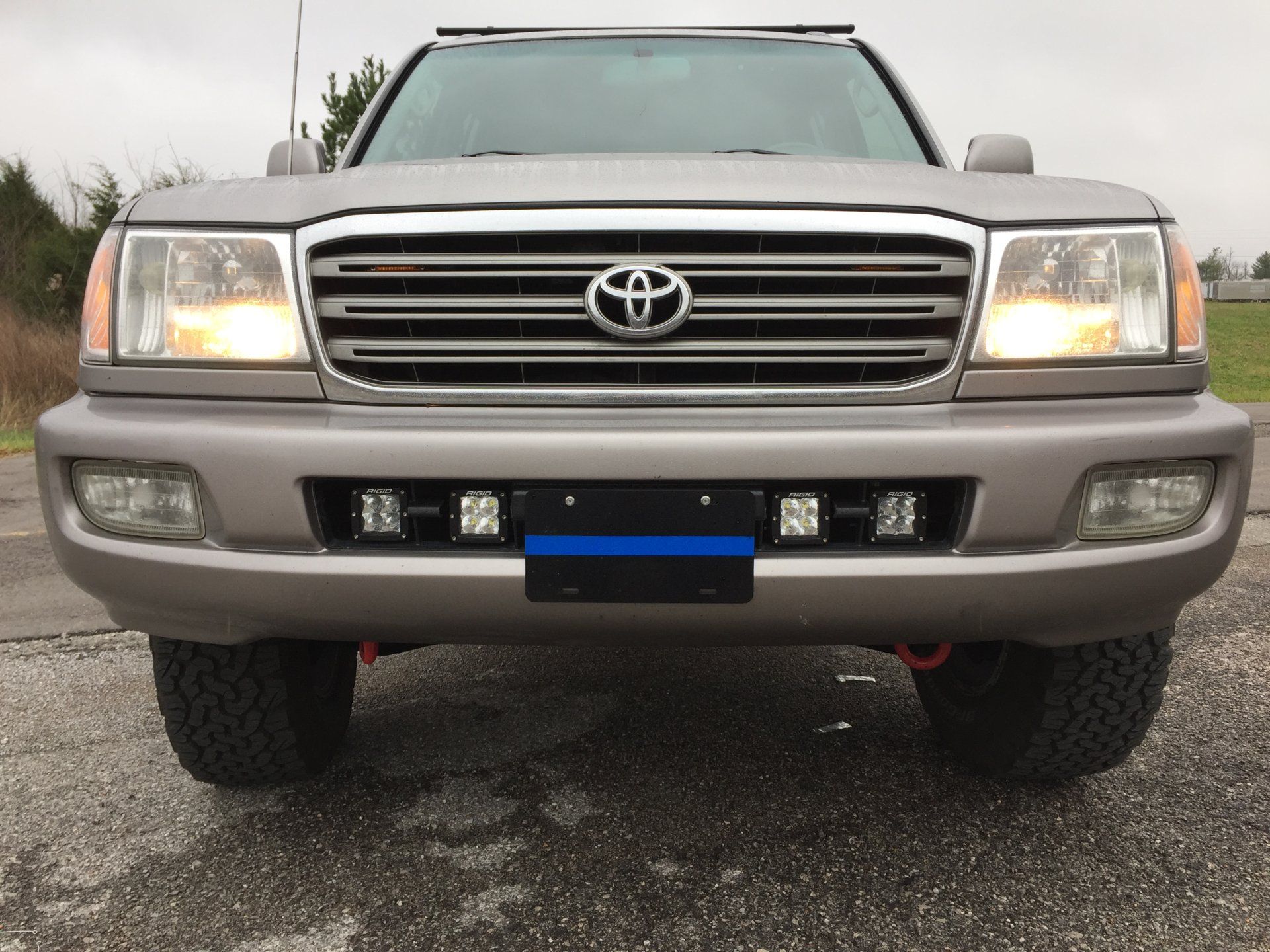

I just got Rigid Dullie 3x2 cubes to install this weekend. I live closer to the ocean so moisture is always in the air. Extra peace of mind w/ the lifetime warranty if they ever fog up plus comes with a nice wiring kit. Seemed like a good deal at half off normal prices from other vendors. I'll post pics once they are mounted.. I have a 2001
