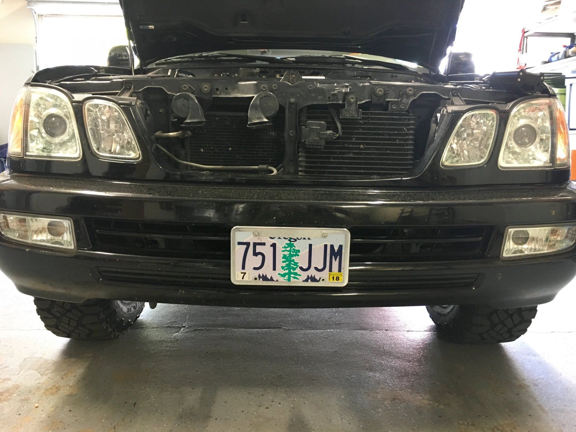

Any chance you could do a write-up? I'd love to read/see how you went about the installation process. No worries if you don't want to, just thought I'd ask. Regardless, your end result looks awesome.
Here is a quick photo wire up of the light install. Pretty easy overall!! I purchased a pre built wiring harness from amazon as well which make things super easy for the install! I also removed my drivers side headlamp to fix a cracked support. Its not needed in the light install...
Open the hood and locate the parts that are needed to be removed with the bumper cover. Its super straight froward. Just start taking the trim pieces off.
I removed the trim pieces around each head lamp.
Removed the bumper cover with 6 bolts from underneath (1 bold in each wheel well).
I then cut out each grill piece. I used a multi tool then cleaned it up with a knife. jigsaw or any small saw would work.
I took some measurements and some dry fitting then drilled two holes for the mounting hardware. I used a long drill but and 5" bolts.
Here is the second light mounted.
Then I did some quick wiring to make sure they turned on.
Installed the bumper cover and the trim pieces.
All done.
