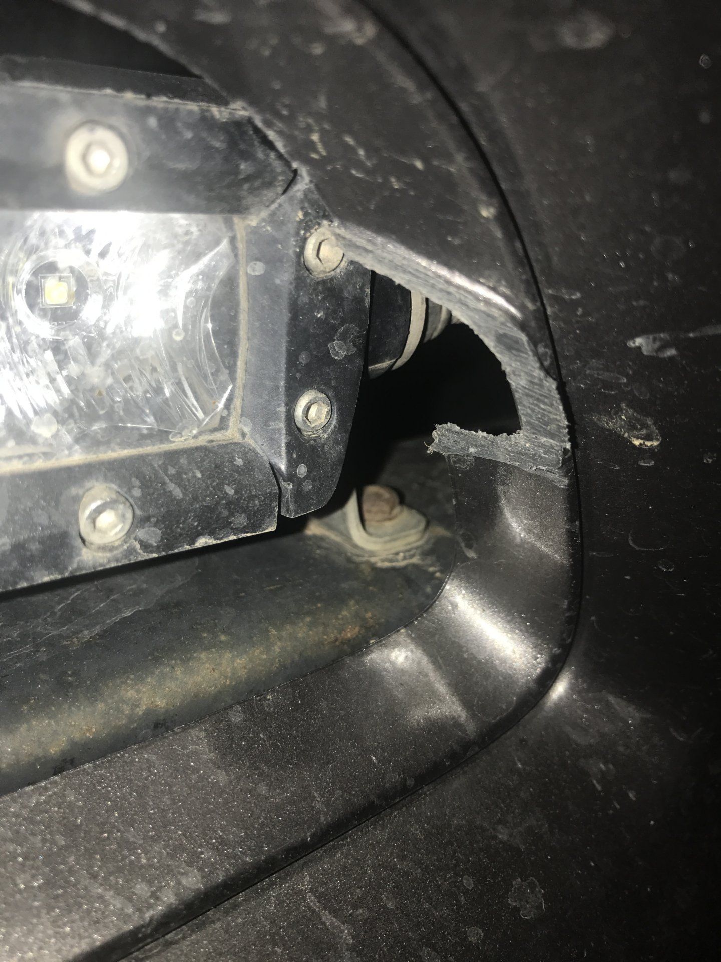

Here is a quick photo wire up of the light install. Pretty easy overall!! I purchased a pre built wiring harness from amazon as well which make things super easy for the install! I also removed my drivers side headlamp to fix a cracked support. Its not needed in the light install...
Open the hood and locate the parts that are needed to be removed with the bumper cover. Its super straight froward. Just start taking the trim pieces off.
I removed the trim pieces around each head lamp.
Removed the bumper cover with 6 bolts from underneath (1 bold in each wheel well).
I then cut out each grill piece. I used a multi tool then cleaned it up with a knife. jigsaw or any small saw would work.
I took some measurements and some dry fitting then drilled two holes for the mounting hardware. I used a long drill but and 5" bolts.
Here is the second light mounted.
Then I did some quick wiring to make sure they turned on.
Installed the bumper cover and the trim pieces.
All done.

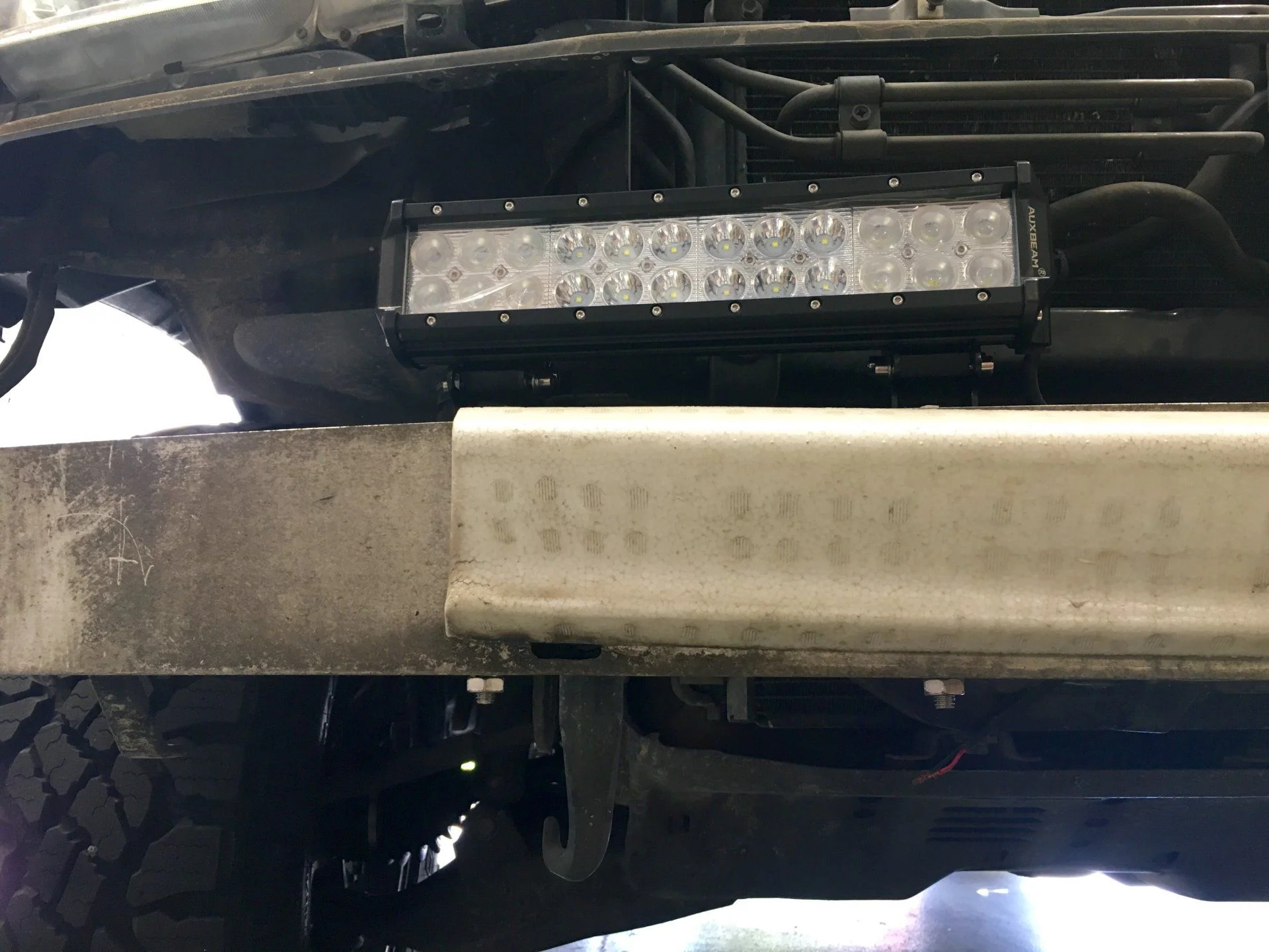

What about mounting one under the bumper? There are some bolts that hold the bumper on that could be used to hold a light bar. I'd probably only want a single row...You would need to make your own brackets, but that's not hard. I also know it would be more exposed to the elements being down there, but I could silicone the crap out of all the seals....
I am just wondering how the light pattern is for these bars if I would be losing a lot of output having it this low.

Assuming most people offroad their vehicles here to some degree, mounting an expensive light under the bumper is not gonna work. Unless you’re ok with losing your lights to a rock.
