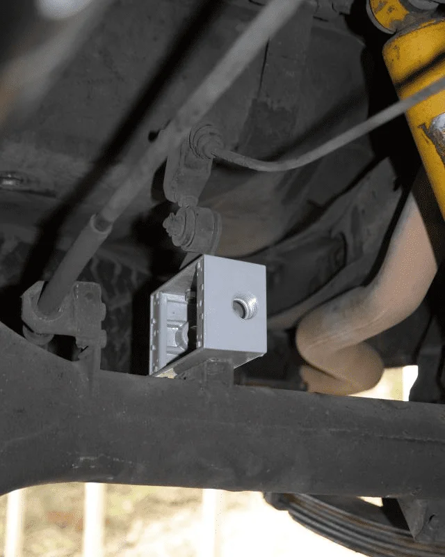

I managed to remove and then Aric got me put back together again with new pins and springs. I'm about to finish up adjusting the rear brakes which have always been s***ty. Gotta do some reading and take a close look at the LSPV to maximize the rears. Right now driving around with only the fronts doesn't feel much worse than with all 4 so something is not in it's optimal configuration. ;) Looks like a spacer bracket for the LSPV in in order....??

Im an advocate of just eliminating the lspv.
Ime theyre nothing but trouble and only really sounds good in theory.
Tying the rod all the way up "should" get you full rear brake power.
Yup common fix/solution if desired on the 80 series as well. If the bracket is jammed/seized most will just chop off and tie up higher..... or go through the whole delete process with just a T. That is my rough understanding from what I have read.
Yaa....I just disconnected the rod(spring) and tied it up for now. Will now get busy adjusting etc. and see how it ends up. I have never been able to get those brakes to work well....the few "panic....Oh s***" moments have been scary. I'm lucky I have not plowed into anyone.
