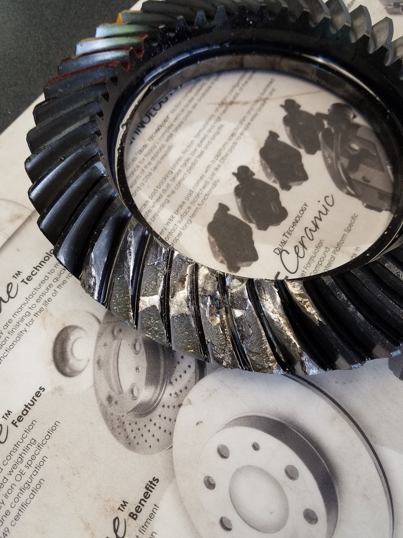

Fast forward to Memorial Day Weekend and a group of friends and I were going to camp and wheel for the weekend. Since my 40 has become the never ending project, I figured I would wheel the LX. Three minutes onto my first trail, I stripped the ring gear in my front end.
To be 100% honest, this was completely user error. I was climbing a hill and my rear tire was trying to climb an undercut root. Instead of backing up a little and bumping it up and over, I was trying to use ATRAC to pull me up. I was using quite a bit of throttle when the front end caught traction and stripped the gears. I know better, but I’m also used to wheeling fully built rigs.

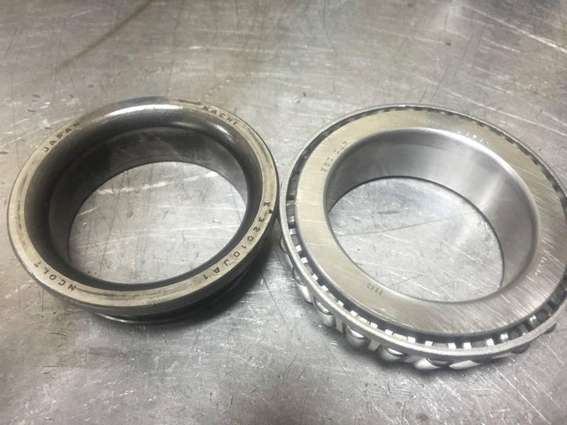

Two days into the work, I get the first dreaded phone call. It seems the rear carrier bearings that were included in the master install kit were incorrect. The carrier has a radius where the bearing goes and the bearings included didn’t.
This shows the carrier:
Here are the bearings. The one on the left is factory and the one on the right is what was provided.
Furthermore, the stock front pinion flange isn’t going to work with the new gear set and there was only a rear pinion flange provided. I made a call to JustDifferentials to let them know what was going on. After some detailed conversations with Drew in Customer Service (who was awesome) and Carl himself (who is also awesome), I had a new front flange being overnighted to the shop. This was a complete miscommunication when I originally made the order and JustDifferentials thought that my LX was a 2004, which has a different pinion flange than mine. They bent over backwards to make sure to correct this situation with the least amount of difficulty to me.
As for the bearing, things were a little bit complicated. According to JustDifferentials, they have never ran into this problem on the 100’s of gear installs they have performed and that was the only bearing they had. I had the choice of milling out the carrier so the new bearing fit or buying the bearings directly from Toyota. There was no way I was going to mill the carrier and weaken it, so I bit the bullet and ordered them from Toyota ($$$). My guess is the carrier changed at some point. Or maybe the ARB’s don’t have that radius and everyone is doing lockers at the same time. Or maybe they are putting the other bearing in and adjusting for it. I have no idea, but I wanted to make sure they were perfect.
