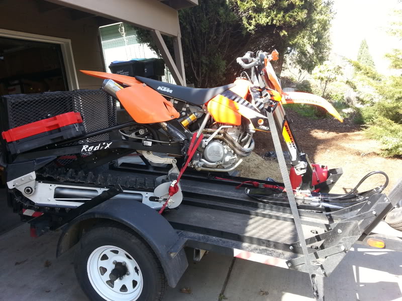

Had a customer pulling out if his driveway with this contraption today. Looks bitchin! He said it didn't do well on hard packed snow but you could carve to the handle bars on powder!
