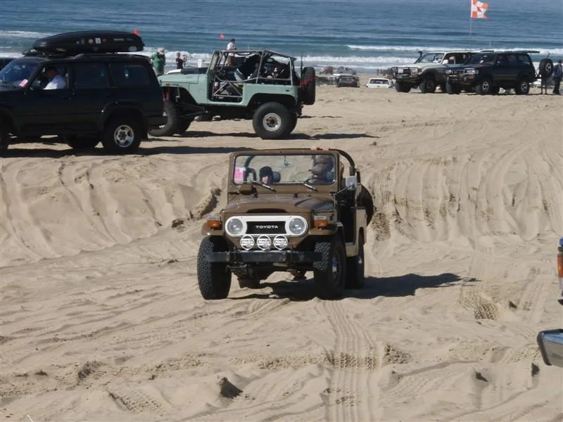

If you guys could post pictures of your FJ40 33x9.5 or 30x9.5 tires with no lift (They dont have to be BFG MT) it would be much appreciated. 9.5 is a must, I have already seen the thousands of threads with the 10-12.5s on them.

I have Con-Ferr shackles, but no lift.
