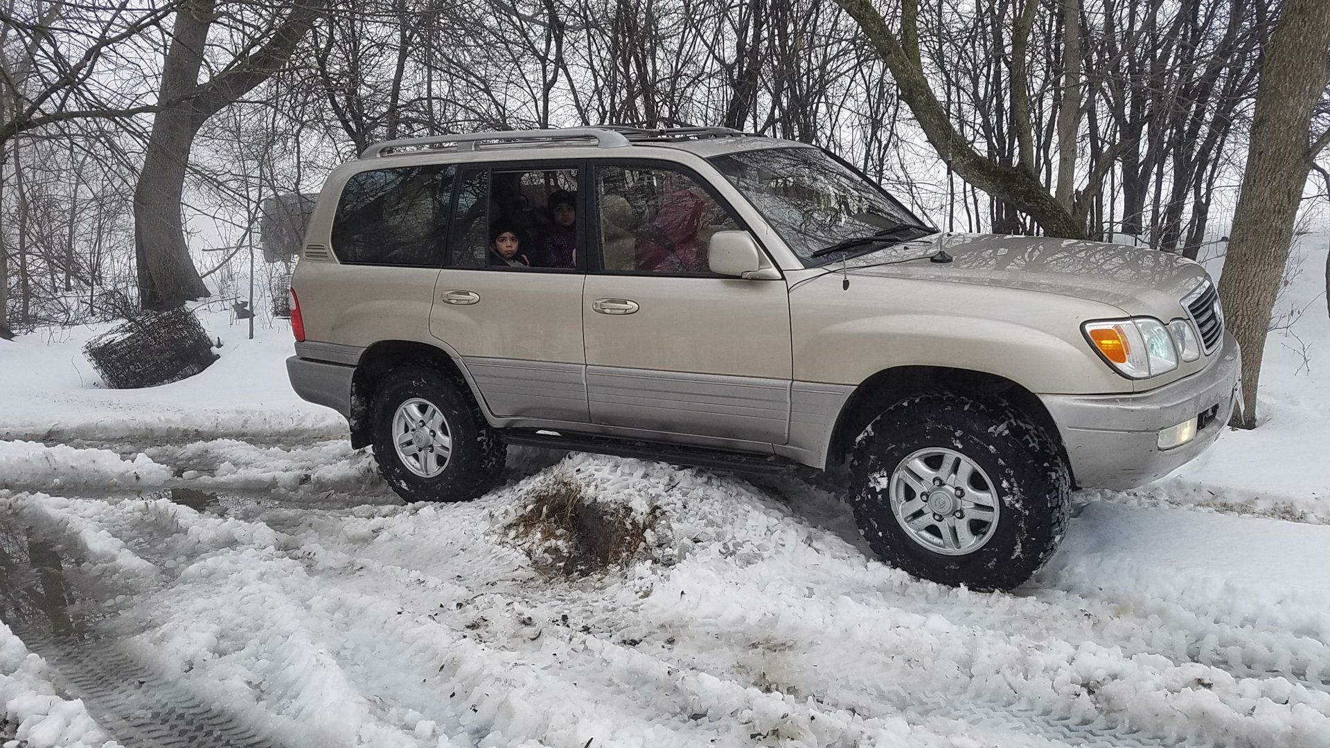

Nice LX.
Do you know if the Limited Slip in your rear axle is still working? All (U.S.) LX470 (years 98-99) came standard with L/S.
Mine still functions...but it takes some pretty aggressive throttle input and a slippery surface to get enough tire spin for it to kick in (where I can tell).
