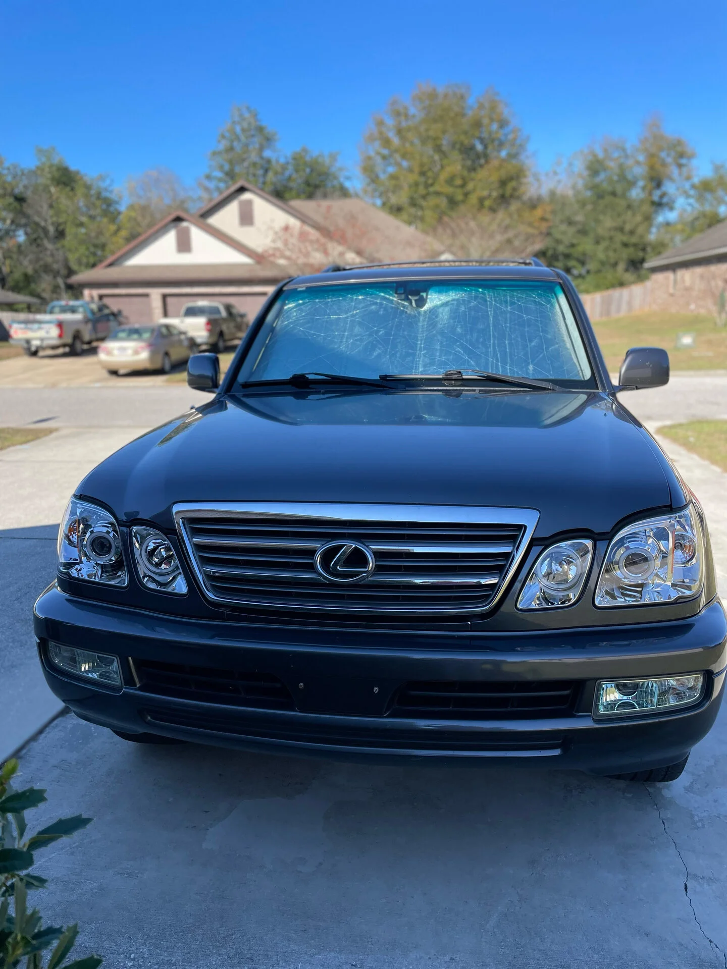

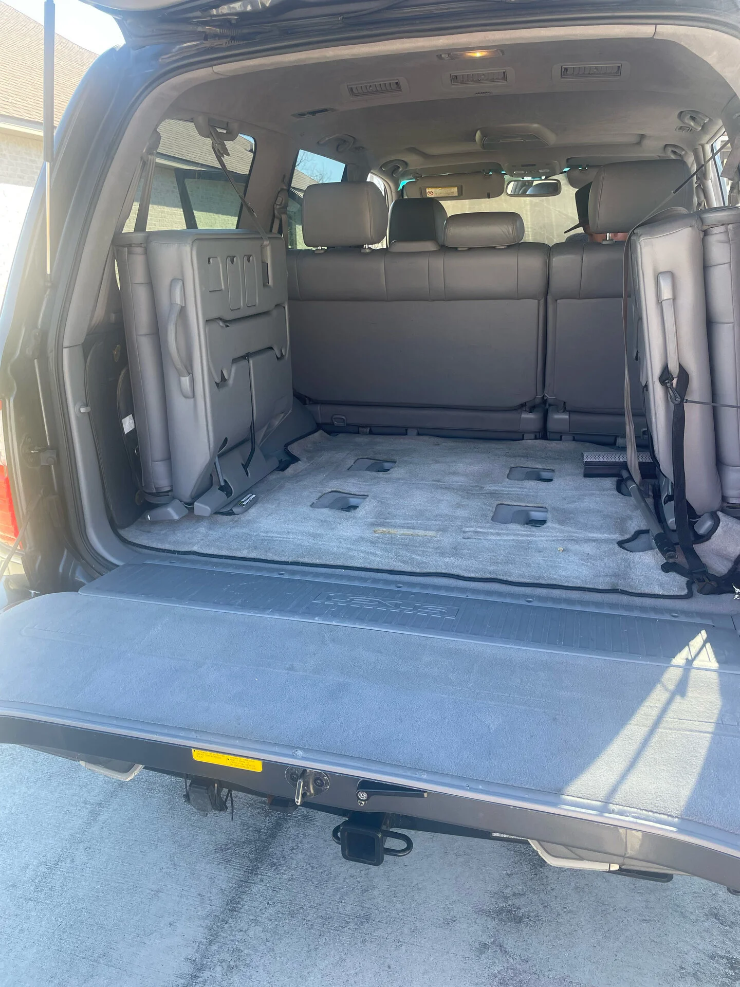

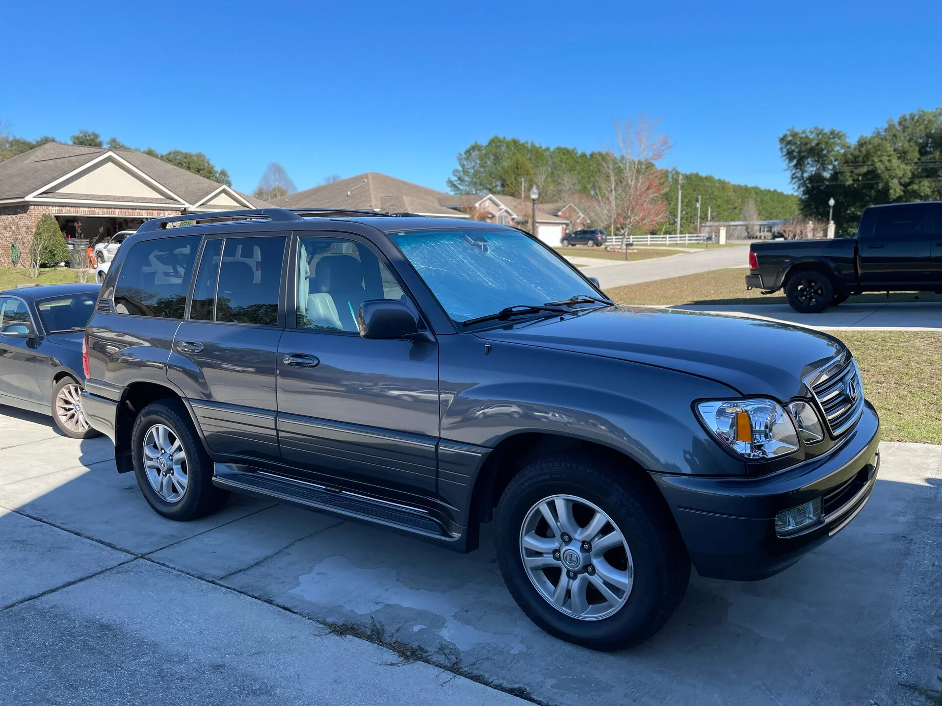

I'm going to look at a 05 LX470 on Saturday for $8900. I'm going to follow the OTRAMM pre-purchase inspection when I go to look at it. I'm taking a buddy of mine who is a mechanic as well. Is there anything else specific that I should be looking out for that isn't mentioned in the OTRAMM video? It's 276K miles but the owner says they are majority highway miles. 1 owner as well and meticulously taken care of. Southern vehicle so no rust according to owner, but I will still be checking. This vehicle is for my wife (for now) so I want to make sure I get it right. I appreciate the help!

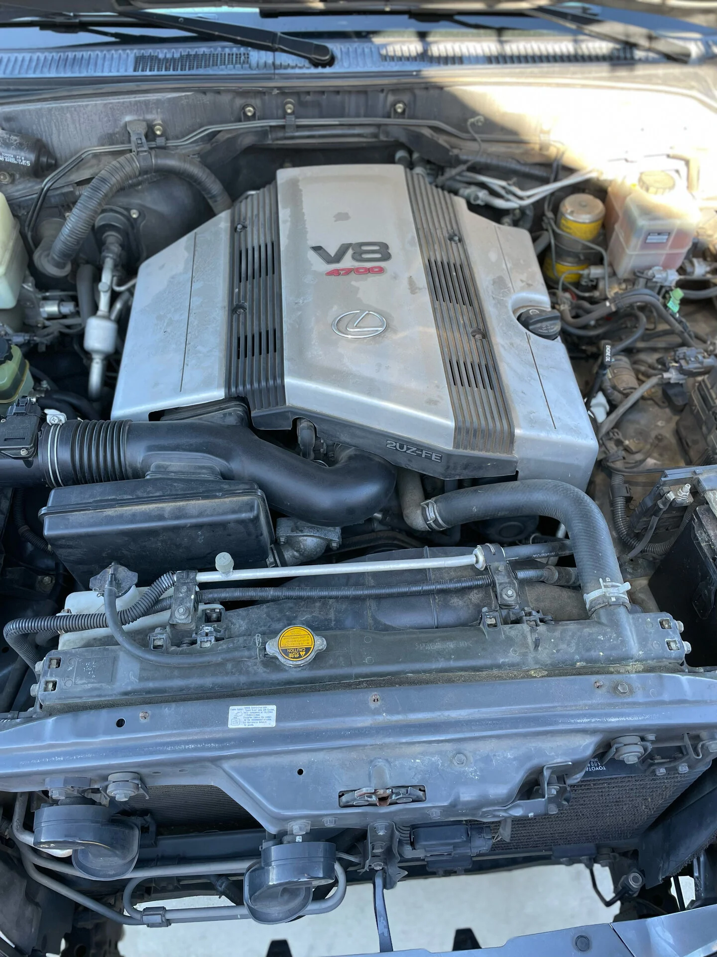

No timing belt sticker seen in the picture. How are the brakes, tires. What about the AHC suspension, is it functioning normally. Is the fluid clean? How about brake fluid? Heater tees? The list goes on and on and on and some with higher costs to fix / maintain then others.

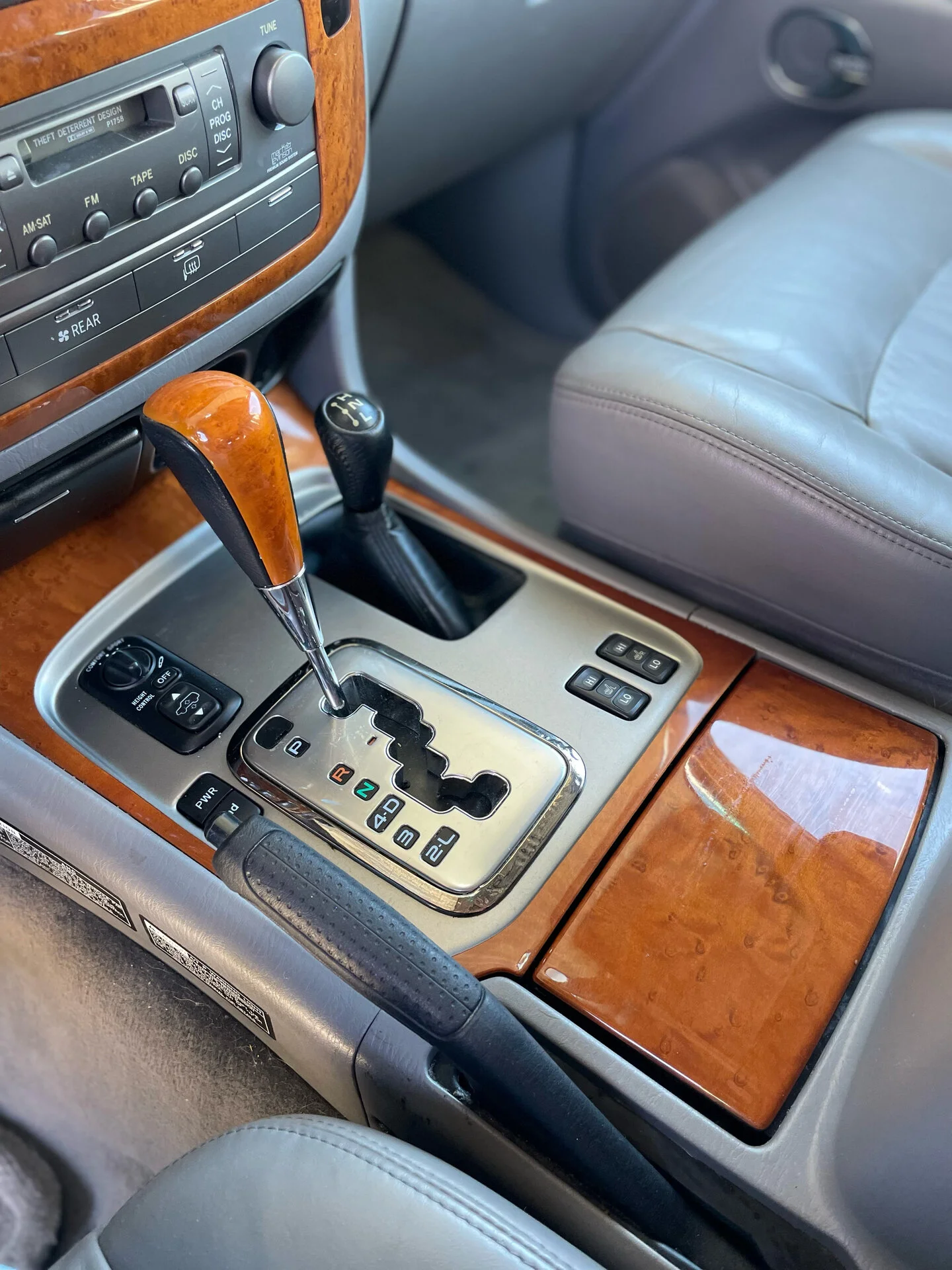

  • Does it "clunk" Shifting out of park into drive should be smooth as butter. How about when coasting and then you left off the gas, and get back on, does it "clunk"
  • Shift into 4Low and back out a few times. Remember you need to be in neutral, on flat ground, with foot on brake. Without any pressure on drivetrain it should be smooth
  • While your at it , lock the center diff up. This might clunk a little bit, meh that's probably fine but it should engage and disengage fairly quickly. You can be rolling slowly or stopped for this, rolling probably would help .
  • General condition under the hood. Looks clean in your picture. Radiator may be original, sort of fading color a bit on the tank but not too bad

I don't like buying rigs with trailer hitches but hopefully it wasn't worked too hard. Does the LX470 have a dipstick? I don't know, but if it does add that to the list : Pull transmission fluid dipstick and wipe with clean rag. See if it's burnt.

Yeah I’ll ask him about how often they used that hitch. And based off the pictures, it doesn’t seem to have one but I can confirm on Saturday
