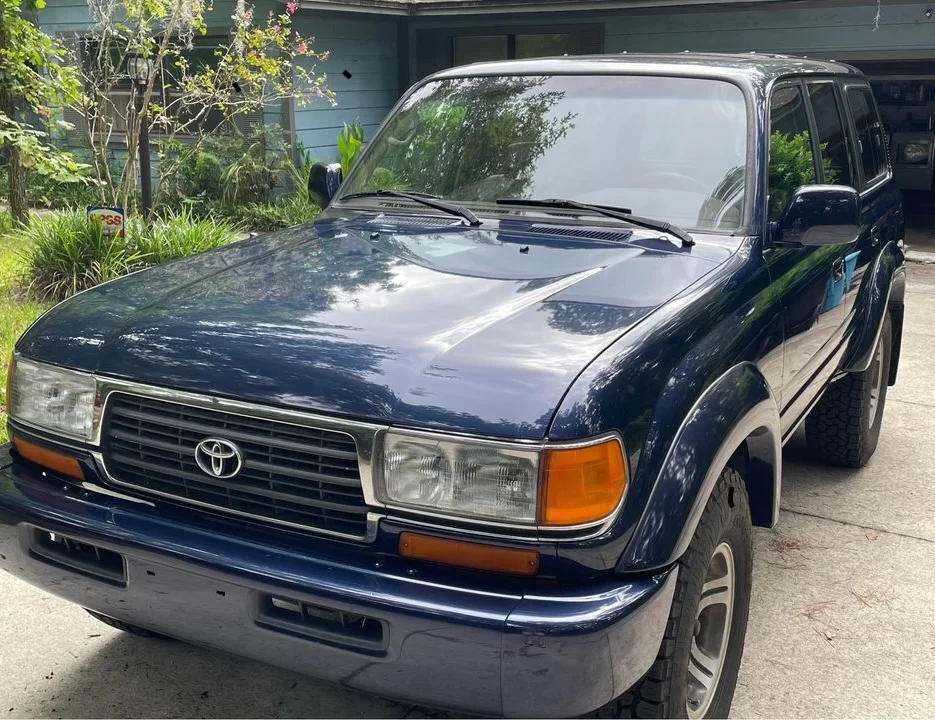

Hi, apologies if this is a 'noob' question. New here! I've done some research and I know these 80-series hold their value, but I was wondering if anyone had some more insight if this is a good deal or not.
Current owner only drove a few thousand miles. Carfax reads 5 owners and 25+ service records. 240k miles. Center lockers only. Fresh paint job, basically no rust and it seems to be mechanically fine. Only the interior needs to be redone/carpets reupholstered.
Some other notable mentions:
- New Brake Booster
- New Radiator
- Power Steering Replaced
They are asking $19k but I shaved it down to $14k. Would you say this is a good deal?

See if you can have a fellow Mudder with some experience look it over for common issues; could be free, could be fee but worth it if they know what they're doing. Also have a shop WITH 80 EXPERIENCE do a pre-sale inspection. Do NOT do this at the place the current owner takes the truck to, just in case. Maybe any issues have already been dealt with--hoses and bushings that age out, seals that start leaking after 30 years, stuff like that. (When I bought mine, the hoses still had the factory cotter pins from 25 years before--which tells you how long this stuff lasts.) Check for any sign of a head gasket leak, main seal leak, rust around rack mounting points on the roof, pesky heater hose etc. Some things are more trouble than others to fix. Slee has a checklist somewhere on their site, and you can find various checklists/baselining lists here on Mud. Call me cynical, but if it's freshly painted, check for bodywork/filler. A cloth-covered magnet (to protect the finish) won't stick to filler. Looks pretty damned good!
P.S. -- I bought a spare engine to tear down and rebuild, just because I want a like-new engine and I don't want to guess when the next issue (might) pop up. The engine has 170,000 miles on it. Head gasket was on its way out, but other than that and a few much smaller, external issues--this engine DID NOT need to be taken apart and rebuilt. Not even close. It all depends on how it was treated. :) At some point, I'll look at rebuilding the 250k engine the 'new' one replaces.
How long ago was the paint/body done and who did it?
Nearly no rust might be concerning if it's been painted recently, depending on what this means.
Why was the radiator replaced? The 1FZ-FE engine is more prone to Head Gasket issues than some other engines, and if it's been running hot this may need attention or the radiator replacement may be an incorrect diagnosis.
What does 'power steering replaced' mean?
What brand is the new brake booster?
Who has done the recent repairs?
Sorry to be asking what might seem like obvious or unnecessary questions, however the best part of 15 years playing with and working on Land Cruisers has taught me a few things:
1) Most people don't replace parts for no reason, and a lot of mechanics these days are parts replacers rather than taking the time to diagnose issues properly.
2) Genuine parts are in 99% of cases, better than anything aftermarket and worth the extra cost.
3) People's definitions of the same thing can vary wildly. New power steering could mean something different to me than the person who did the work and I would strongly suggest the steering system isn't new. Most of it is available so not impossible but not a cheap exercise.

There’s a LOT of wiggle room (and $$) in those statements. Need to be as sure as possible. Comfortable so far saying $14k isn’t a “good” deal based on the mileage and description so far. But it could be a fair deal…

I would say planning to buy a vehicle, and do an engine rebuild is likely excessive depending on how its been cared for.
But, probably realistic to think if you plan to own it long term, an engine rebuild or replacement may be needed. It's a 27 year old vehicle after all.
It's not necessary to pull the engine out to change the rubber seals, hoses etc.
There a very small number of seals that require engine removal to replace.
I personally don't consider pulling the engine out to replace hoses as the easier option, and I've pulled a few out. YMMV
One more piece of advice, IH8MUD has a large number of MUD-OCD afflicted members ( is a thing) who will tell you you need to replace every nut, bolt, seal, hose, clip etc immediately just in case you looks at something sideways and your head gasket blows out of sympathy.
There's two ways ( or more) you can approach care of these.
Go MUD-OCD nuts, and baseline the whole thing straight away with a new OEM parts cannon.
Prepare to sink a lot of time and $10k, double or more if you do the engine. And have it out of action for a chunk of time.
Or,
Change all fluids, check the brakes. Check over and refresh the cooling system. Thoroughly inspect as much as possible.
Assess and prioritise common maintenance and items as they come up, and plan ahead on baselining mission critical stuff.
And drive it as is intended and enjoy it.
