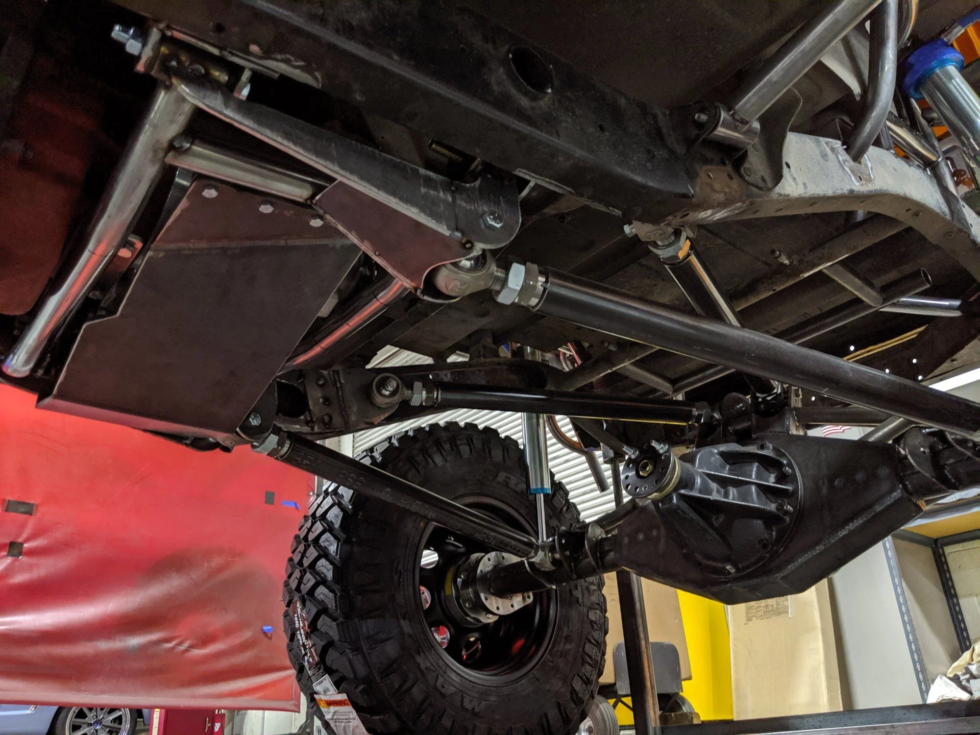

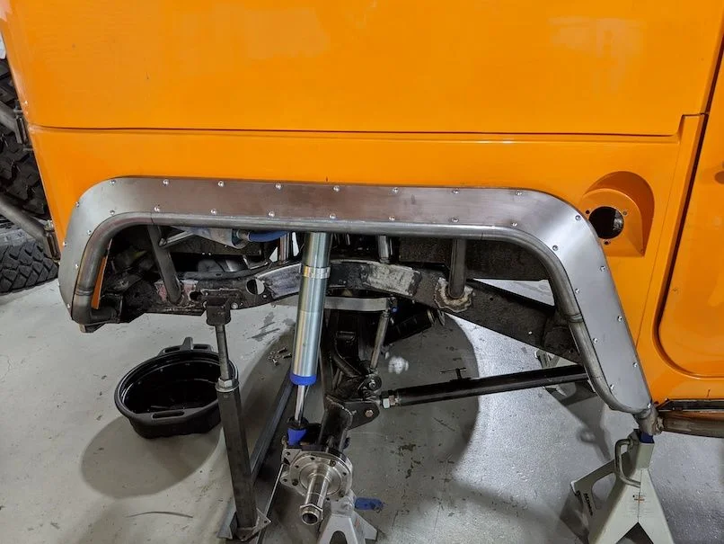

Newbie here, and someone suggested I re-post this in this section... I'm building a linked 40, and trying to decide between KING, FOX or ORI shocks/struts. The ORI site states that you don't need swaybars or bump stops. The truck will be driven on the freeway and the rocks running 37"s. Looking for real user feedback. Fox 2.5" DSC 16", ORI stx 16", king 16". Thanks
1 vote for oris, but I have no first hand experience. They seem to really simplify things especially negating the need for sway bars/antirocks. I have heard they can fatigue for on road driving, but my friend has taken his LJ with oris on a 1000 mile road trip with no complaints.
I would vote Fox.

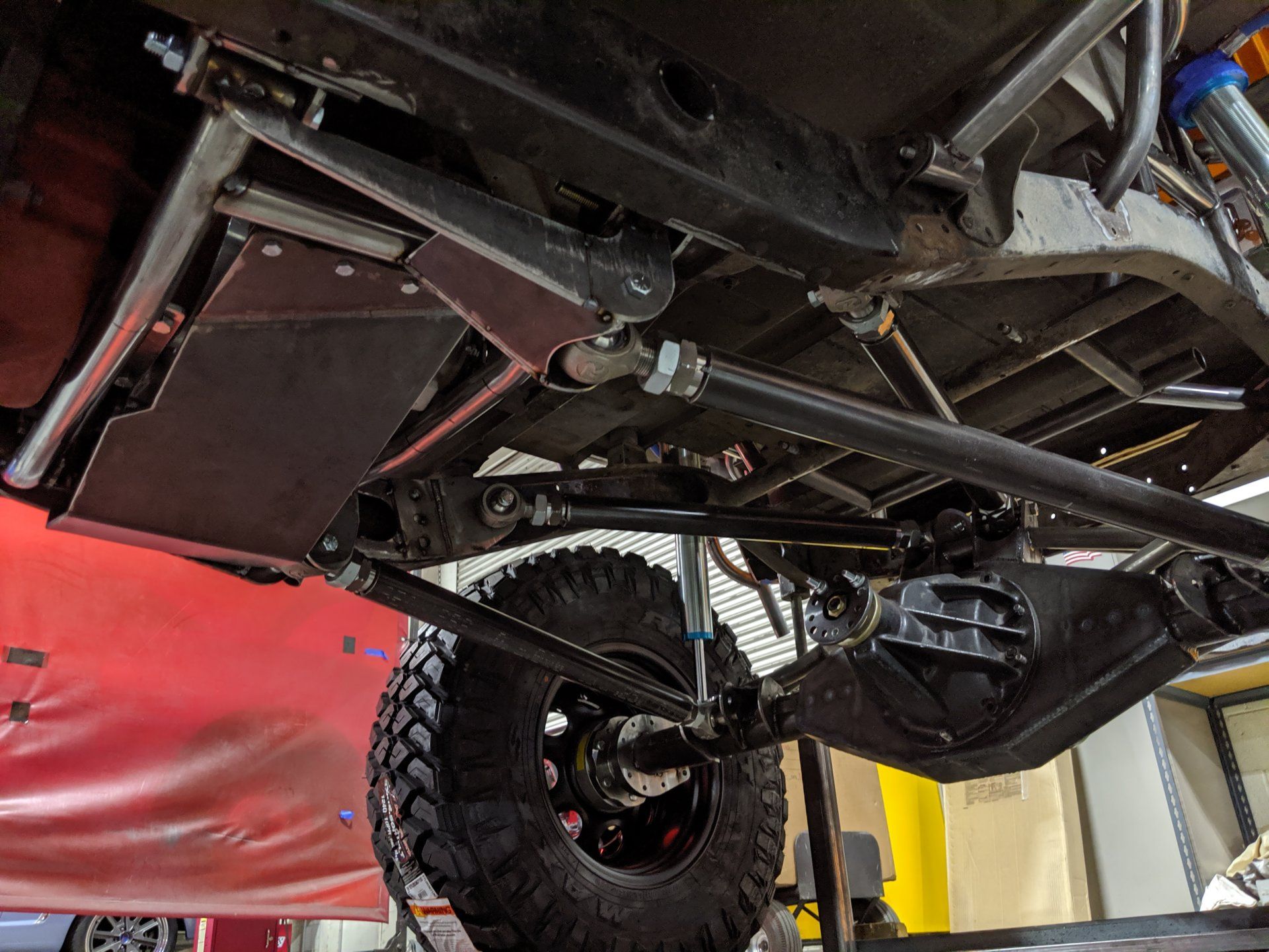

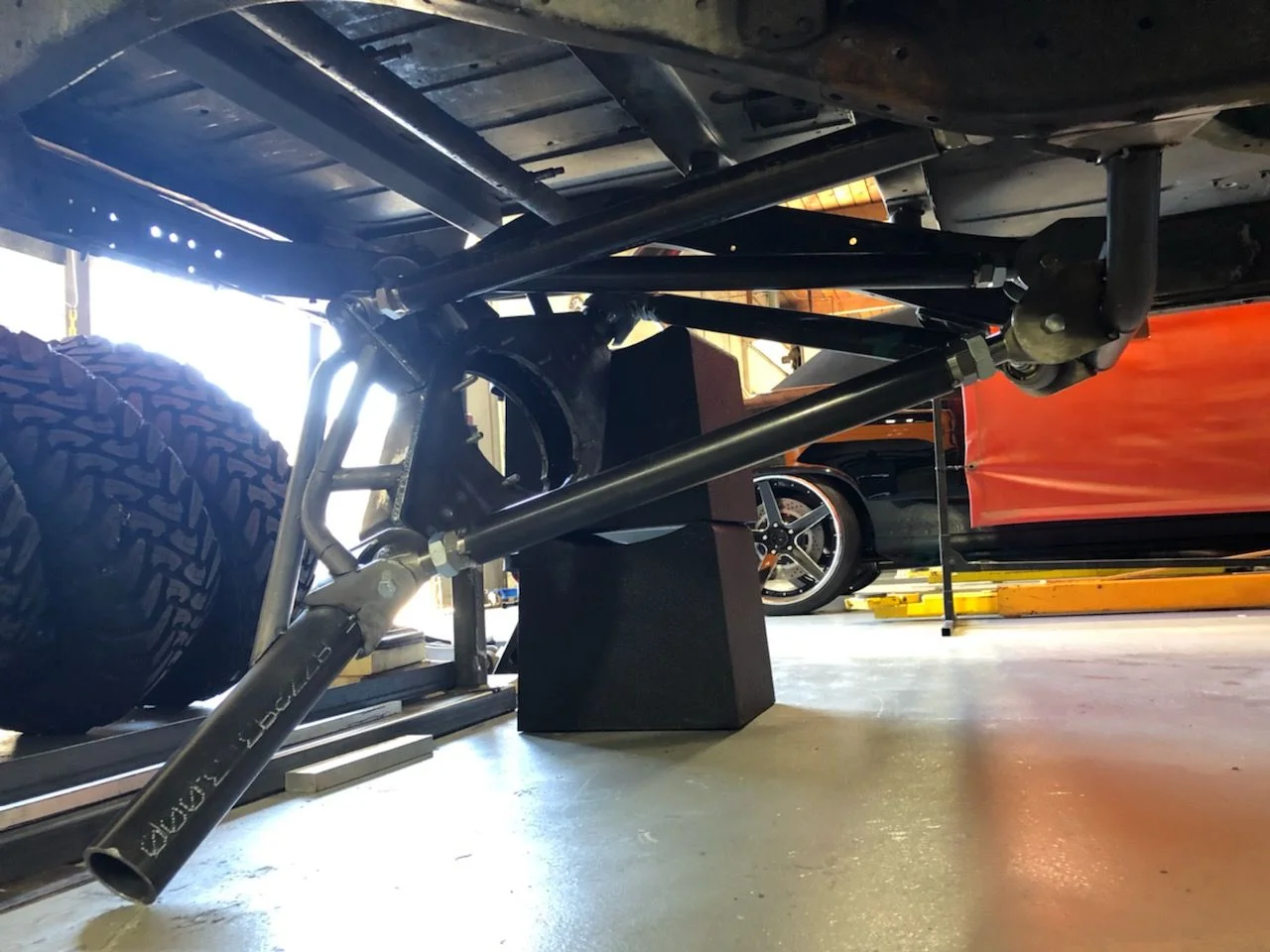

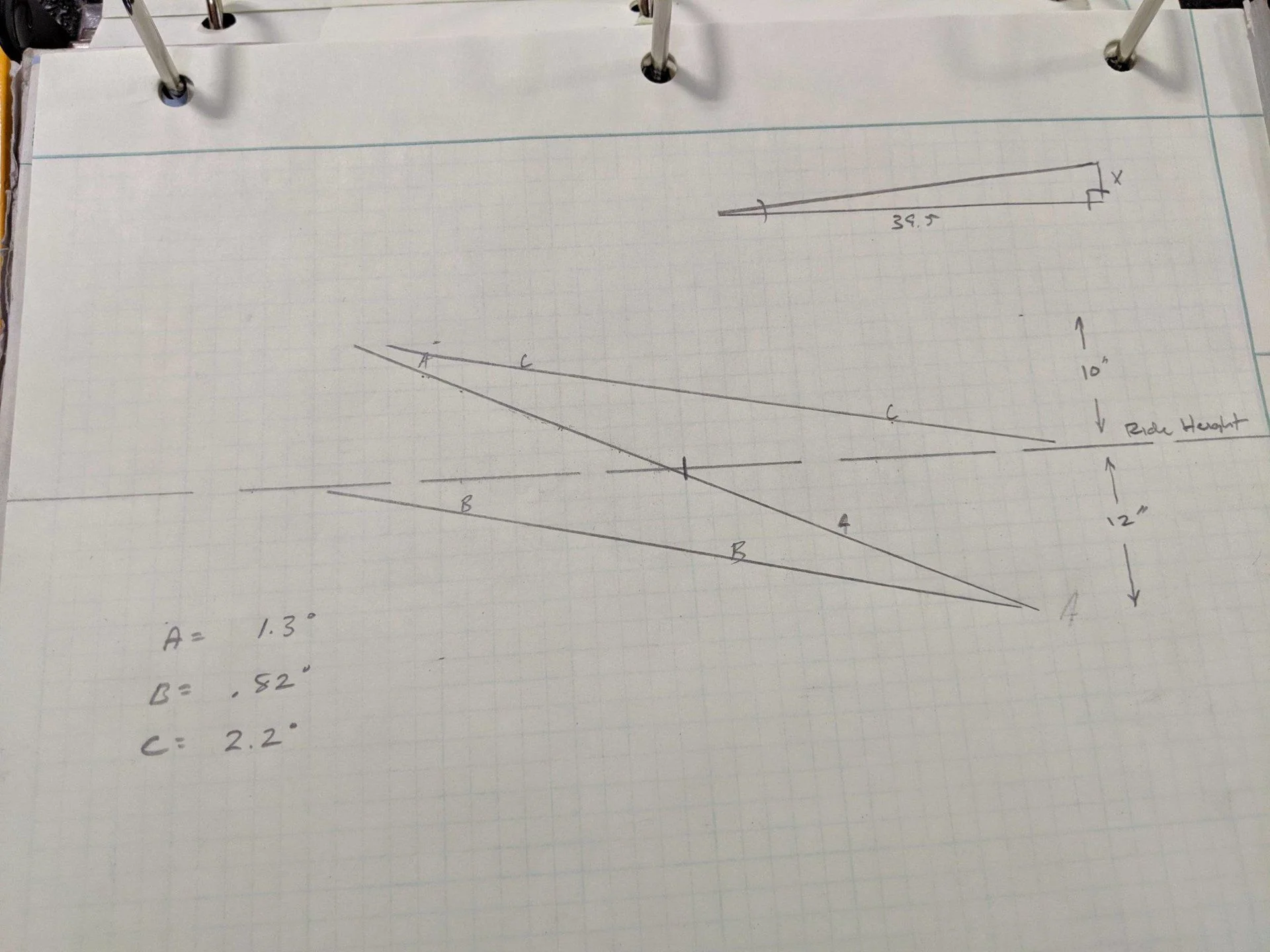

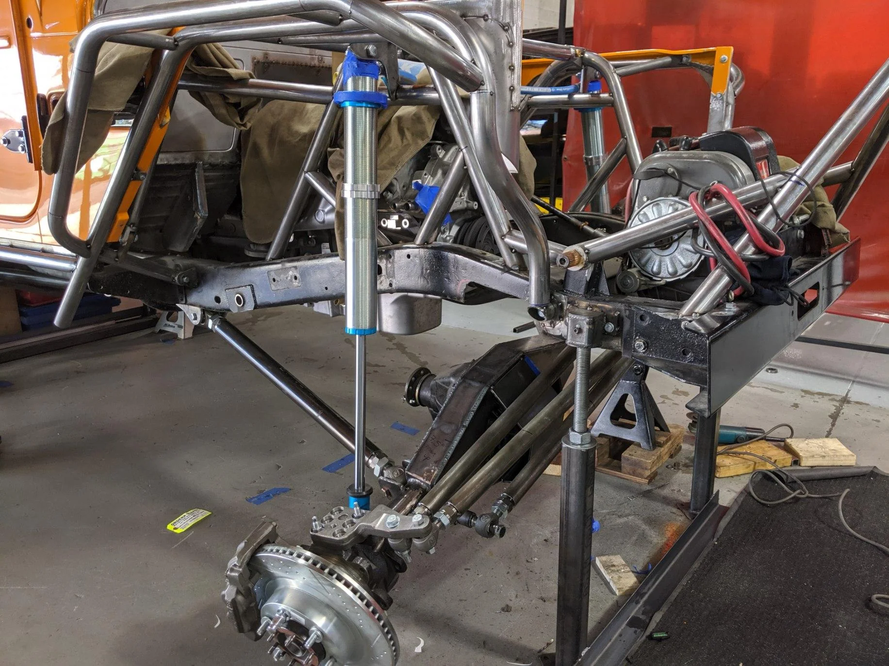

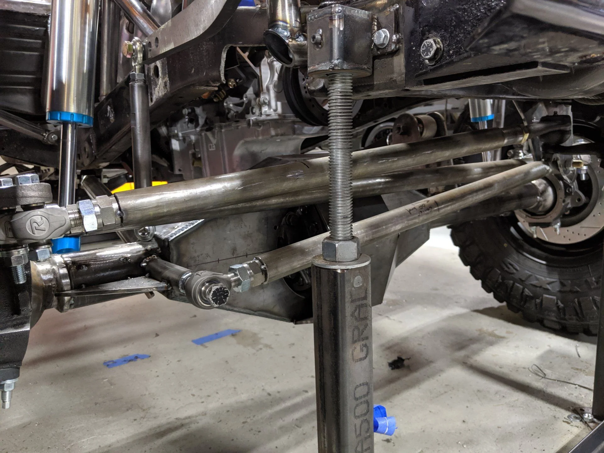

One another note your geometry is not very good on your links. You need to spread the lowers out as car as possible. I can not see the rest of the angles but I am sure you will have a lot of roll steer. my two cents.
I would vote Fox.
You are spot on with your comments they are simply tacked for now to get an initial idea of articulation, roll steer, antisquat, packaging, etc... I will be spreading the lower links out quite a bit along with bringing the mounting point up a little for better ground clearance and an antisquat value of around 75%. The link lengths will probably change slightly as well to try and optimize all the conditions as well.

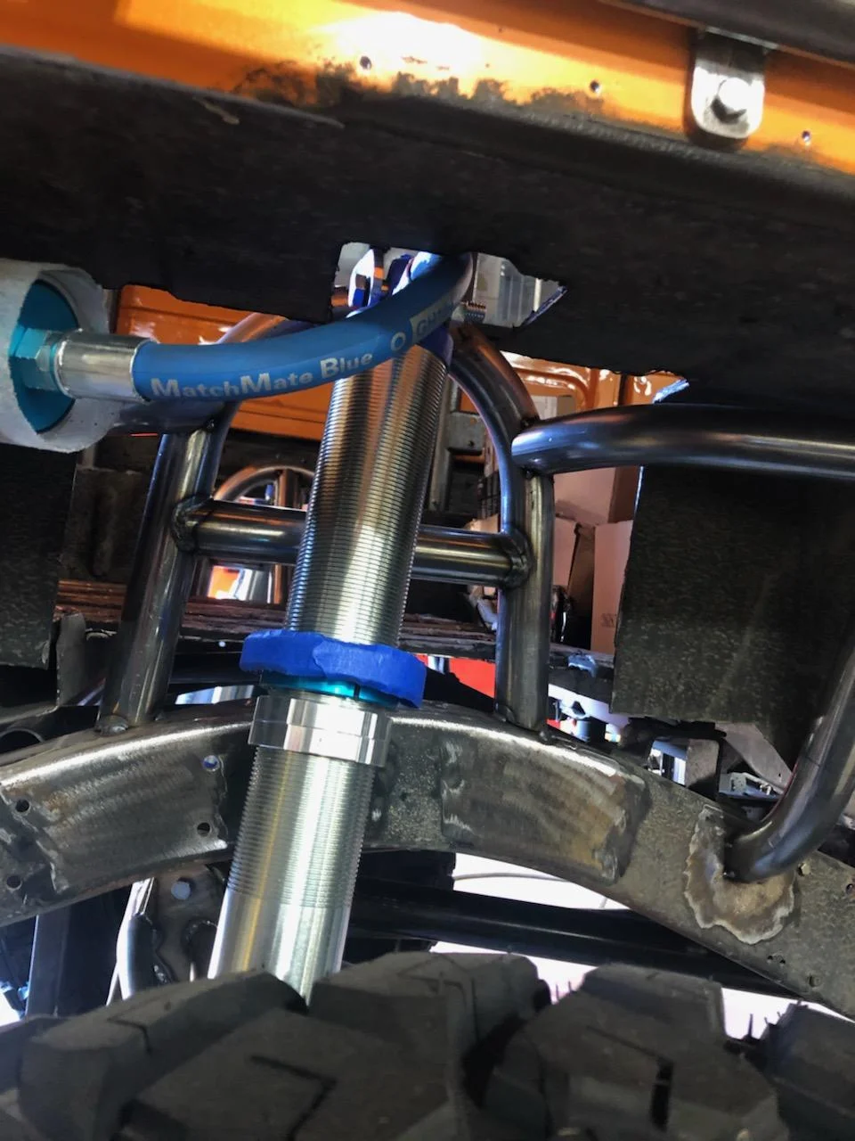

Not sure how you're going to package 16" travel coilovers, but I'll say that they're probably overkill for the front or rear of a linked 40 that's with a factory frame or tub. You'll never use the full travel of said coilovers.

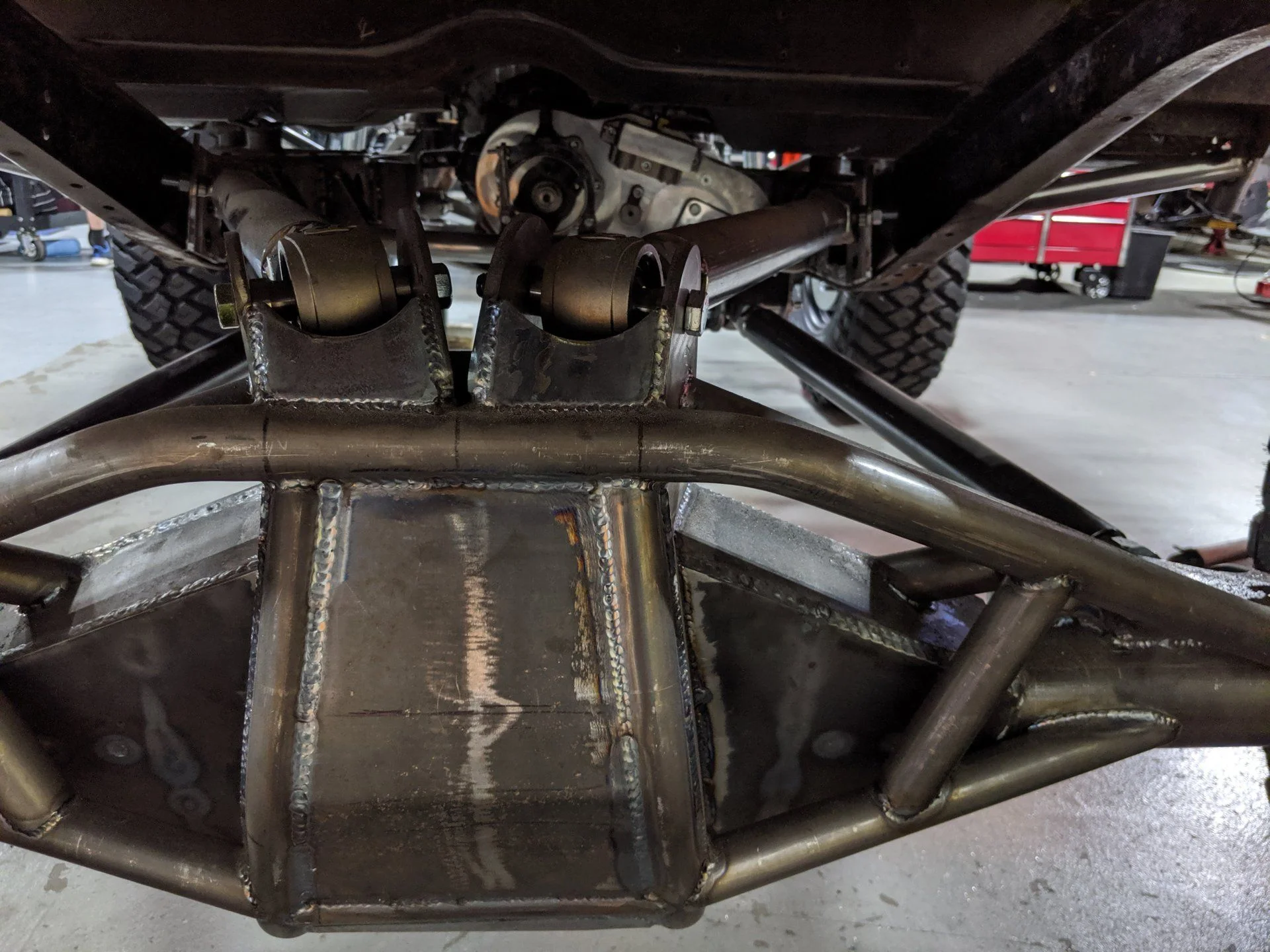

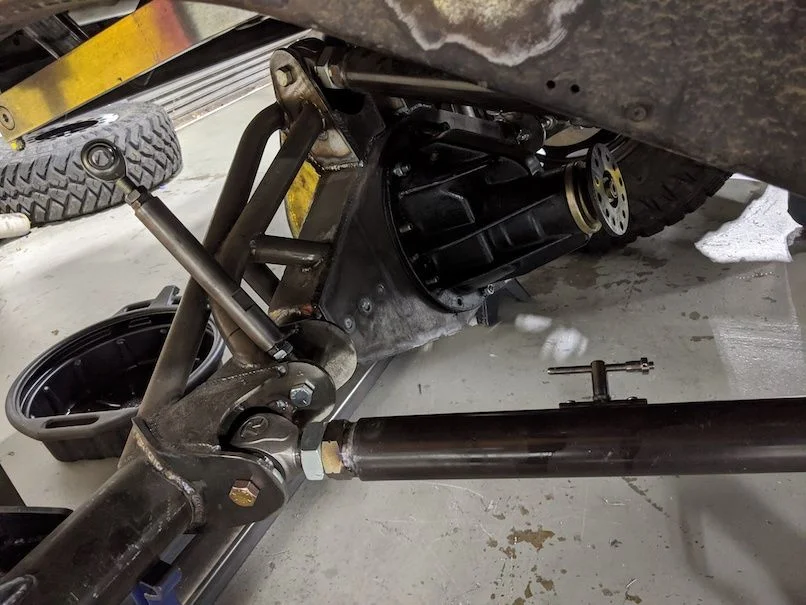

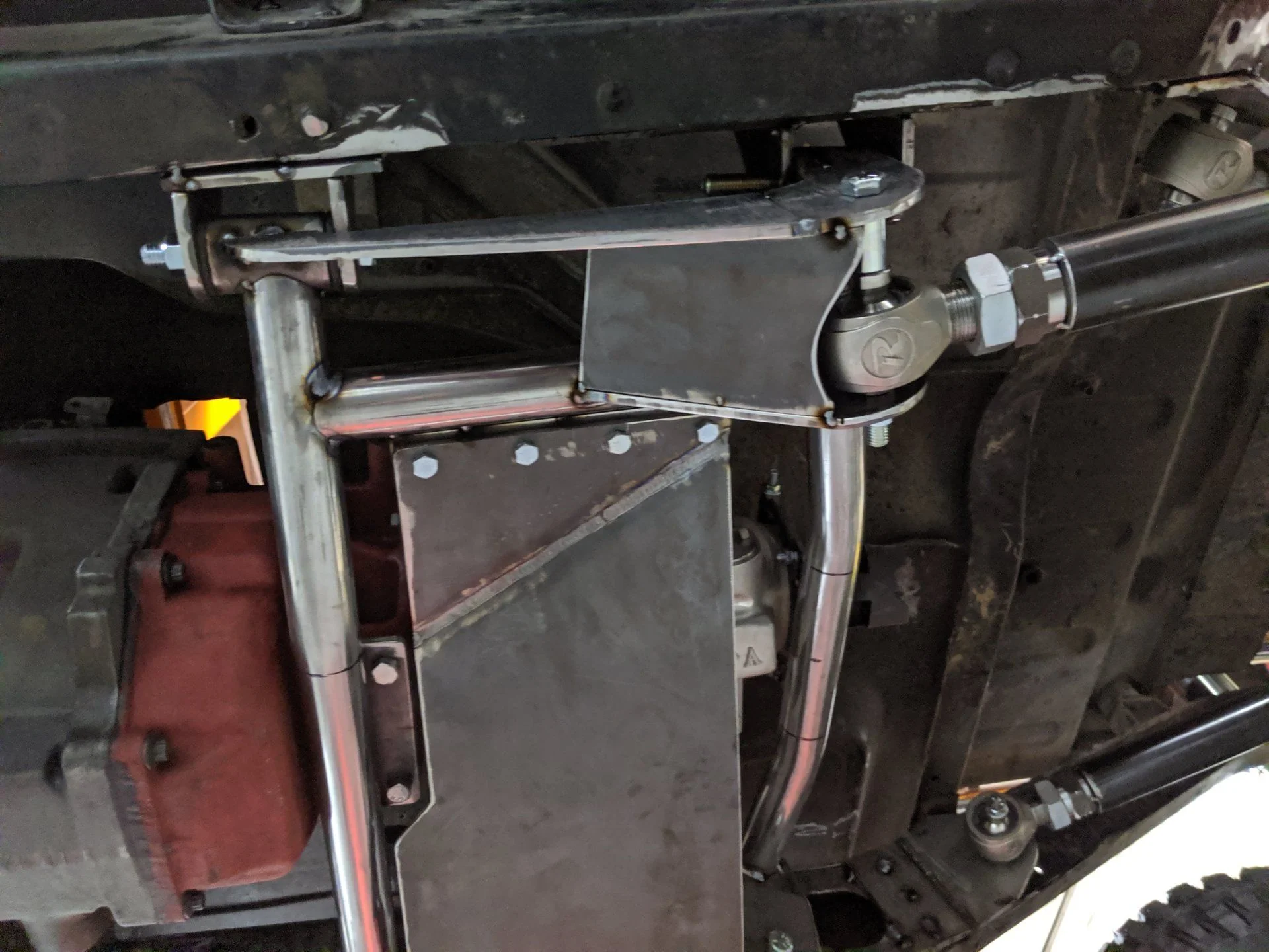

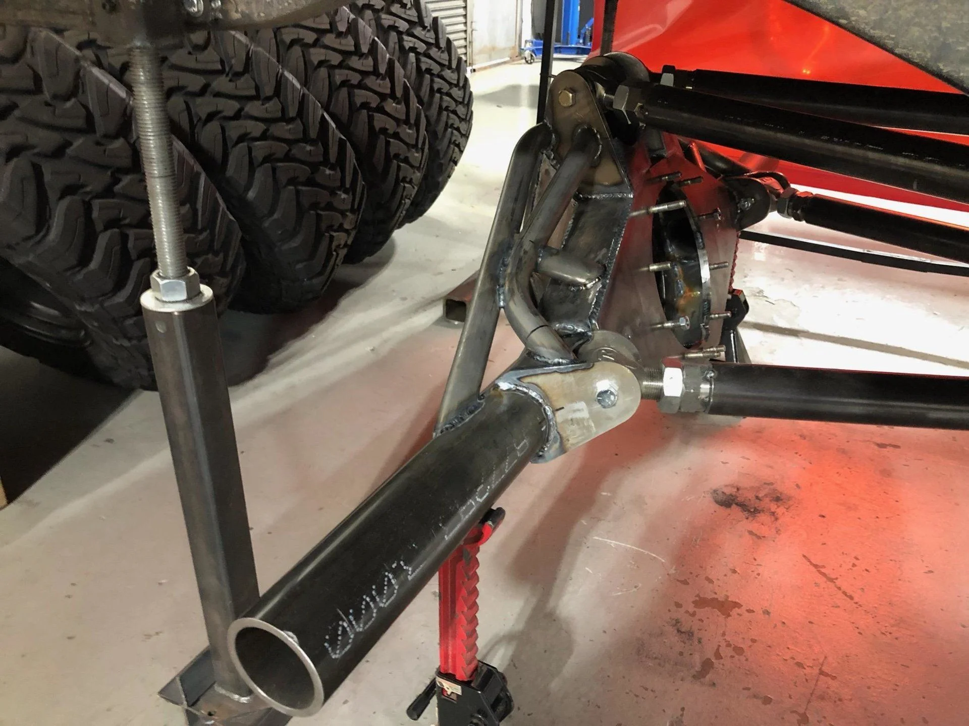

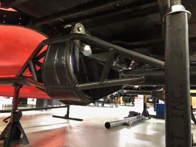

Sick project!! And I'm sitting jelly here. One thing that sticks out for me and I know this isn't the point of your thread, but what's the deal with that panhard mount? Looks like an area I would personally beef up or rethink. All in all great work.

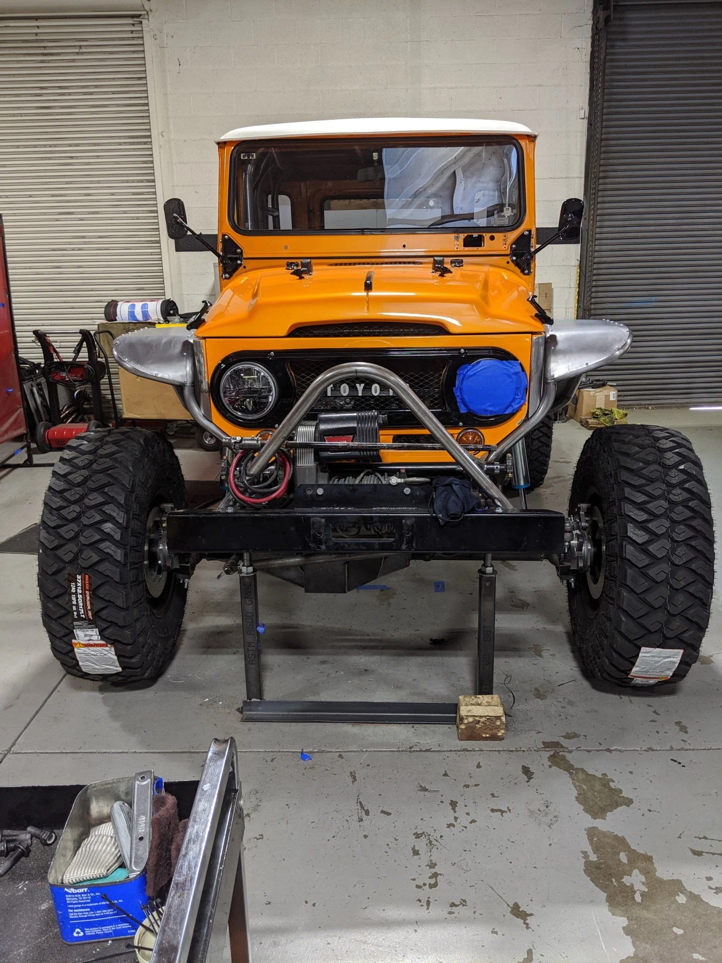

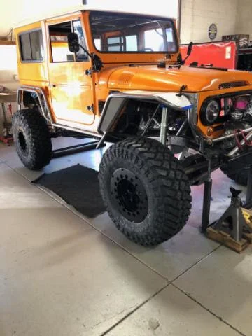

Thanks for the compliments. Running 37's (maxxis), Hydro assist goes in next week, the trucks overall height is not that tall, as you can see below. Will get lowest frame measurement.
Wow, I am speechless, what a nice 40 you built. Not too many people can do detailed work the way you did! Really love it !
And thank you, looking forward to hear those measurements, for sure this got me motivated a lot more.
D.
when I saw some of his first pics, I thought "you better brace that lower link mount or you're in for some fun"
and then I saw some later pics he posted and he braced them really nice.
I'm guessing its the same on the panhard mount

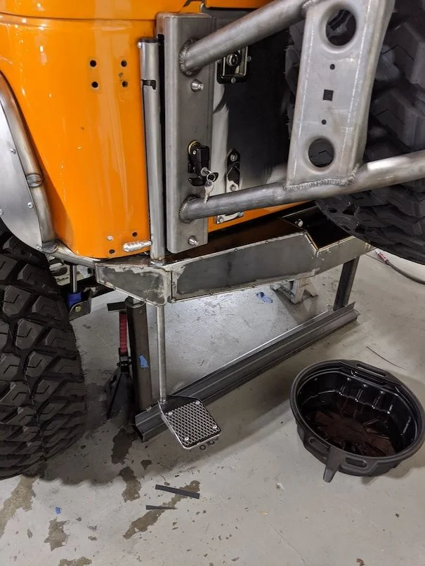

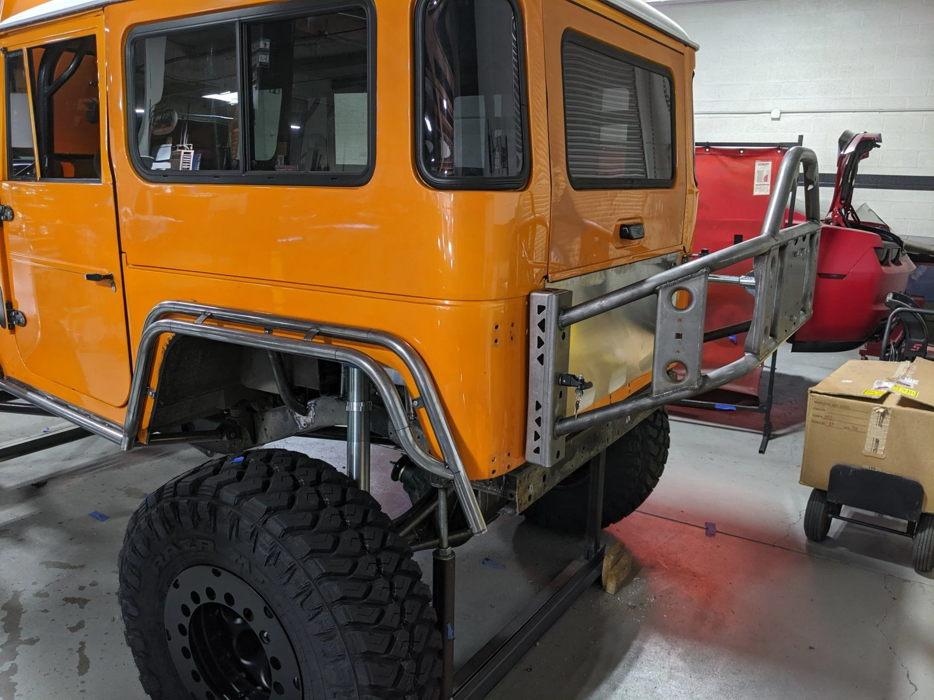

some updates on the project, installed a trick step for the kiddo's to make it easier for them to climb into the back of the rig.

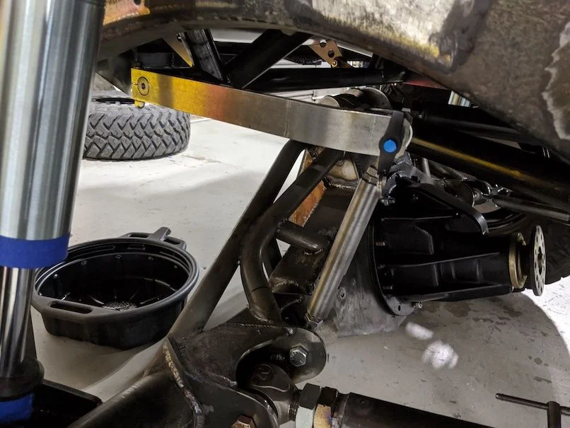

rear sway bar with quick disconnect pins. you can see the pin on the link bar to mount it on when disconnected.
