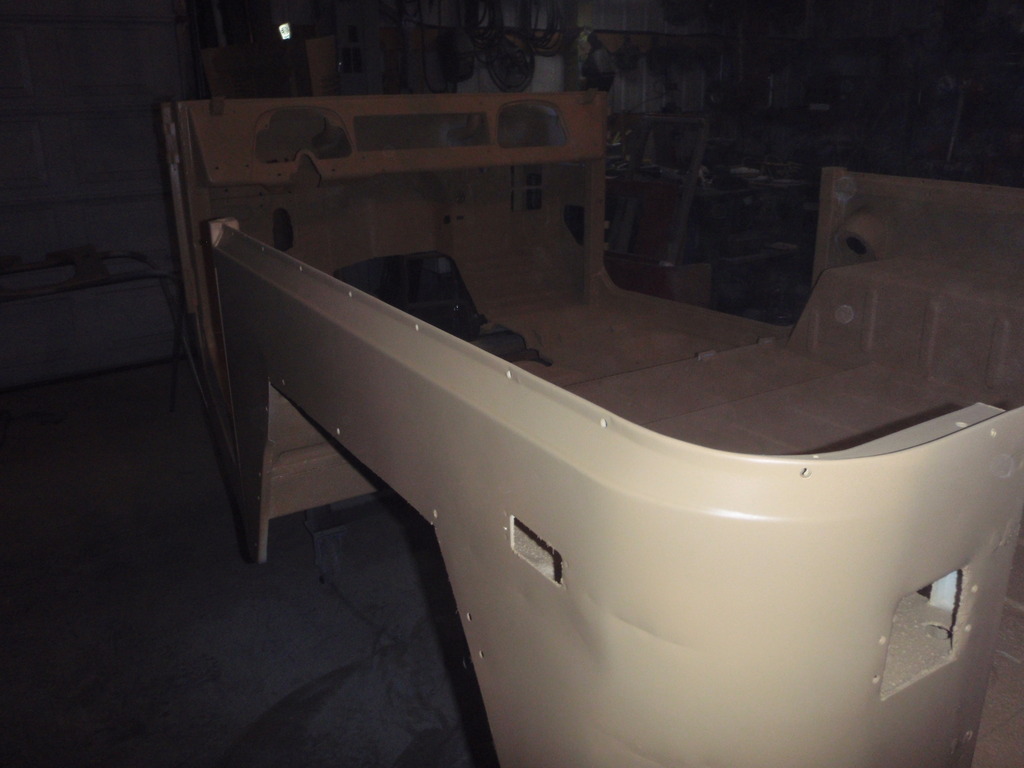

Maybe
Paint
all that crap in the air? it's my filtration system.... gravity. I jokingly call it my "floor refurbishment system"
and I need to buy more paint - more importantly, more activator.... ah well, about the only thing I "must" paint is the window frame and the grill shell.... and I have enough paint for those two things.
no clearcoat. I'm painting this over several weeks - temp and humidity changes the gloss level... I had thoughts of matte-clearing it, but now after seeing the paint (and knowing it's going to lighten), I'm not going to bother.

there's the issue - you can't buff flat paint. This is why I was so concerned about the color of the under-layers. It gets scratched, it gets scratched. The only time I'll worry about it is if it scratches to bare metal - then I'll simply brush a bit of paint in the hole. When it comes time to sell, I'll simply repaint the outside....
in the vein of the painting thing - it would cost a bunch to have someone paint this.... I already have the materials and tools, so it cost me less than $100 to paint the rig... just one of the billions of advantages of doing it yourself - and as I said before, it's okay to do it wrong because you're doing it and you will get it right eventually...
