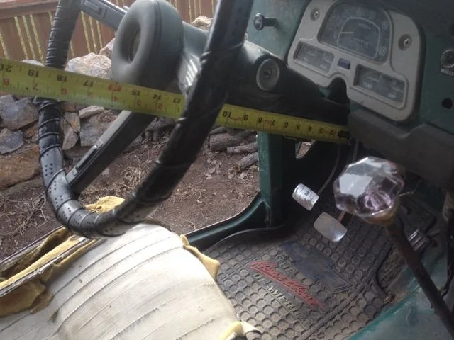

Maybe these will be a good reference from a stock perspective, 1974 fj40.
I measured from the end of the horseshoe bracket that clamps the column to the underside of the dash.
