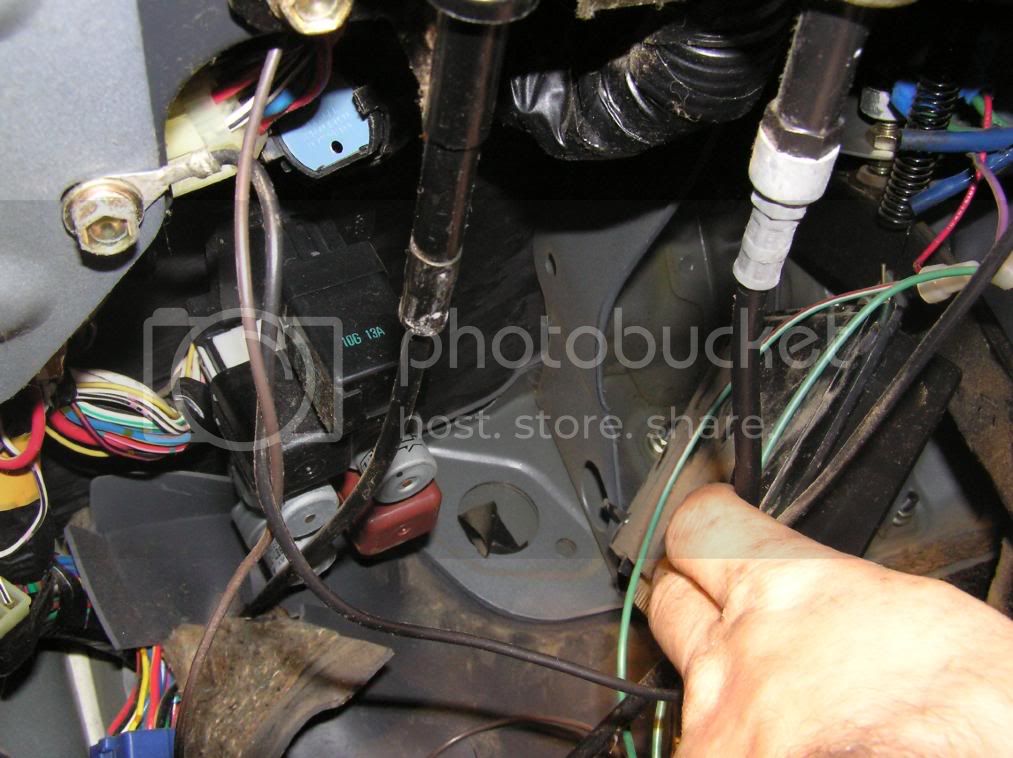

I got it. "To get the pedal assembly into position you have to remove the instrument cluster and unbolt and lower the steering column and unbolt and suspend the brake master cylinder."
This part is done, (Thanks Al).
"I used a Greenlee punch to make the hole for the master cylinder. There is no guesswork for doing this because the hole positions are stamped onto the firewall for the master cylinder and the 2 bolt holes."

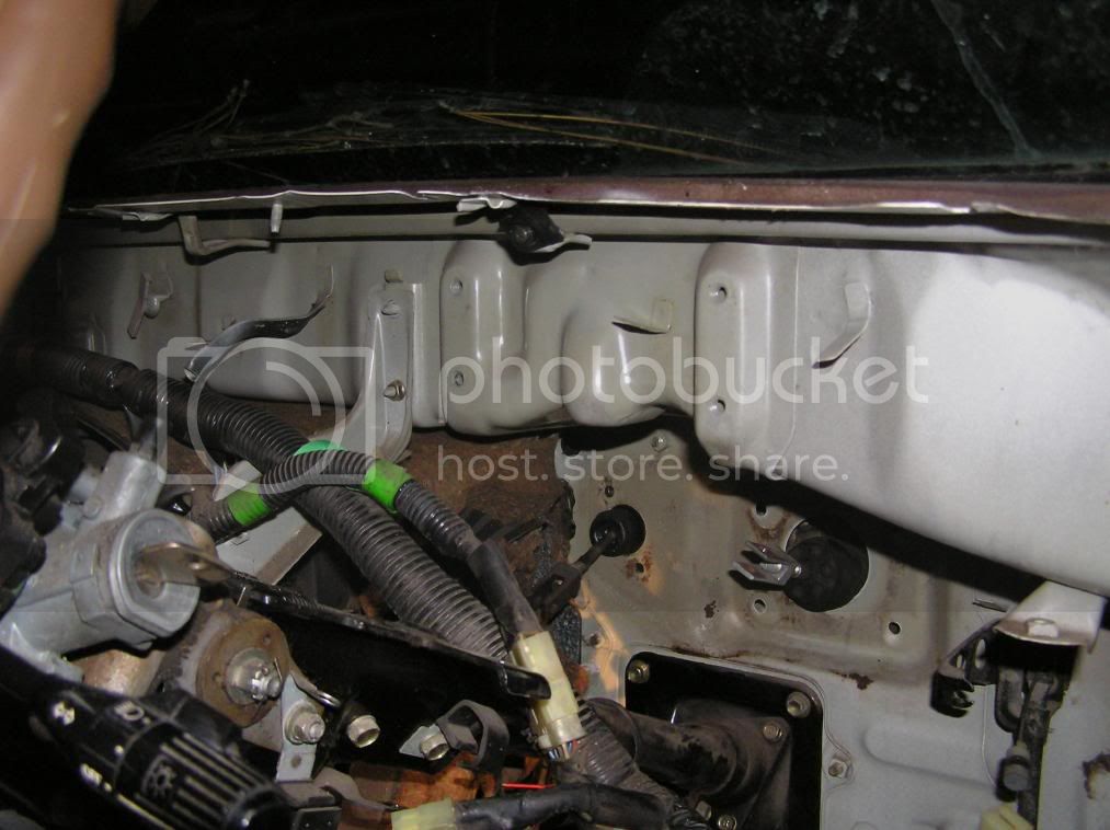

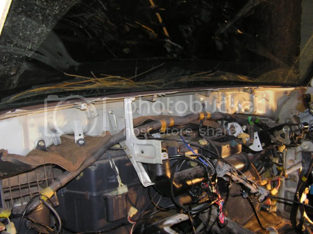

But, remember, the donor pedal bucket is from a RHD. You all are saying that it can replace the LHD pedal bucket from the 62? Or am I just moving over the clutch pedal and clutch master cylinder???
Officially confused.
You are moving over the clutch master, and the pedal bucket.
You will have to bend a new hard line from the clutch master.
This line connects to a soft line.
The soft line connects directly to the slave.
You will need to weld on the metal tab from shelia's firewall as a connection point.
This tab allows you to attach the hard line to the soft line.
All auto parts store sell hard lines in various lengths and sizes.
You should be able to reuse your soft line.

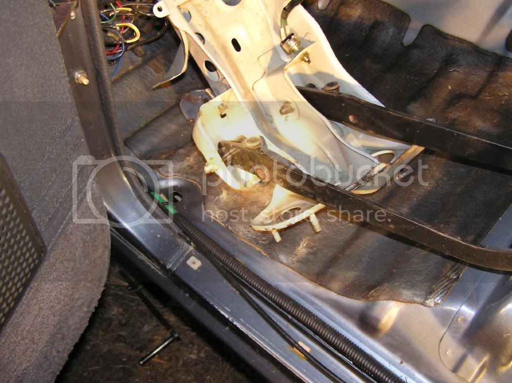

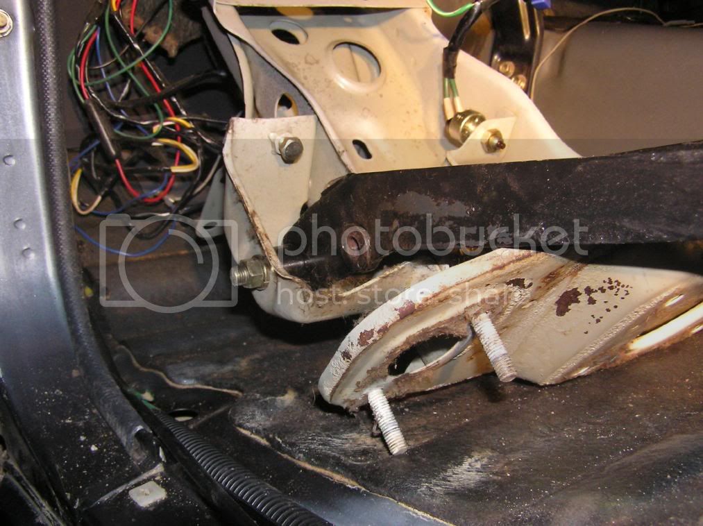

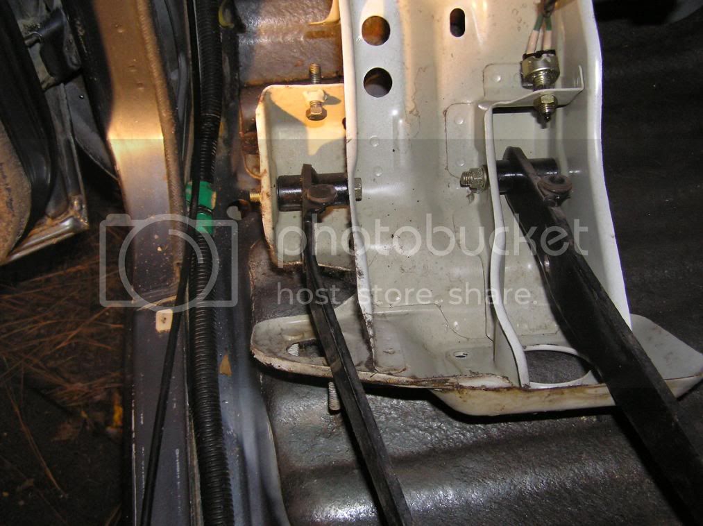

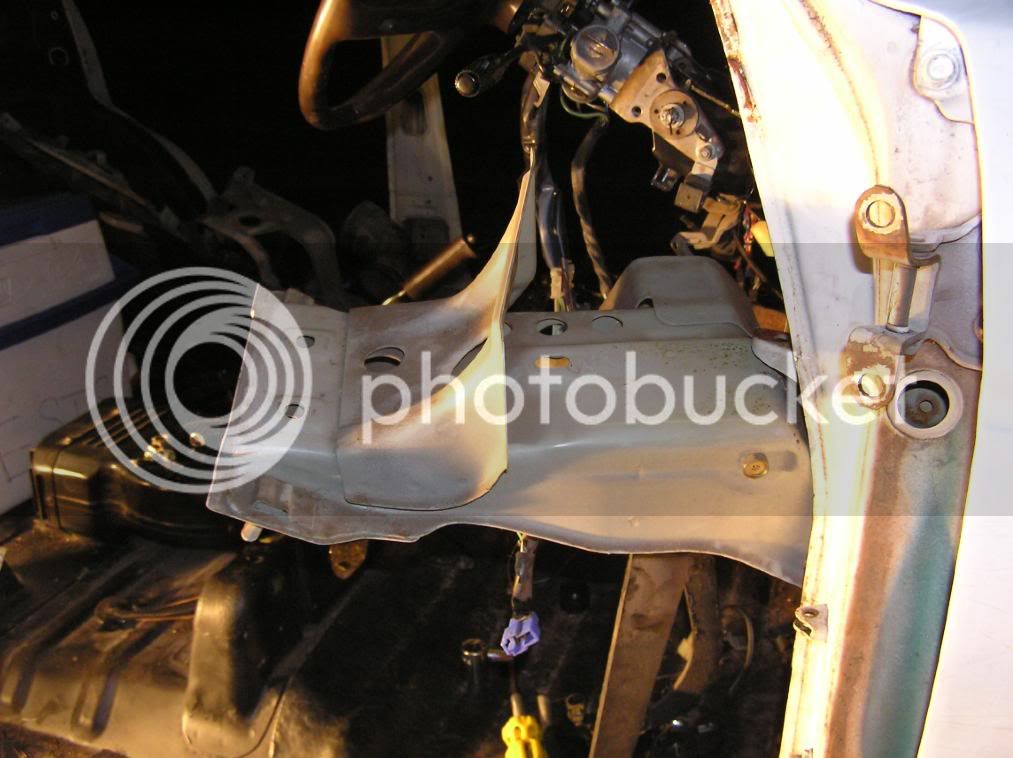

Pedal bucket swap no workie.
60 pedal bucket (RHD)
Taken from above. Note angled piece that mounts to the dash/cowl to conform to the angle of the cowl on that side of the vehicle. Pay careful attention to the protrusion on the top left side of the bucket (with the bolt and nut sticking out). Note that this cup is welded on to the bucket. It has three weld spots holding it on to the bucket on this side. Three similar weld spots are on each of the two other sides of that cup.
Note the four threaded nutcerts where the bucket attaches to the cowl, directly behind the instrument cluster. That is a welded on panel...
Compare sides. See, no extra panel welded on, hence no nutcerts to take the bucket? See different angle, even if it had such a provision. The bucket is not universal, but sided...
Business end of the 60's bucket, Now you can see how this cup is a provision to brace the clutch pedal and to provide two places where the pedal pivot shaft are supported...
Better angle.
Better still, up in there. You can imagine the other side of the clutch pedal cup with tabs turned out and where the spot or tack welds are... Further down, note the fixed threaded bolts that go through the firewall to take the master cylinder.
See the small hole, center of photo but up about an inch? That takes one end of the shaft on which the clutch pedal pivots. The other end of the shaft will be supported by the hole in the cup that is getting moved over. Now see the pre-stamped large center hole on the firewall for the master cylinder and the two master cylinder mounting holes that are gonna need some bolts...
See a pedal cup missing???
So...I will cut the clutch pedal support cup/bracket off of the old pedal bucket and drill holes at the weld spots and bolt it in its new home with at least three bolts. I can tack weld it in later if desired.

I got in there and saw all of this. Looks pretty easy (except for the moving over of the pedal bucket).
As I was reading through the two pages of this thread I was thinking that the pedal bucket is not the same on LHD/RHD vehicles and wasn't going to work, and so it is. This was also the case, to my surprise, on my HJ47 which I converted from RHD to LHD - the pedal buckets are different, and not interchangeable, and the pedals themselves are bent differently to clear around the steering column.
Can you source a LHD pedal bucket with the clutch fitted - or is the firewall problem really the hitch?
