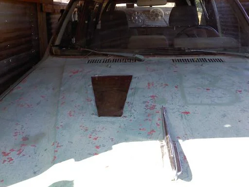

I had a chunk of Lexan laying around... Honestly you have to pay upwards of $100k to get a car with a window over the engine.... So I figure it upped the value of GB at least 10 fold! To about $400..... Hehehe
attachment.php
^Wrong hood ornament. Ya need one of the old Buick Gunsight Styles, along with 6 faux carbon fiber side vents! :lol:

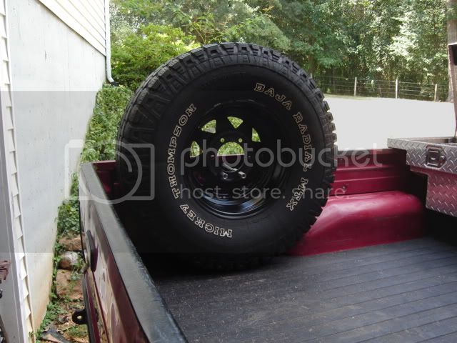

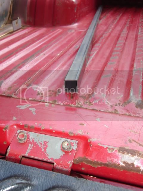

Full size spare is always in the way when we go on wheeling or camping trips so decided to mount it vertical. All the hardware and stock were found at Home Depot so it's a low buck mod. Made the bed more useful when driving to the camp site. I lay the spare down and strap it to the bed when wheeling, the bed side is not rigid enough for hard wheeling.
1" square stock
Fits perfect inside the bed rail lip
Weld some 1/2-13 nuts on...
Self tapping screws through existing bedliner screw holes...
Allthread and some allthread nuts... holds the tire very secure, more so than I expected. With a little bracing to the bed (like the desert racers) I'd wheel it that way too... another project for another day!! ;)
