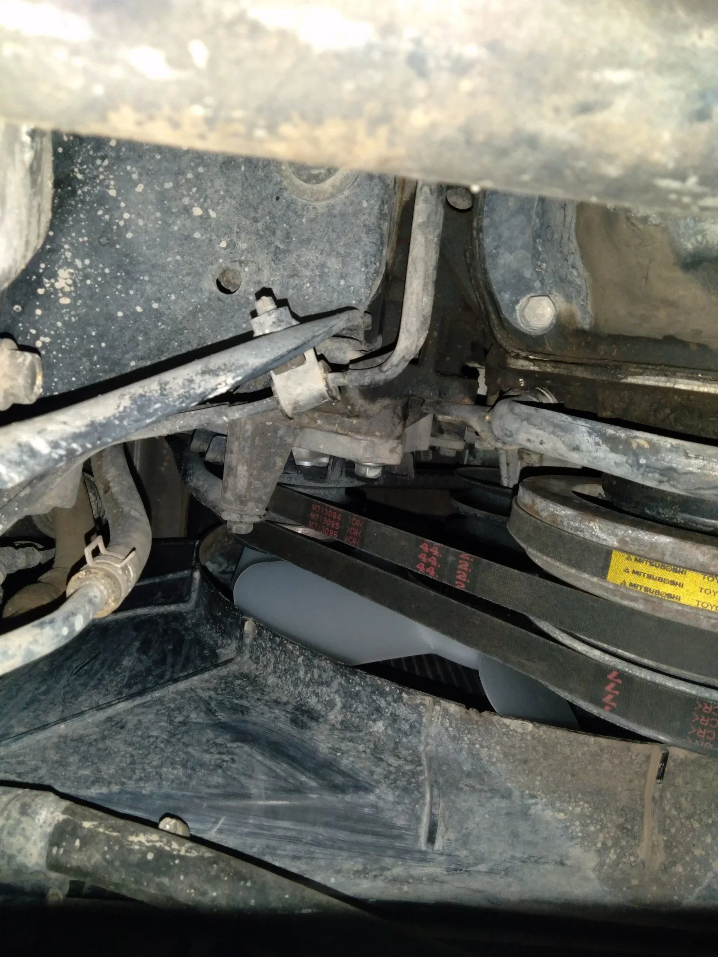

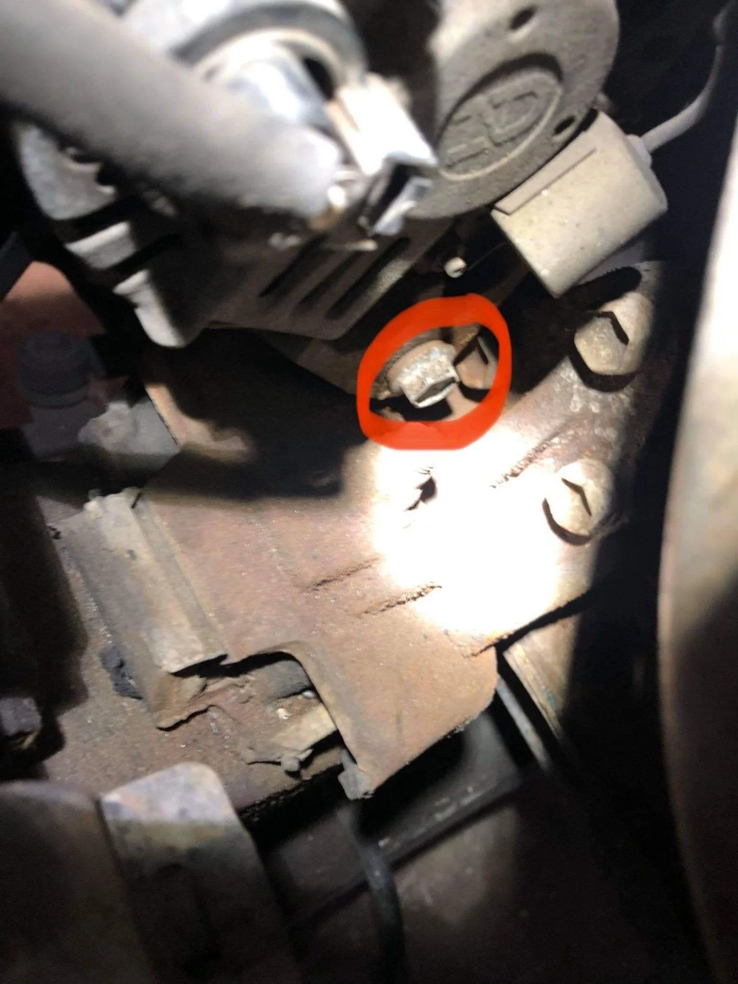

I’m having a similar weird “rattle” type of noise that is present at idle and am missing a nut on the bottom of the alternator bracket. The first picture is from the bottom and the missing nut would be facing the front of the cruiser. The second picture is the bolt for the missing nut from the top and the back side of the alternator facing the firewall. Is this the same nut you were missing? Do you by chance have a part number if so, thanks.

Thanks for the info, I’ll see if the dealer can help me out with the nut.
Well I got a nut today for it and it definitely fixed the noise/vibration at idle and low acceleration. It is an M10x1.25 if anybody needs it. Toyota part number is 90179-10132 but they didn’t have one at my local dealer so I got one from Home Depot and it fit great. Thanks for the info.
