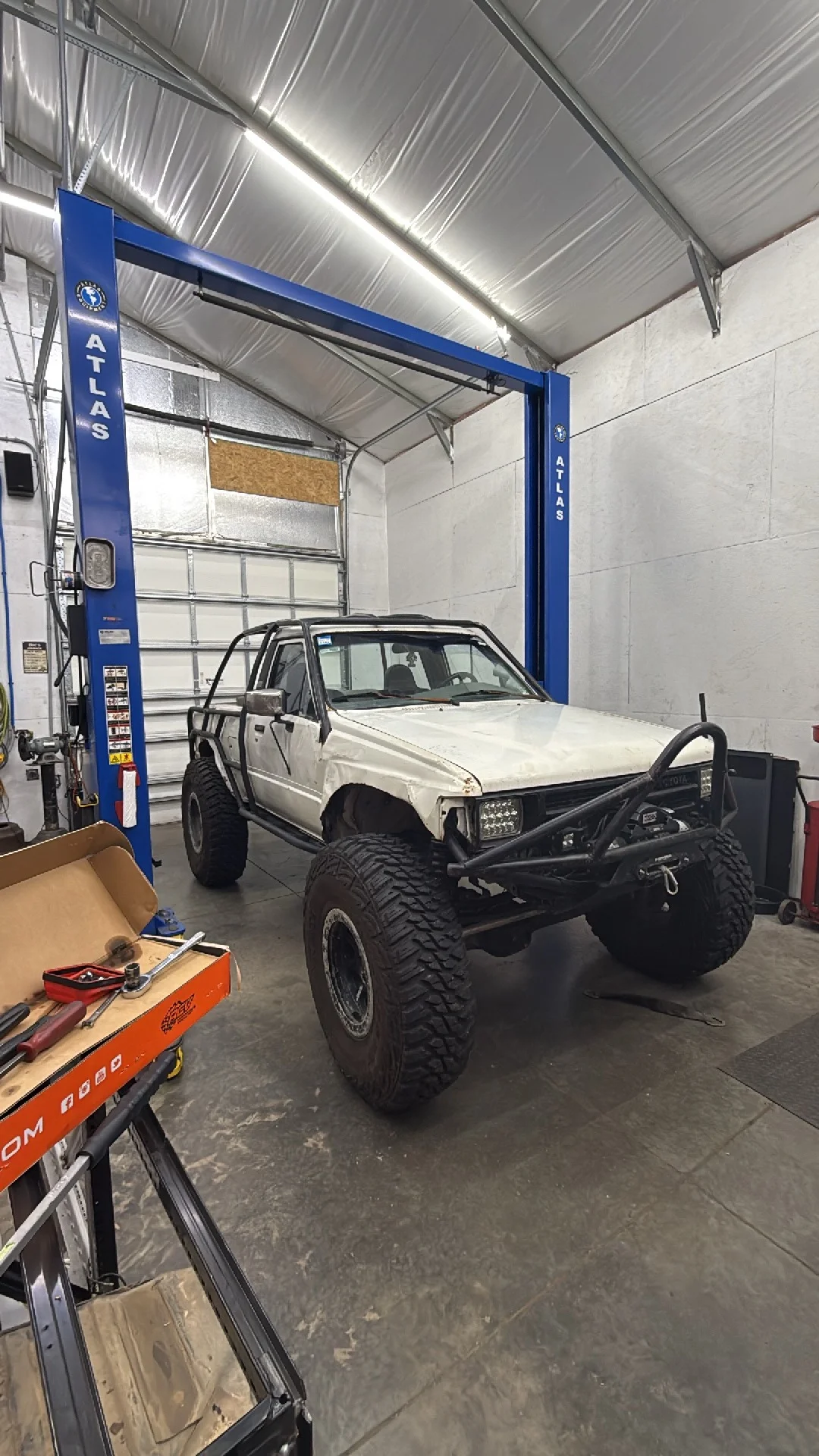

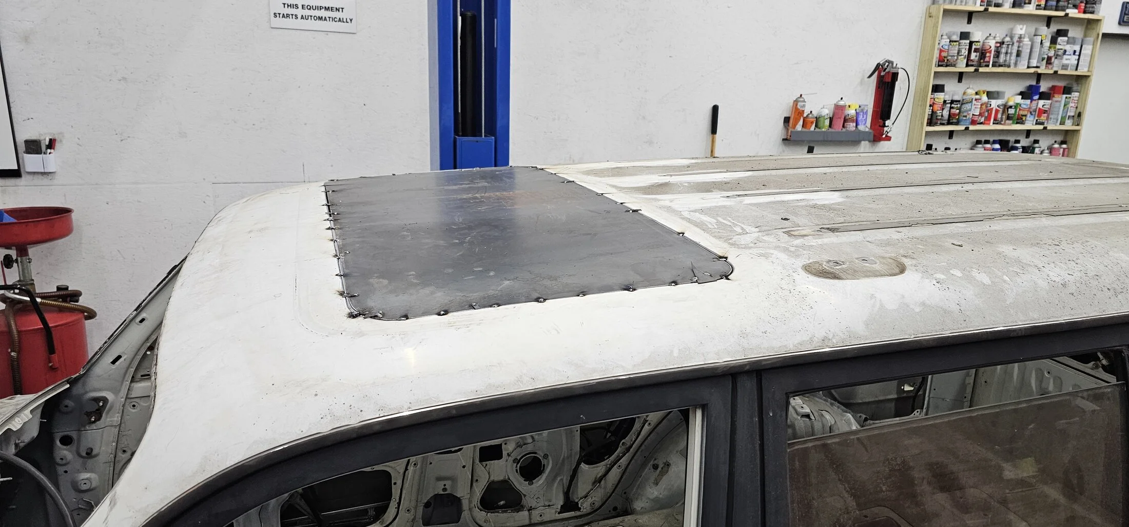

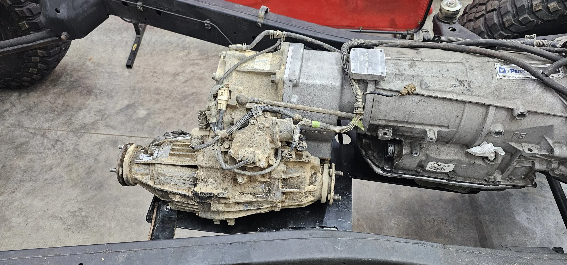

Been busy with life, just now getting back dipity. Put some RCVs in the front axle, got the engine/6l80/t-case installed. did some sanding on The firewall/ underside and started on the sunroof delete.
It doesn't help i keep stealing the lift every other month.... (Per usual)
well, finally got around to painting. 2 coats of white raptor liner with some thermacels mixed in with it. used spectrum sound deadening inside on the roof and now preparing the inside floor for then top that off with some spectrum firewall.
