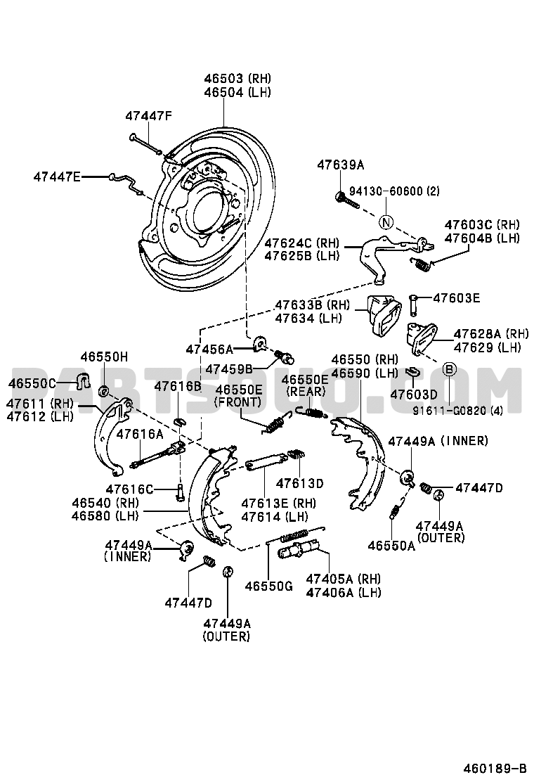

I think taking the grinder to it is most likely to work, but will require several replacement parts:
1x 46420-60010 (diagram reference 46420, “cable assembly #2”)
2x 90213-04001 (diagram reference 47616A, “parking brake wire”)
2x 47616-60020 (diagram reference 47616B, “washer type c for wire”)
2x 90249-07074 (diagram reference 47616C, “pin for wire”)
(Parts diagrams attached)
I’ll grind along the red line which will permit me to remove the bell crank (albeit with “cable assembly #2” still attached).
I want to be sure I have all the parts I need before I start. Is anyone familiar with what exactly comes with part 46420-60010 “cable assembly #2”? Does it come with all of the new pins and fasteners that will be needed to fully replace all the handbrake components along the rear axle? I already have replacements for the bell cranks as well as everything that lives inside the drums aside from 47616.

@NewbieOverland I’m going to torch it. I’ve been studying the diagrams and it looks like the white cable is actually the main handbrake cable that goes all the way to the handle, which I have very little interest in replacing.... Really hope the torch works. Though I’m going to try it with my MSR camp stove in place of a torch since I already own it.

Ok, I got it apart. After a week of marinating in the PB Blaster, the pin that connects the main wire to the bracket (rightmost pin in last picture I posted) was freely rotating within the bracket holes. The pin was still seized inside the eye at the end of the wire, but some creative vice grip work ended up getting it free. I mangled the bracket in the process but that’s okay since it’s only a $5 part.
I tried my butane torch on it as well but I’m not convinced that did anything other than smoke the PB.
I partially cut the bell crank arm with a dremel as shown in post #9 and then broke it off with vice grips. I left the remaining pin attached (leftmost pin in last picture) since I’m replacing the bracket and bell crank anyway.
