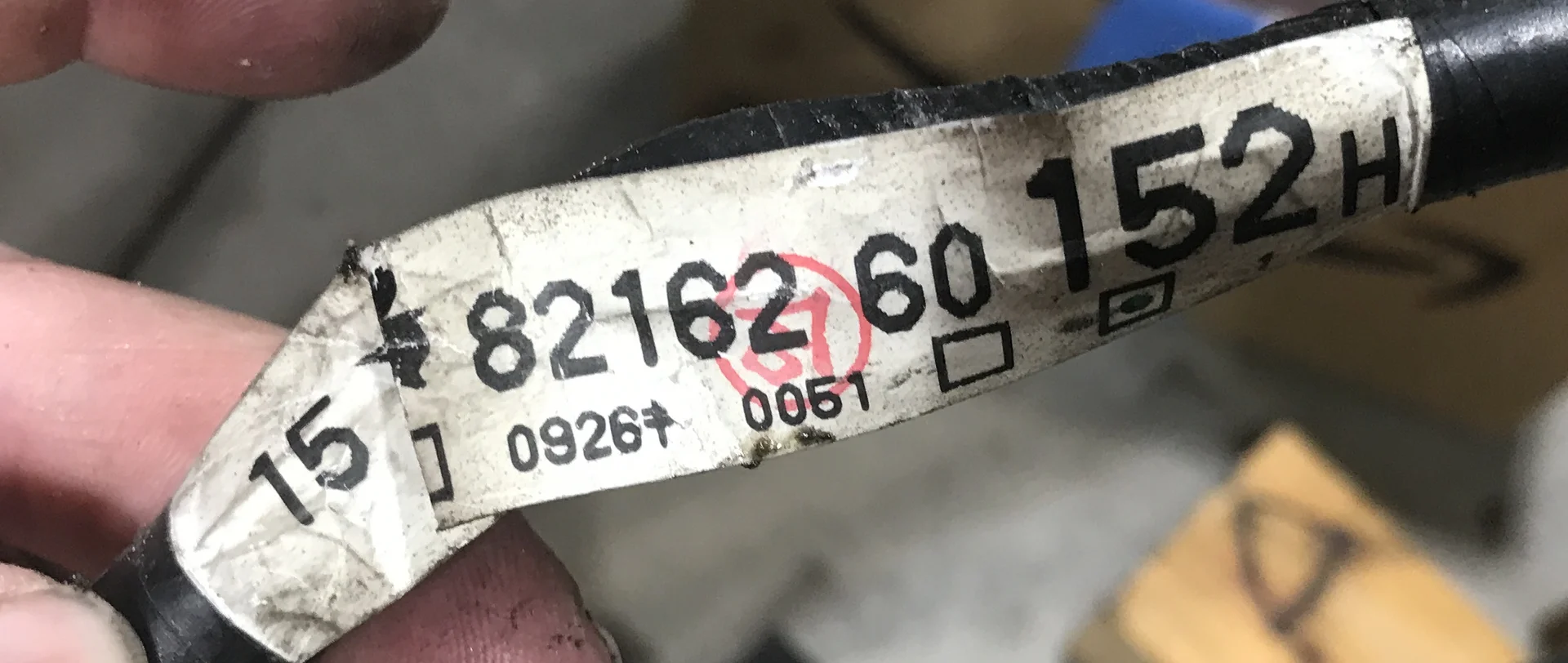

8216260152 WIRE, FLOOR, NO.2

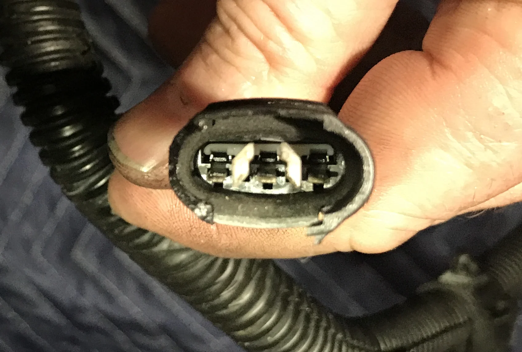

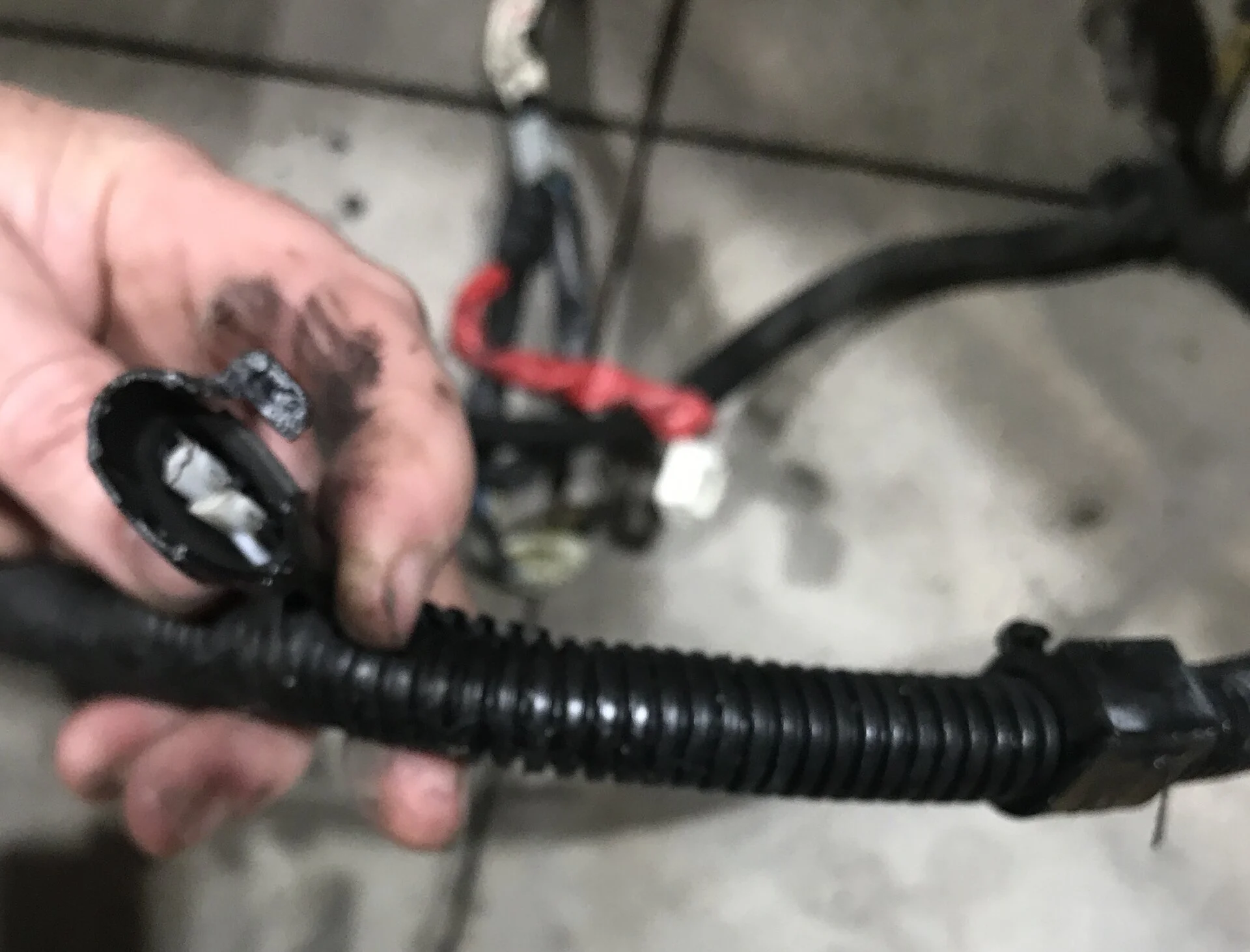

The harness that links both sides of the rear combination lights, but has the fuel sender wire routed thru it. Of course my hulk hands broke the fuel sending 25 year old plastic on that connector.
F63
90980-10500 * this should be mine but that is long gone.
90980-11293 – this is short/mid so probably not the one I need.
super helpful blurry picture
I probably should just replace the entire harness... again because toyota hates the 77
WIRE, FLOOR, NO.2 8216260152
that no longer exists
I think maybe?
WIRE, FLOOR, NO.2 82162-60150
or
WIRE, FLOOR, NO.2 82162-60151
should work as a replacement
does anybody have experiance with that harness replacment or that fuel sending unit connector?
please advise
-60150/151 don’t exist either. -60152 is a supersession of the previous two so you are SOL in terms of getting a new OEM harness.
Try finding a used one; post up an ad in the Classifieds section.
Or, look through the Electrical Connector book and find a male-female connector pair that are both available and have the same number of cavities and get the appropriate splices and splice them all in.
Or, look at a later model 76 series and try to source the sub-harness from a new vehicle and integrate.
Or, forget about the Toyota stuff; get some car parts store connectors and make your own sub-harness.

Ok yea I that was my rolling around in my head. I will just see what pairs I can find and slice into it. Thank you.

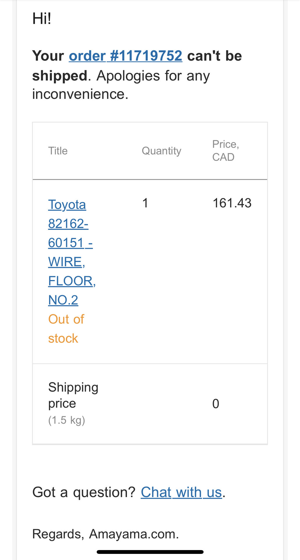

I ordered WIRE, FLOOR, NO.2 Genuine Toyota (8216260151) and some other connectors so... I will update this tread after I find out what works.
8216260151 should be a direct replacment but... until I get my eyes on it... I can't say for sure
thank you
Oh where did you order?

worst that can happen is I get my money back? so if Dave was not able to get it I'm sure it's no longer available. or somebody has a magic barrel in the woods with wires in it?
either way I will have a solution because I ordered some similar stuff from eastern beaver and will just re-plug it.
ohh yeah but it’s worth trying I places the order too but in the last 30 month I mostly got refunded on every tentative to buy a wire floor 2
Good luck 🤞
No secret sauce here. Every single Toyota parts e-commerce site outside of the US pulls from the same global inventory.
Unlike the e-commerce sites, Dave talks to real humans in Japan when he procures parts so he knows if something is really available or not.
This wire is not going to show up.
