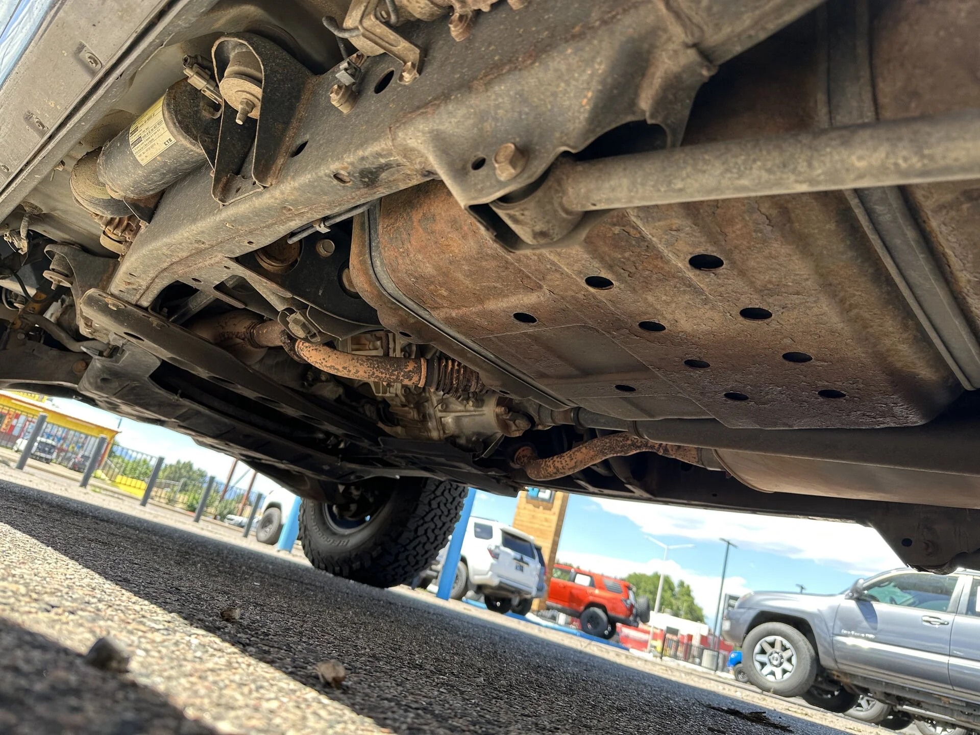

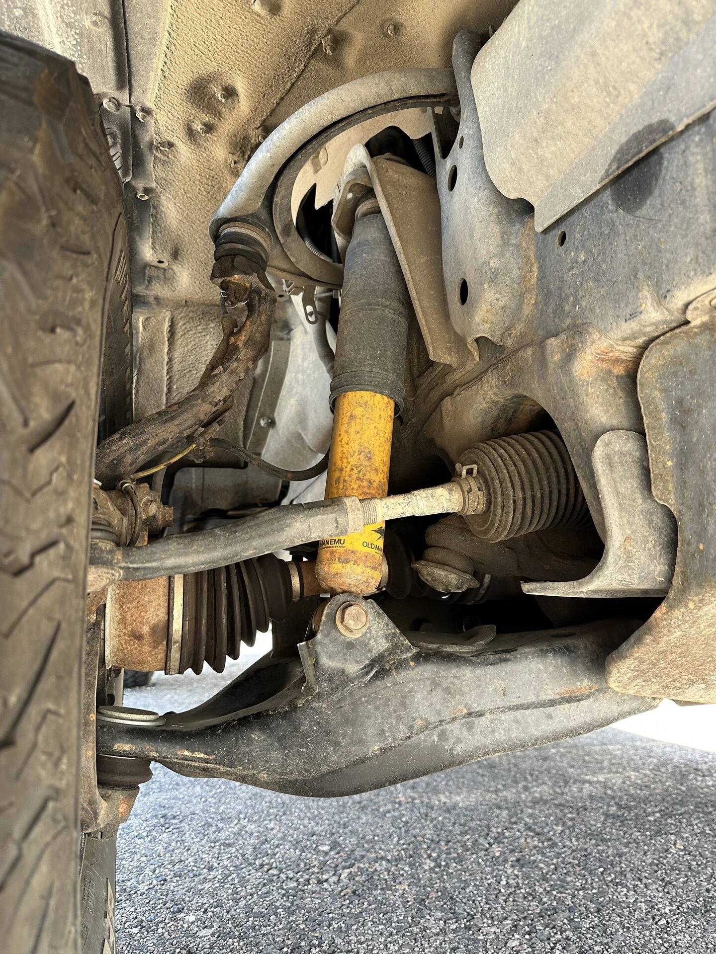

Hi all. I started shopping for my first LC100/LX 470 a couple of weeks ago. A used car lot an hour from me has a 6 owner, 2005 LX 470 with 200k miles. UT and CO owned. They're asking $17,900. The interior/exterior is a little worn, but not anything I can't live with. I'm not sure what to make of the undercarriage. Seems like mostly surface rust, but maybe some rot under the gas tank? I added the two worst-looking photos. Just wondering if it's worth spending an afternoon to go see it. I don't think I'd want to pay more than $14k for it.

I doubt it's ever been to any type of offroad aside from maybe some gravel roads. I barely even drive my LX, and the few times its been offroad really shows. I have scuffs and all kinda visible trail damage underneath. I don't see a single scrape under this truck.

The gas tank skid rust looks to be surface from not regularly washing underside. Very common in CO UT. If that's about all, it's no big deal.

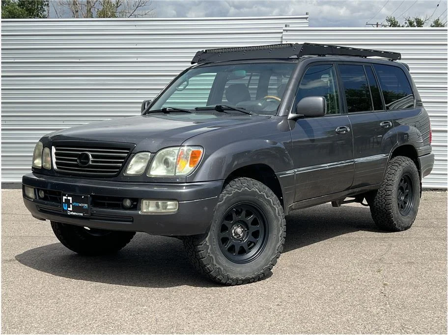

Ko2, wheels and roof rack are adds.
Missing NightView camera and it's windshields along with missing running boards are deducts.
The OME shocks are likely end of life. It likely has aftermarket rear coils and T-bars crank up for a mild lift.
Note it has both trailer hitches, indicates some towing use.
The paint appears missing from hub flange in pictures. If so, indication some sonic cleaned them. This indicate special care in service. The painted black grill also indicates special care/pride.
