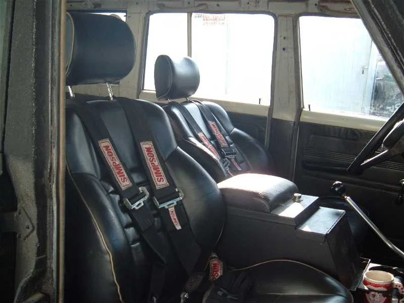

I'll try and get you pics of the brakets / mounts used in my pig. I have tercel? seats and they are the bomb.
When I pulled this arrangement from my donor pig, I did have to cut some of the stock seat perches out of my 71 pig. I do love the way she rides with buckets. Beats the hell out of the bench.

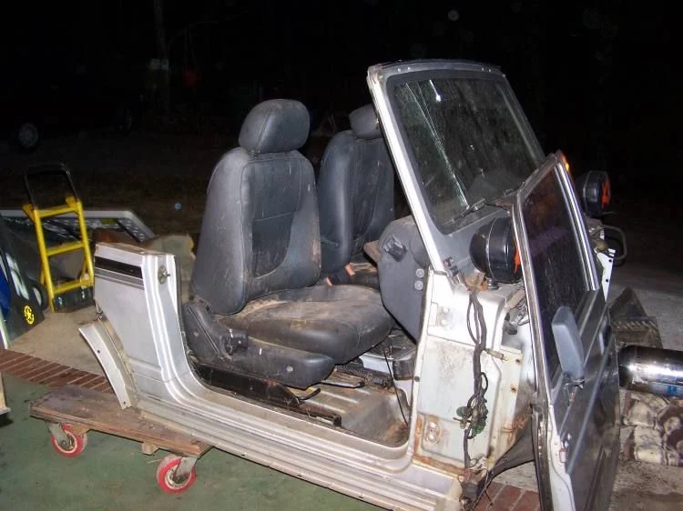

Just got some caddie 2003 cts seats installed. Installation was pretty straight forward. Because of their size, the rearmost seat mounts need to be about 4" back from the stock rearmost mount. I just made a bracket out of 1x2" and 0.12" x3" stock. Seats have a lot of up and down adjustment, maybe 4" of travel, which is cool since I like my seat lower than most.
Not the best pics, my digi is dead so the camera phone does it.
