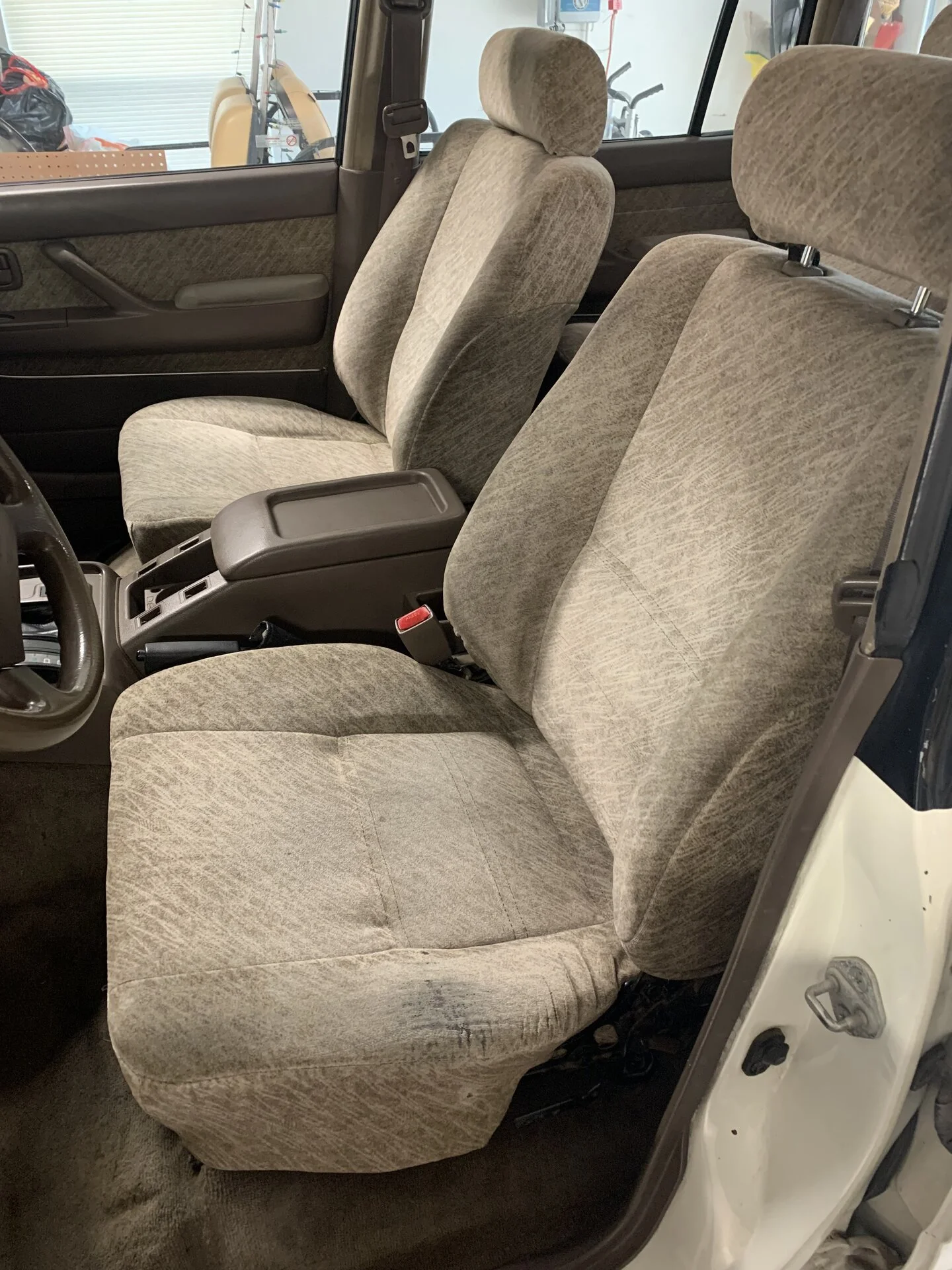

🧐 I’m 6’4” and have the manual cloth seats that I’ve swapped in.
I’m pretty sure it’s about a 2 inch difference over power seats.
And There a direct bolt in.
For me, it was totally worth it.
And you get rid of the crappy leather😎

You said you were not convinced there was more leg room. but you comparing to your already modified LX with 3rd gen runner seats so you don't really know do you :doh:
I have compared them to Land Cruiser power seats side buy side and you do get 2 more inches with them and they bolt right up that was the point.
And when your ready to get rid of the seat that SUCK in your 94 there highly sought after 😜
The manual, cloth seats in great condition out of my 93 went to the dump. Couldn't give them away.
But, to be fair, I cut up the feet and used them for my Audi seat install
My guess is that cloth seats are more the norm over there. Where here there very rare. And there definitely sought after here.
I literally installed landtanks kit last weekend. I'm 6' with 34" inseam. One of the best comfort upgrades I've done. I've got the seat about 1.5" back from the original position.
I’m 6’6” with a 36” inseam. My seat brackets were design 1 right after the purchase.
I’ve owned multiple 80s who all got the kit. I find that the amount of increase is fine.
Cloth seats fall short of the modified electric seats by about a half inch in travel.
