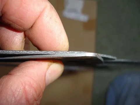

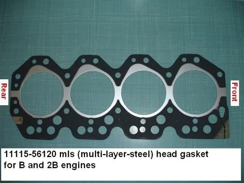

My 1979 BJ40 with B-engine was built using a 11115-56010 head gasket and 11115-56120 certainly appears to work for her...

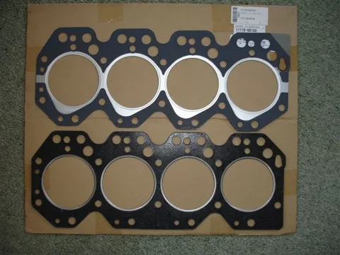

Here's some pics I took comparing the genuine Toyota 11115-56120 with the gasket supplied by Engine Australia with their B-engine recon pack:
Ist the 56120 gasket by itself:
Comparison with the Engine Australia gasket:
I don't suppose you have the original 2B gasket there RHSC so we can do an image comparison?
And do you know the part number of the gasket that on there now (that may be the culprit for your coolant overheat problems)?
:beer:
PS. Failing that, shoot some dead-on images of your head and block and maybe we could try to use them with my 56120 gasket to see from the images if we have a match?
Lostmarbles is that a Toyota EPC you displayed my info does not show the B as using the same number as the 2B the pics you show are a good comparison on how the OEM and aftermarket are so different in construction.
I wonder why the OEM has so much more metal on the one side of the cylinder I am wondering if that has to do with the pre-cups.

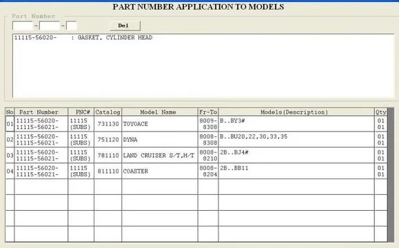

Yep... Home computer version of the epc...
I think Toyota went to town on the design of that head gasket to make sure it was the best possible.
It is of such recent design that I can find no information on the part number (11115-56120) as to which models it was designed to fit. (My information is all too old since I dwell in the pre-1990 era pretty much.)
But Web-based EPC data on this 11115-56120 gasket seems to be equally limited from what I see in my searches (with the part number not being recognised).

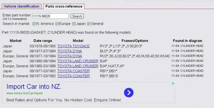

And BTW, when I search EPC data on the Web for 11115-56020 I get interesting information indeed...
This suggest it fits engines from 1977 through to 1986! But then it sort of destroys it's credibility by saying this head gasket even fits an HJ47 (as you can see above) :eek: How can it fit a 6 cylinder engine by any stretch of the imagination???
:cheers:
PS. I'm aware that when posting in the past I've said I thought 11115-56120 should fit this 2B engine (and therefore would supersede 11115-56020/21). And I still suspect this could be the case. But I'm not certain...

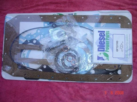

I say most of the kit should fit based on this (and the little fact that it's your money and not mine LOL):
If you can read the print on the label, the kit Engine Australia supplied me for my 1979 B is supposed to fit a 2B of the same production period so the same should hopefully apply to you.
