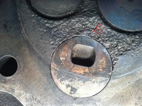

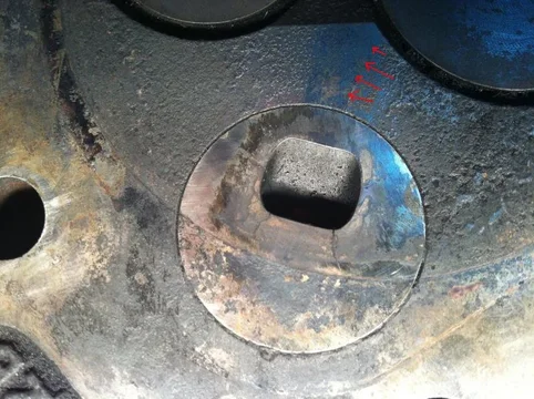

combustion chambers rear to front...
Precups
Also Rear to front...
And finally, the small strip between the valves.
I didn't include the rearmost (#1 or 4?) because it looked fine.
If you look closely you can see the hint of a crack in the first, with each successive chamber looking worse.
Not sure what exactly happened with the last two cylinders (especially the last), but it looks like someone dropped a bag of pebbles in there prior to start up.

I think you're probably right about the head being the issue...
The rear two cylinders look excellent but the front two are just the opposite..
It could be just my an illusion but if these are really cracks then I think they're probably the fatal ones:
No. 1 cylinder:
No.2 cylinder:
I've seen cracks between valves before but not between precups and valves.
And that looks like corrosion pitting on those forward two cylinders to me. (As though the head was on an engine that was discarded at some point with corrosive liquid inside the first two cylinders .... and then brought back into service.)
If those are indeed cracks (and taking into account the severe corrosion on No. 1 cylinder) I don't think that head is worth any salvaging attempt.

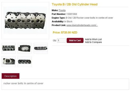

If you have some dosh in your pocket and you have the time to do research (and confirm a proper match) there do appear to be brand new heads available.
Here's a sample from some brief searching I just did now:

You're familiar with the first site Jim ... That's cruiserparts.net (which if I'm not mistaken is where your BJ44 came from)..
The second one is: cylinderheads.co.nz.
Here's the link to the NZ supplier where they have good pics for making a thorough visual comparison:
http://www.cylinderheads.co.nz/100-Toyota-Cylinder-Head
Interesting that the pics show the precups, freeze plugs, valve guides and valve seats already fitted for the $720 price tag too.
I think I'd want to verify that.
And I'd also want to clarify/verify whether it's really new or whether it is "refurbished second-hand".
(I know the advertising says "old" but that word used in that context is ambiguous...)
If it is new then it probably comes from Taiwan but that isn't necessarily bad because that's where most of the parts supplied by Engine Australia come from AFAIK and I haven't heard anything negative about them.
And if you were to buy from NZ you'd need to question them carefully on their packaging because while I've found handlers generally take care with shipping within New Zealand, the handlers in other countries seem to take pleasure in trying and to damage contents. (But I'm probably biased in laying the blame outside NZ because I admit we can sometimes have those types working in our freight handling systems too.)
I think I'd want it "wooden-crated" when being shipped across the world.
:beer:
PS. I recommend asking questions and doing lots of comparison checks to be sure you're getting the right head if you go down this route.
From reading the advertising it appears that some heads are made for different valve covers (apart from the problems we've heard about with different valve sizes etc) so I think that's something to beware of.

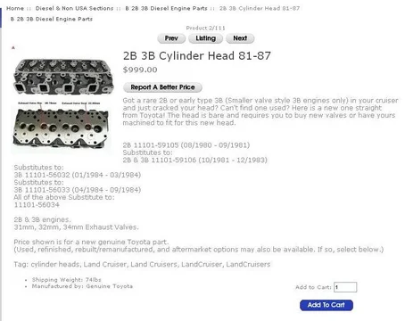

I decided to add this to help flesh this thread out for future reference:
From Dieseler:
2B
11101 HEAD SUB-ASSY, CYLINDER
11101-59105 (08/1980 - 09/1981) 1 $1,785.49
11101-59106 (10/1981 - 09/1982)
3B 1981
11101-59095 (08/1980 - 09/1981) 1 $2,045.61
11101-59096 (10/1981 - 12/1983
1984 bj60
11101-61040
1985 bj70
11101-58013
