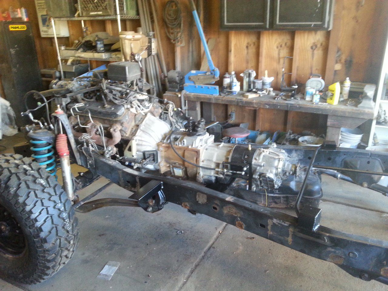

Now were shifting gears!! Had to cut and re angle the shifter for the trans to avoid hitting the steering wheel. and lengthen the rods on the twin stick setup to accomodate the doubler length
Toyota sets the engines in cocked to the driver side for front drive shaft clearances, probably not that much room when your dropping in a v8. But every inch counts.
Cruise diesel , you're right. Engine is over to the left at least an inch. When welding in your own motor mounts you can put it where ever you want, offset seems to give enough room for the tcase on the right side
Update!!! I did lose my phone mid build. (Fell into a pool while painting lol) lost all mu pics but figured there may be afew still interested and I'm gonna continue.

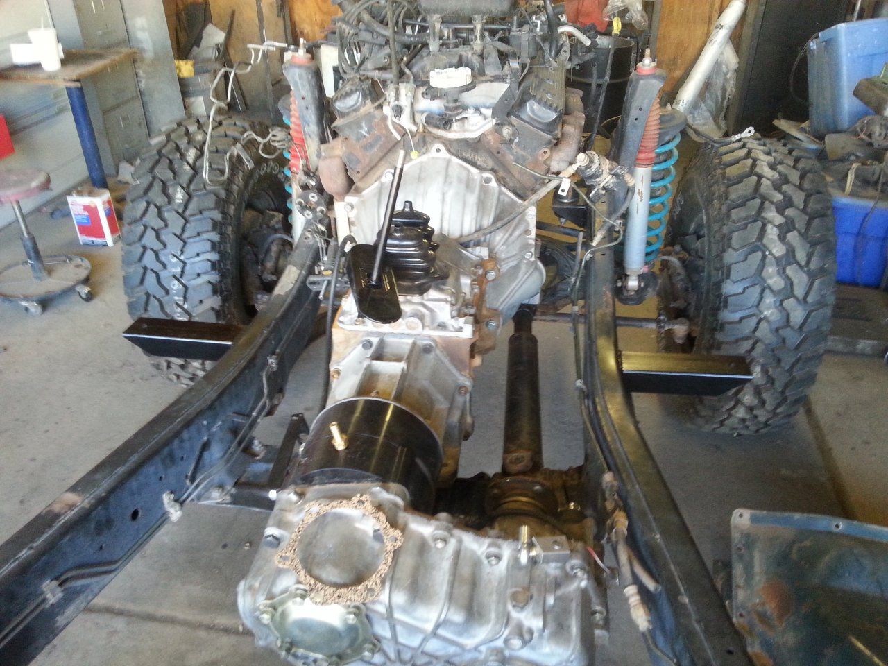

Trans tunnel is complete!! It need to be extended for the black box. The Nv4500 to 19spline fit nicely without mods but the doubler pushed it back 5.75in. Also added a floor mounted E brake, that's makes 5 hand levers!!
