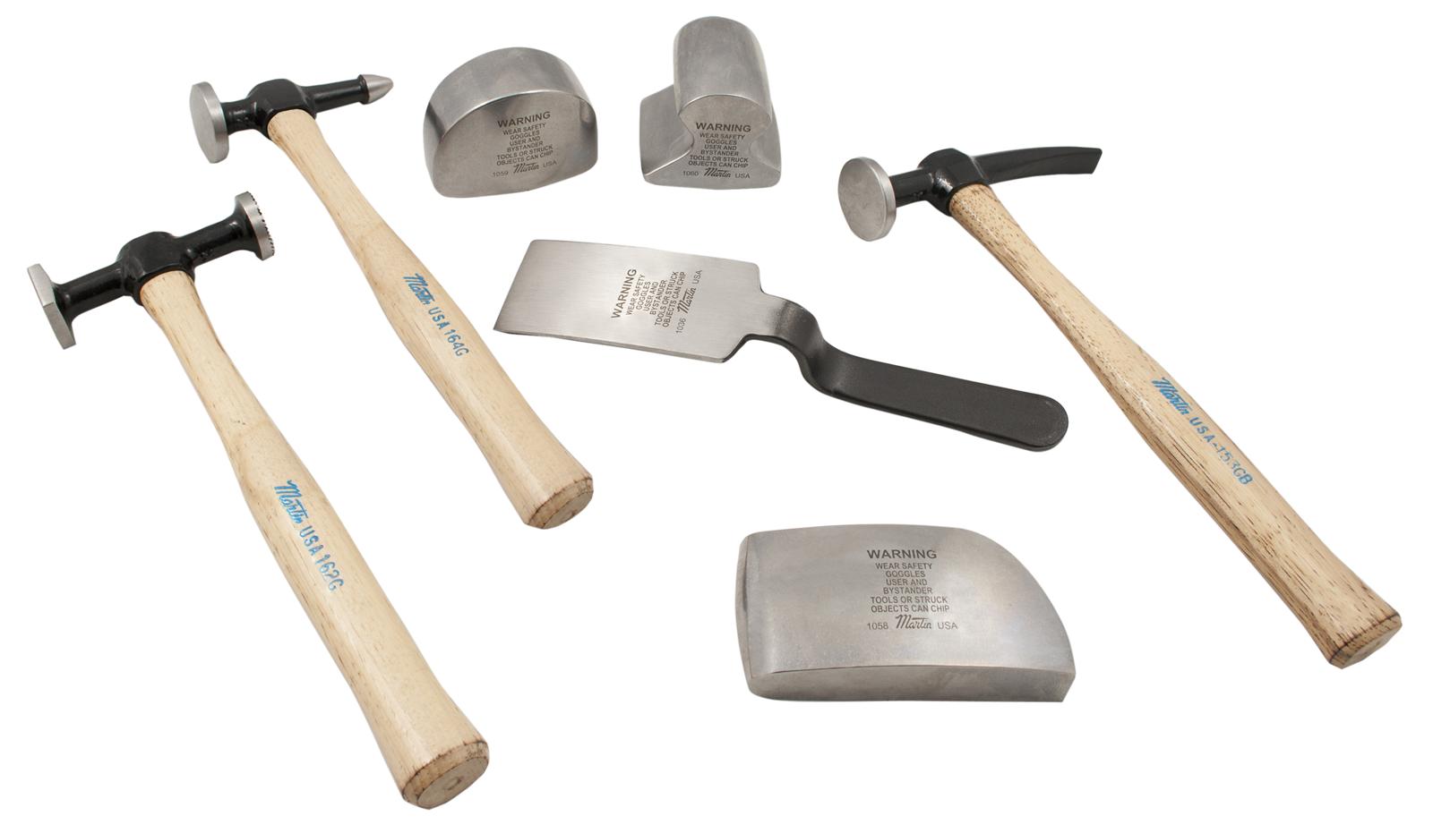

So after yesterday’s attempt at a bit of sheet metal work I realized I need more than a ballpein hammer and scrap steel to be effecitve.
Looking for any suggestions on the basic hammer/dolly to buy for future efforts.
Do I really need a full set or is there a good brand to look at?

It seems like Martin is a reputable brand.
They’re distributed pretty broadly.

My go-to for sheet metal work...
MARTIN TOOLS
Utility Pick Hammer, W/Hickory Handle # 164G
MARTIN TOOLS
General Purpose Dolly

The set would be Part #647K Martin Tools..
I have several of most styles of body hammers and like I said above 99% of the time I grab the Martin #164G and the general purpose dolly.
I read the newer hammers need the face smoothed out and polished before you use them but I haven't bought a new hammer in 30 years so I don't know that as fact. FYI: I keep my go-to hammers smooth and polished anyway so wouldn't be a deal breaker for me if the new ones needed a little touch-up.
