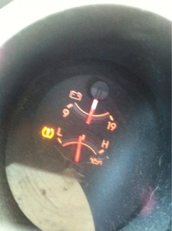

This light is stuck on in my gx470.

Yes, the sensors are battery (lithium) powered. If your TP light is on you have low air in one of your 5 tires. If the light is flashing you have a malfunction IE: bad sensor(s), bad ECU etc.
Is it different than an 07 tundra? The tundra doesn't flash when a sensor goes bad missing. The light stays on.
On the GX, the light flashes if you have a bad / missing sensor. Back in Oct. I parked in my driveway overnight and the light came on in the morning, solid, not flashing. I removed my spare to check the pressure and it was low. I filled it up to 35psi and the light went off. I was lazy and didn't put it back under the GX and a week later the light started flashing. I mounted the spare back and the light went off.
Yesterday my Moms '12 Rav4 TPMS light was on (not blinking). The place she took it took said she needed a new sensor. I told her thats b.s. and to bring it over to my house. I checked it and sure enough her spare was low. I filled it back up and the light went off.
On my my old 1st gen Tundras, solid lit light also meant low tire pressure. I did a quick search and 2nd gen owners said solid lit light meant low tire pressure....I think you're mistaken.
