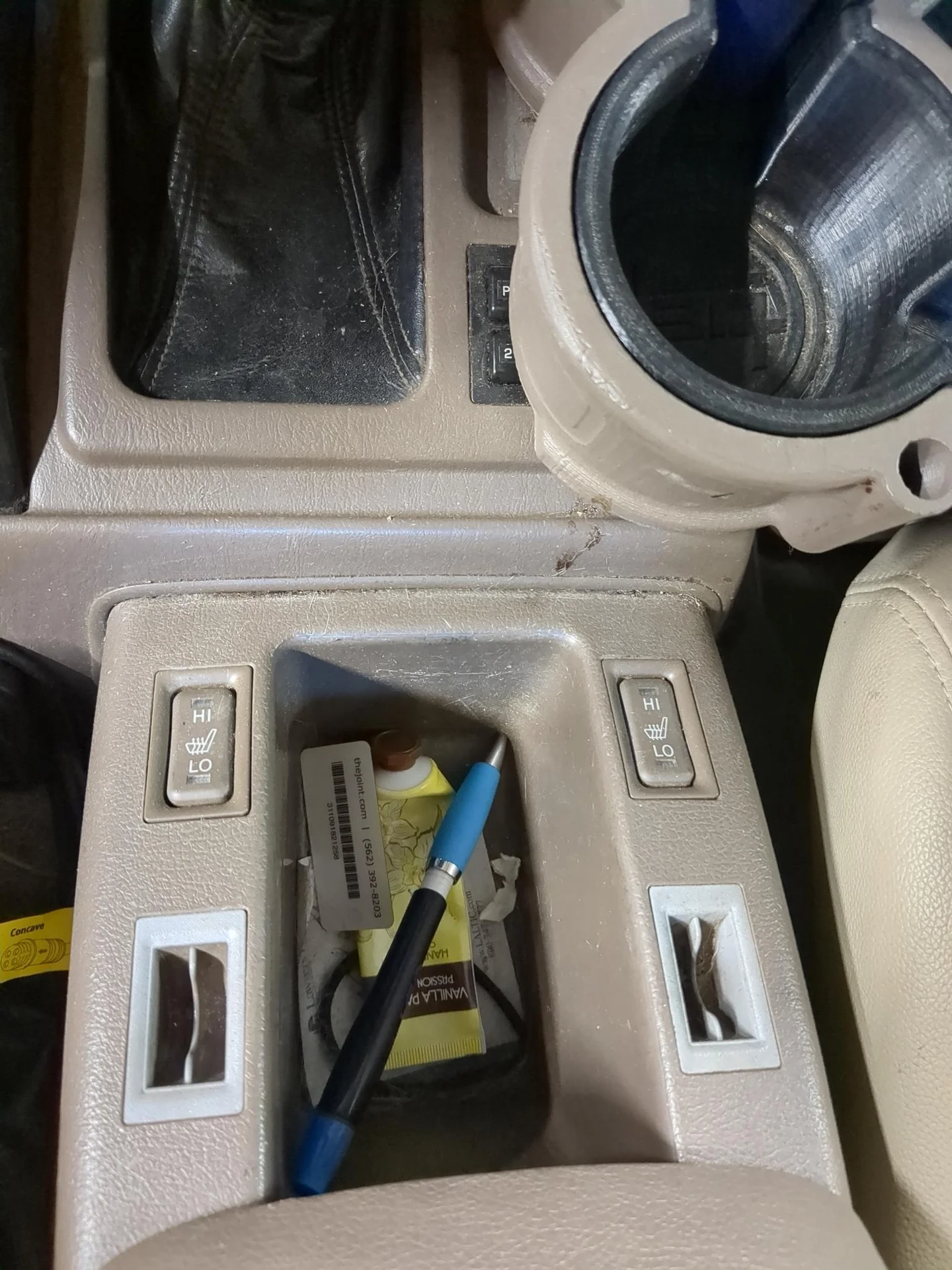

Did you get your heated seats wired up? I just purchased the Vario XXLs and the factory Toyota vertical switches. Was wondering if you used the relays and fuses from the Scheel Mann wiring kit?
album in first post of this thread has pics of how the wiring is set up. with that switch, there was only on/off (chose the low circuit). found the pinout of switch in a thread by the user tagged in that same post.

Digging into this today, Got the new Scheel-manns from Delta VS in, ordered the JDM vertical switches and planning to do some voltage check on the factory seat connector so I order the correct plastic connector housing to go with the Toyota (82998-12330) repair wires.

I already have the switches installed.
