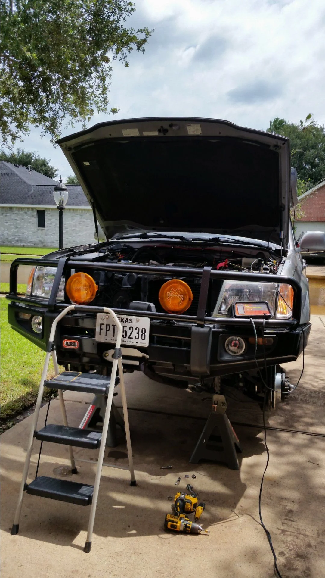

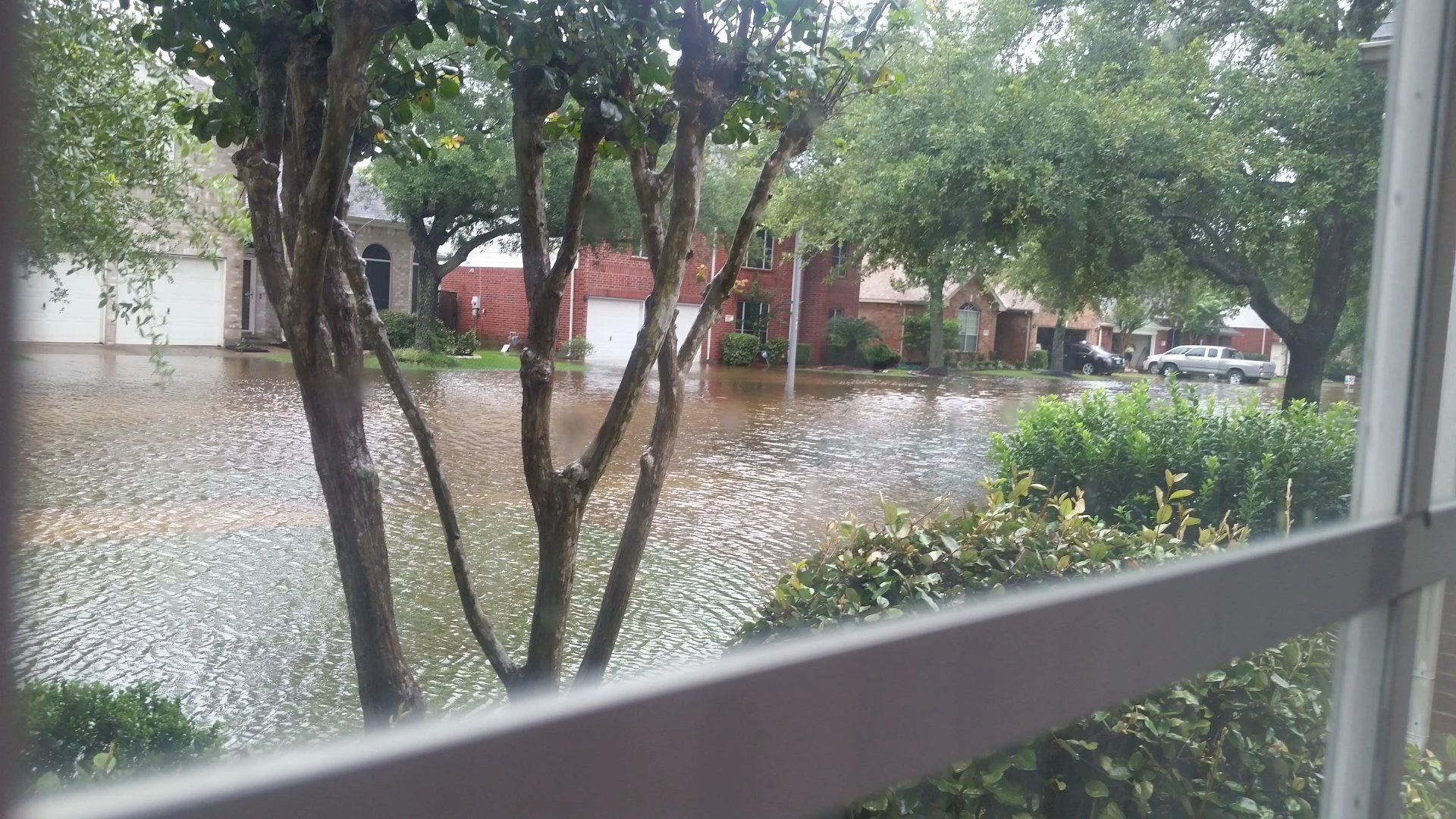

I've been stuck at my house with my family and neighbors for several days because of Harvey. Just before the hurricane hit us I was working on the bearings and didn't get a chance to finish before the floods came. Now the water has receded but we are still sort of trapped because of blocked highways. You can see my street in the background still flooded. We really did get lucky unlike many houstonians. We have never seen water like this... our city really got a beating. I usually wrench to get my mind off things so I had parts laying around waiting to be installed.

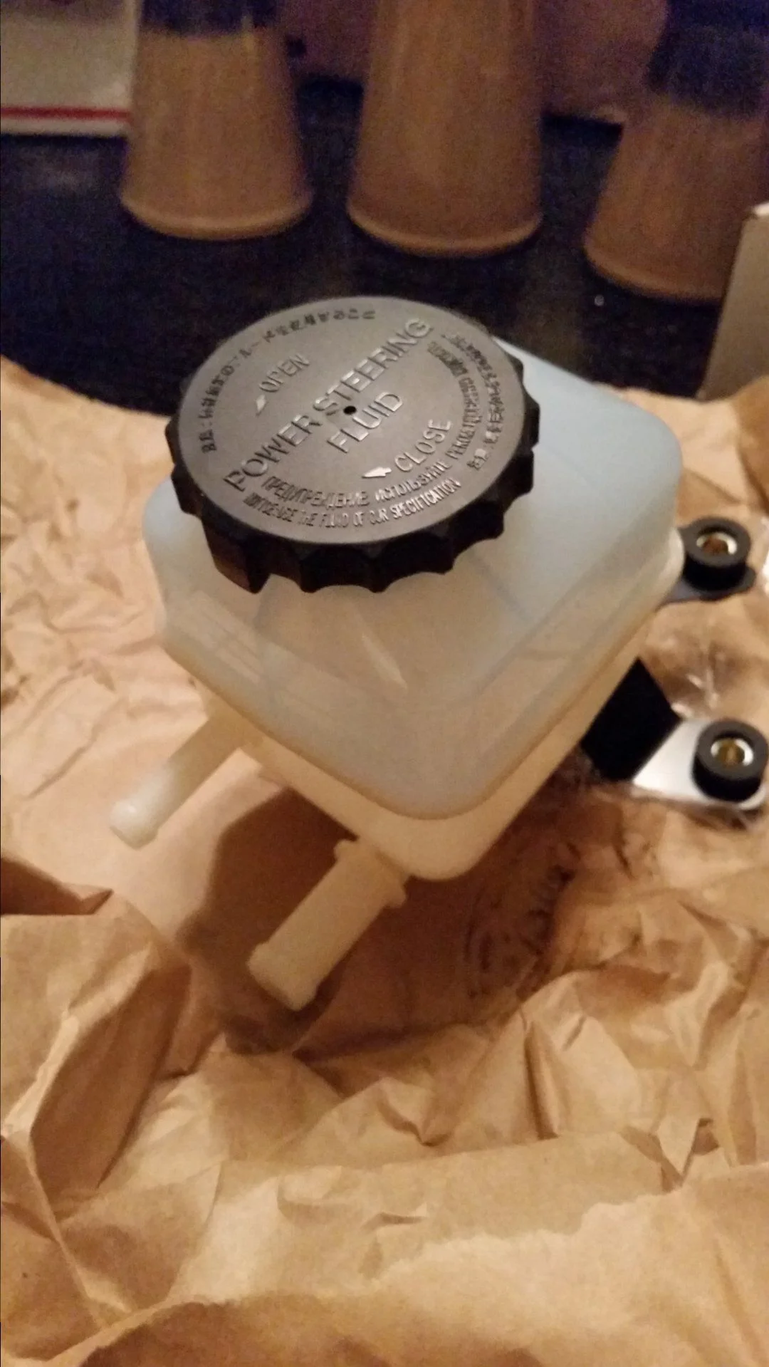

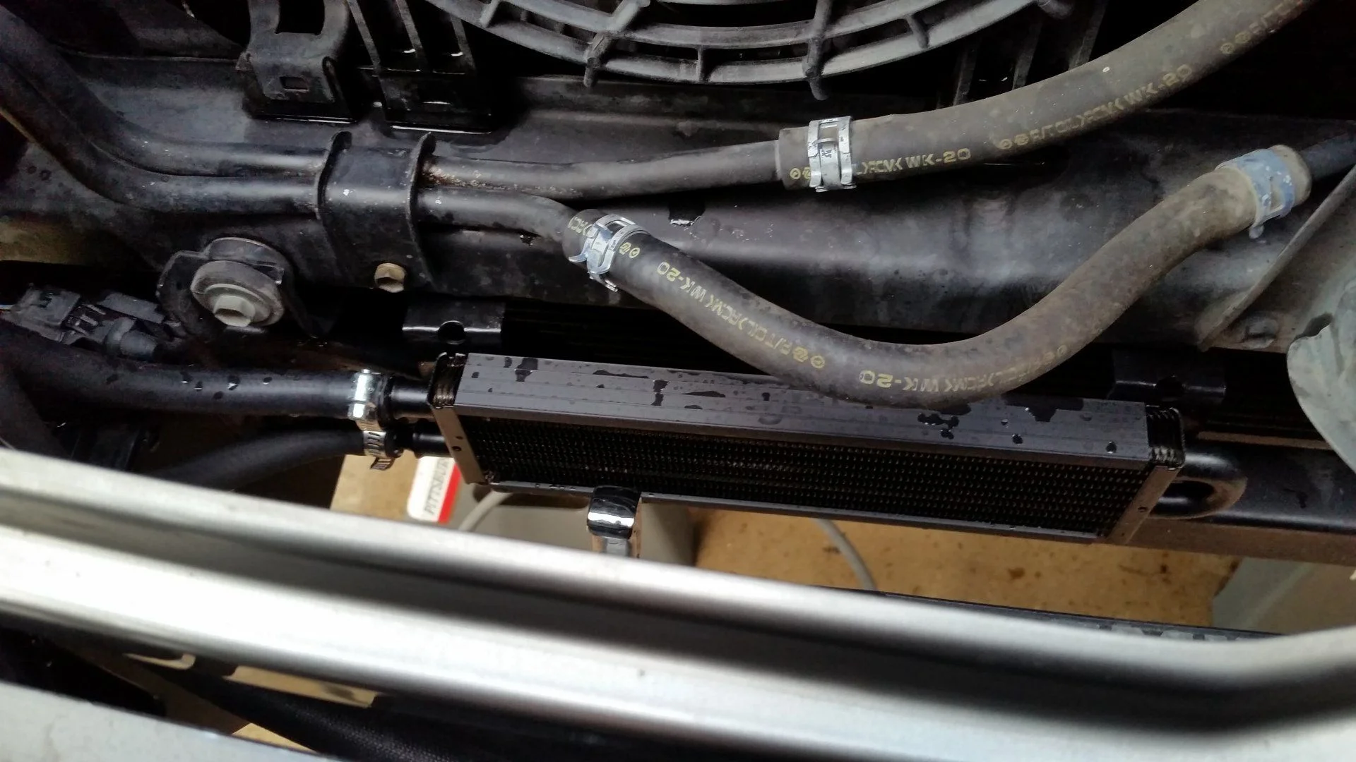

So to get my mind off of the situation I installed a power steering cooler I had and a new inlet and thermostat for the coolant as my old one was pitted and didnt want it to leak. I couldn't finish the truck to get it off the stands because I still need other parts and probably won't be able to for a while.

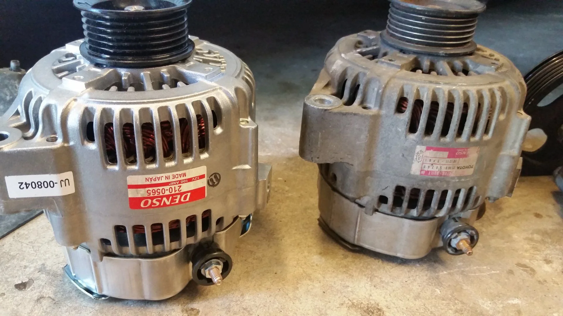

Is that a sequoia unit..??
It looks new, is it a ''rebuild'' one, remanufacture....??
I need one pronto, where did you find such a nice chunk...??
Its the 100 amp stock unit for the landcruiser reman. by Denso. I forgot where I got it from but a lot of places have them.

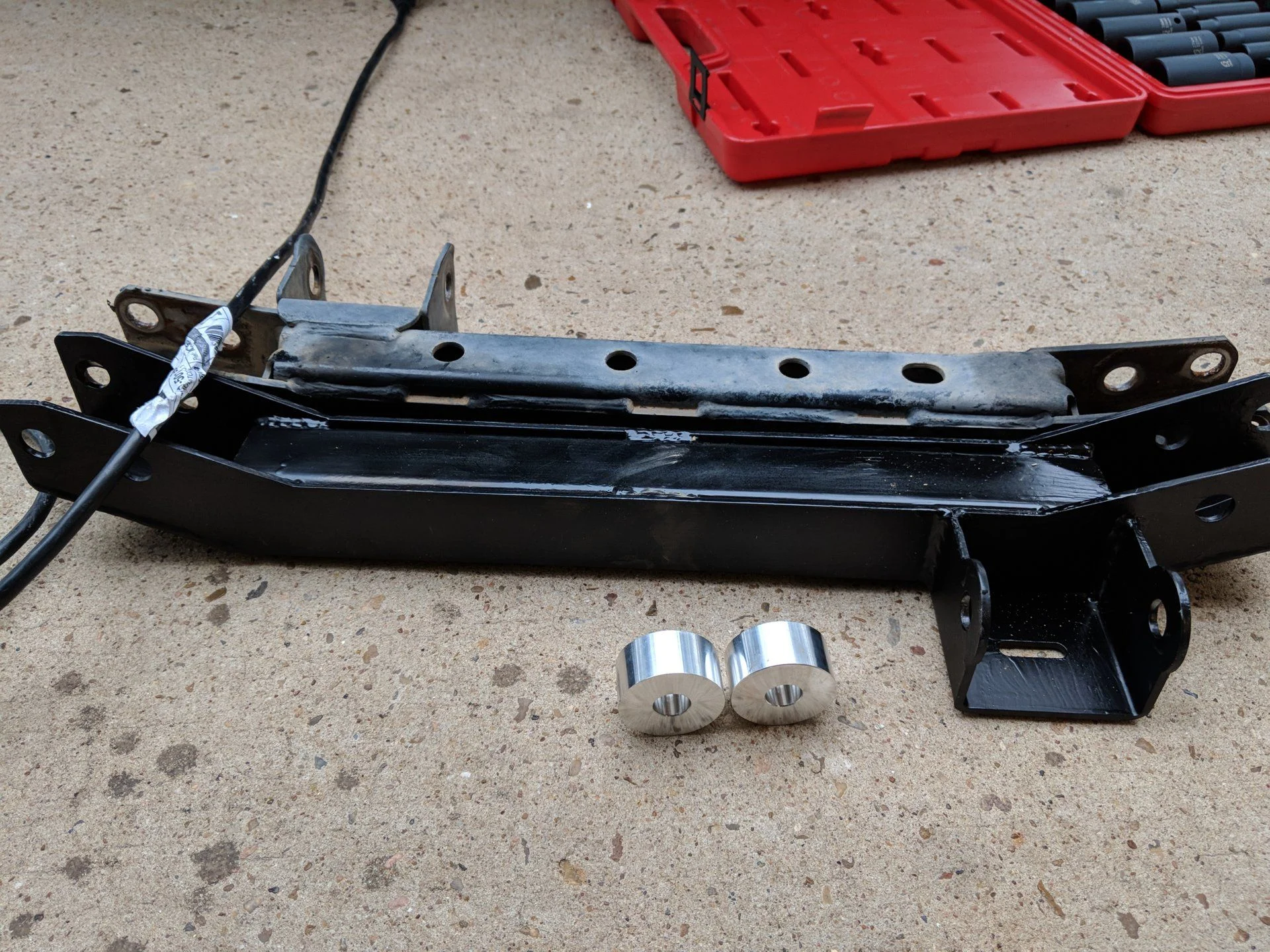

  • Trail Tailor diff drop -Although I didn't need it..I had to have either this or spacers to fit my BIOR skids and I like Jason :). If you are wondering why I "need" it for the skids. The 100 series skids from BIOR have a Dip at the diff bracket well over an inch and with the stock bracket you need big spacers, with a diff drop bracket you don't need as much spacers.

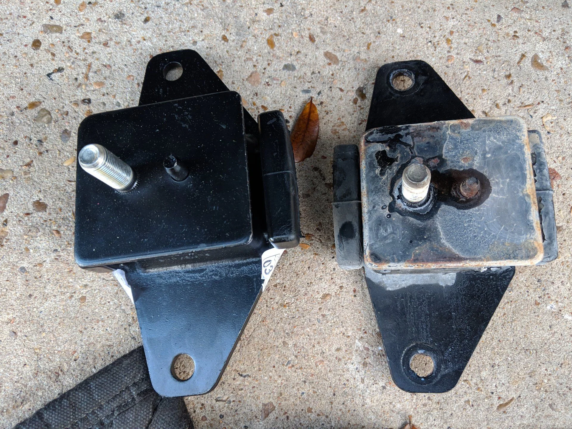

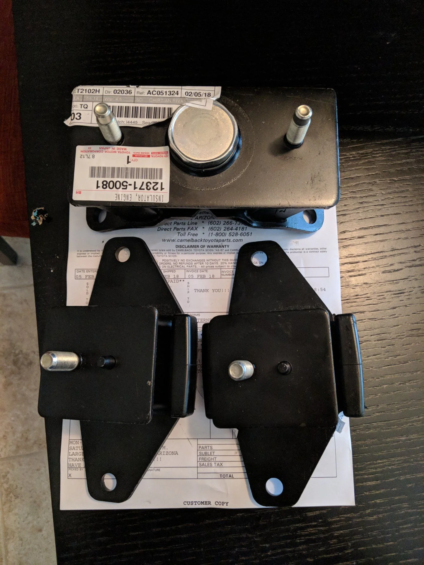

This week I changed the engine mounts and transfer case mounts. At 80k the old mounts looked ok but the rubber was definitely hardened compared to the new ones. Also the rubber on the old ones had separated from the metal on one side. The difference was noted in engine noise and vibration.
