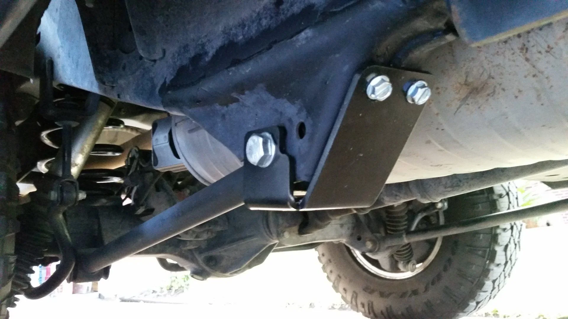

This weekend after having these skids for a while now, I finally put them on. Love this guy --> @reevesci these things are awesome.

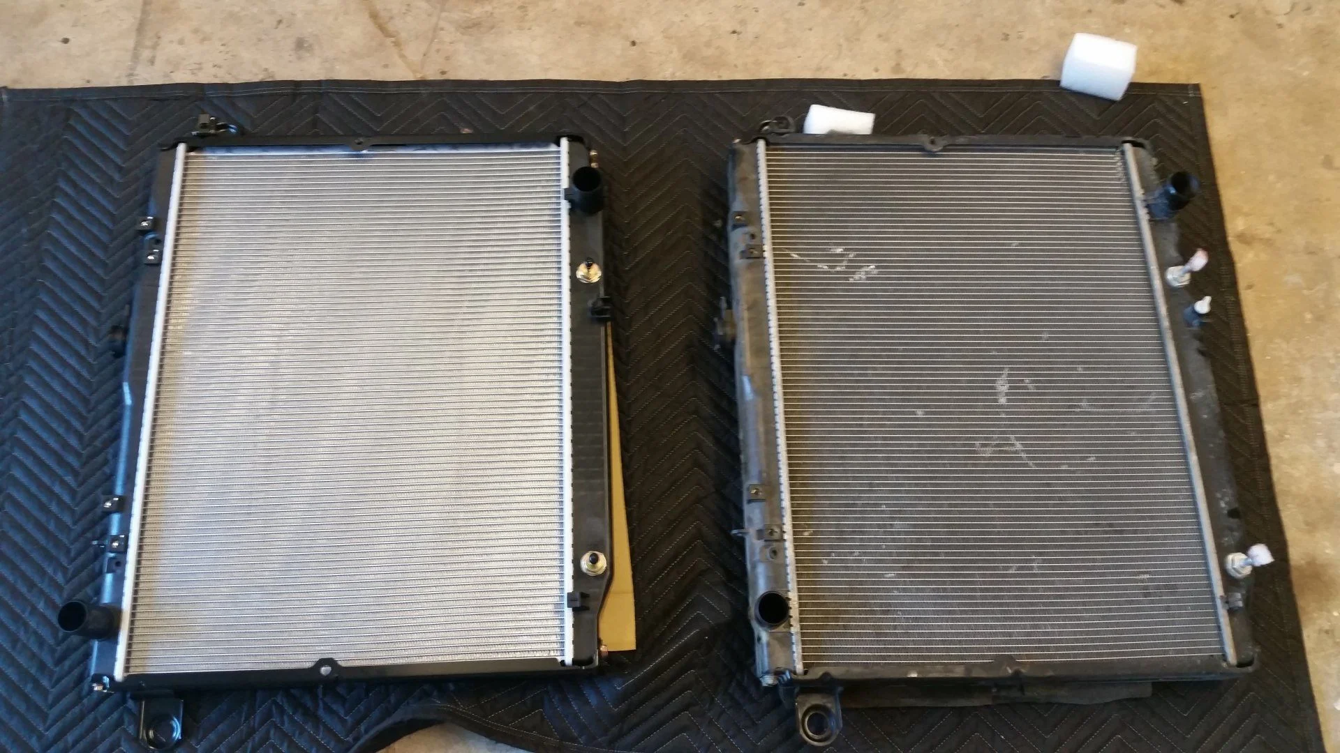

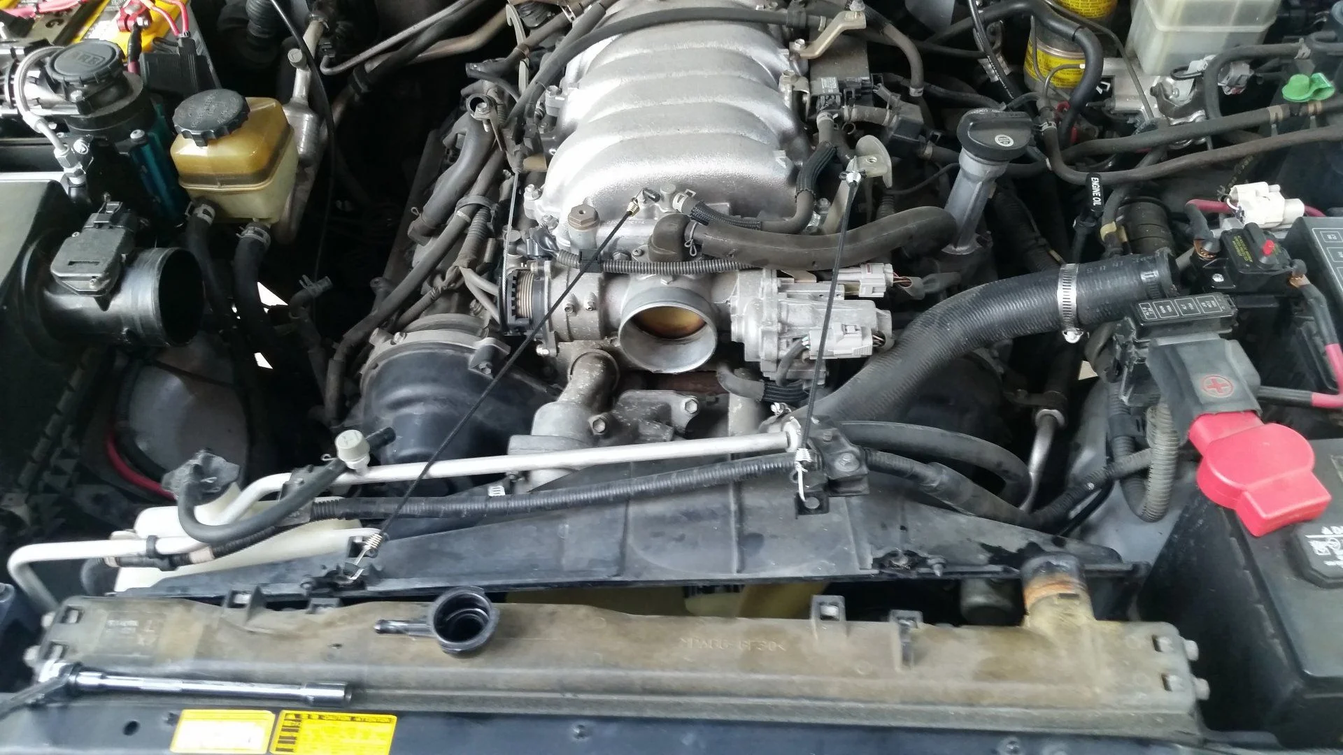

Exitement of going to HIH7 is building up. I had two things I wanted to do to the hundy before HIH7. New radiator to replace the browning 15 year old OEM and the steel brake lines. Yesterday I got the new Denso radiator installed. Denso is identical to oem except 1-2 lbs lighter. Quality is good and Im happy with it. Didnt remove shroud, relatively easy install no issues. Biggest headache was receiving an undamaged radiator from amazon. 3rd try was the charm.

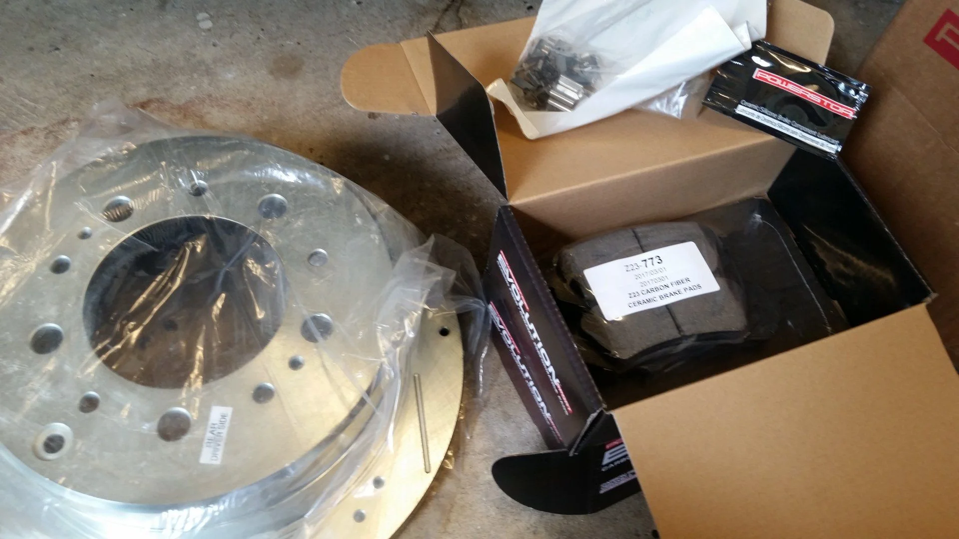

For anyone prepping your rig for this event its true that stock cruisers can handle everything fine, however I recommend that your primary concern and if you only had one thing to look over before this trip or had the funds to upgrade is your BRAKES!!!!
I don't know why I overlooked the importance of this and didn't overhaul these before I left my home town, I was insecure about them the whole time because I didn't look over them before I left.
There was definitively instances on the trail where my brakes were tested of their full capability and I was insecure of it. Now back home here is whats happening.

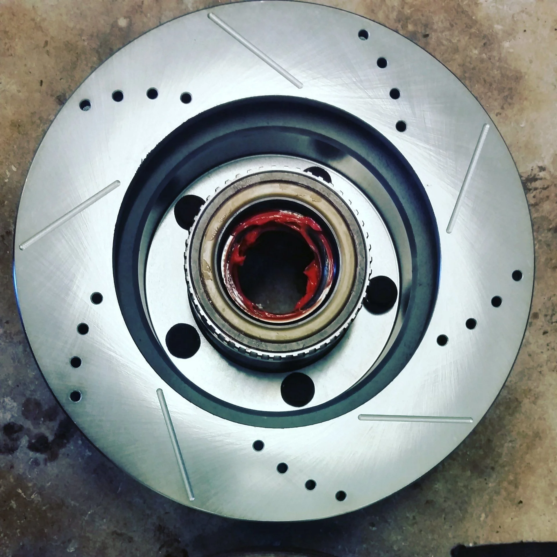

Ordered:
  1. Power Stop vented discs all the way around
  2. Power Stop ceramic carbon fiber pads
  3. Slee Stainless braided lines
  4. 2- rear metal brake lines

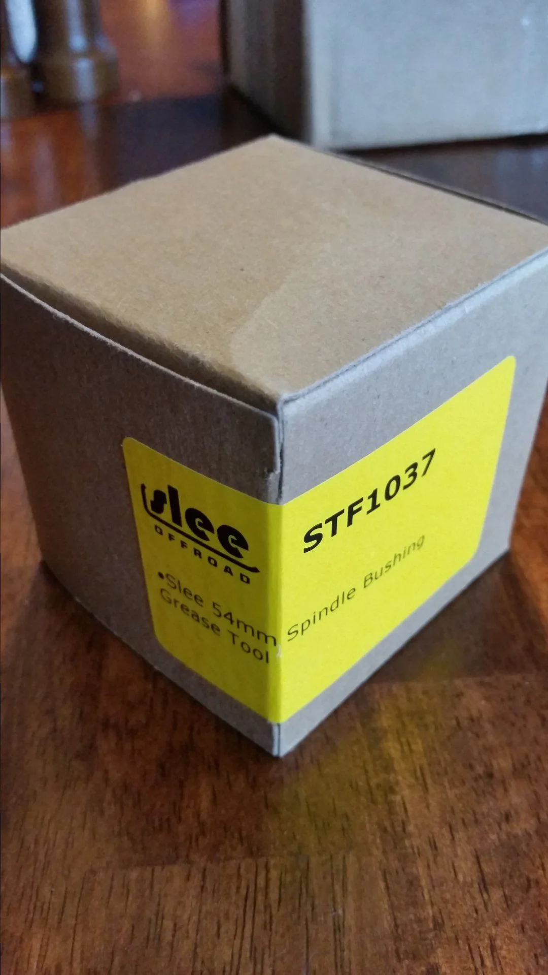

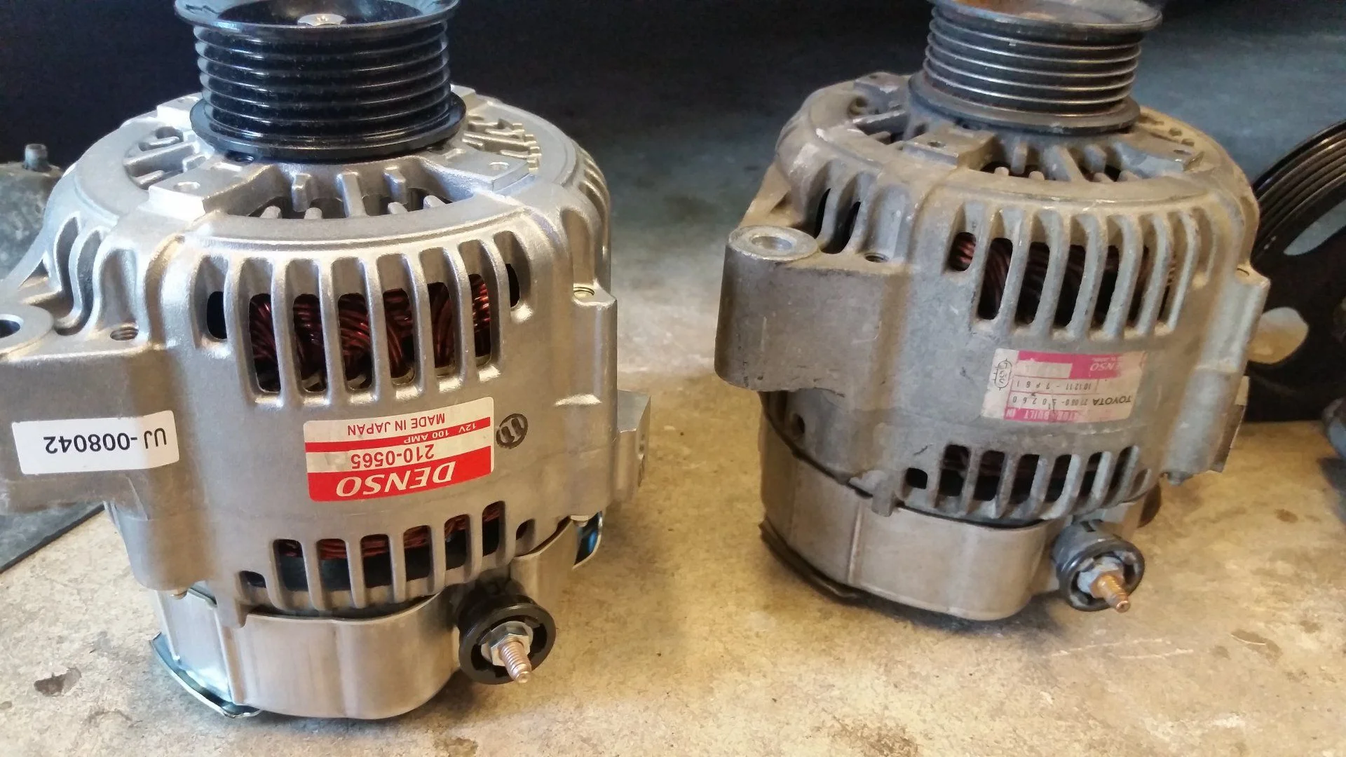

There was two folks with failed alternators at the event so some preventive maintenance ordered:
  1. Denso 100 amp alternator
  2. New Toyota OEM Power Steering Pump
  3. New Toyota OEM Power Steering Reservoir
  4. New Sungsong Hi Low pressure Power Steering hoses
  5. Crusier Outfitter bearing kit
  6. Slee bearing grease tool
Lots of work ahead!

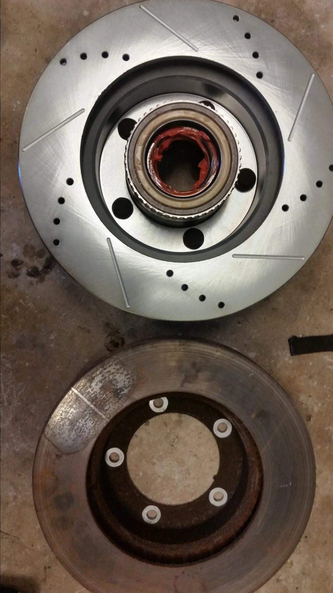

I did the power stops and Slee lines in the spring and really like the modulation and stopping I have now. Good luck with your brakes.

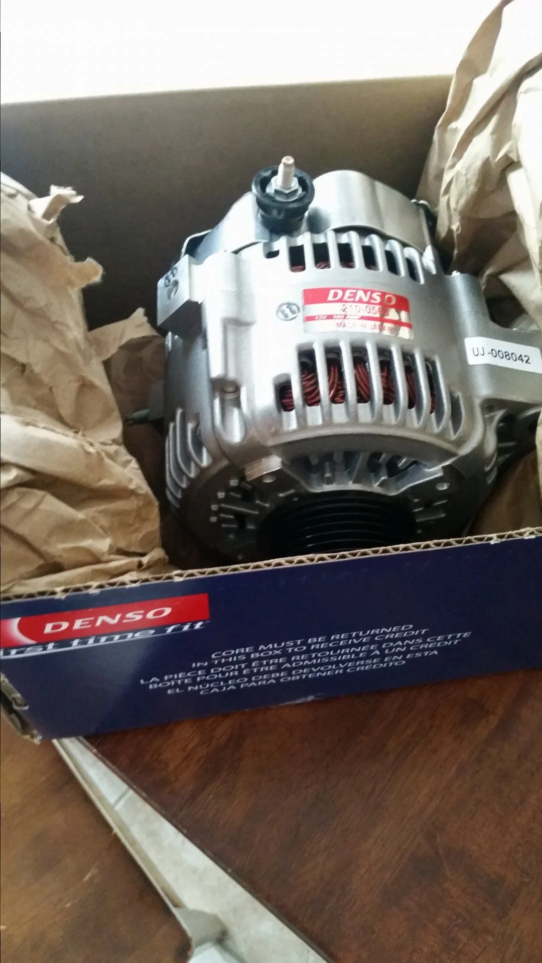

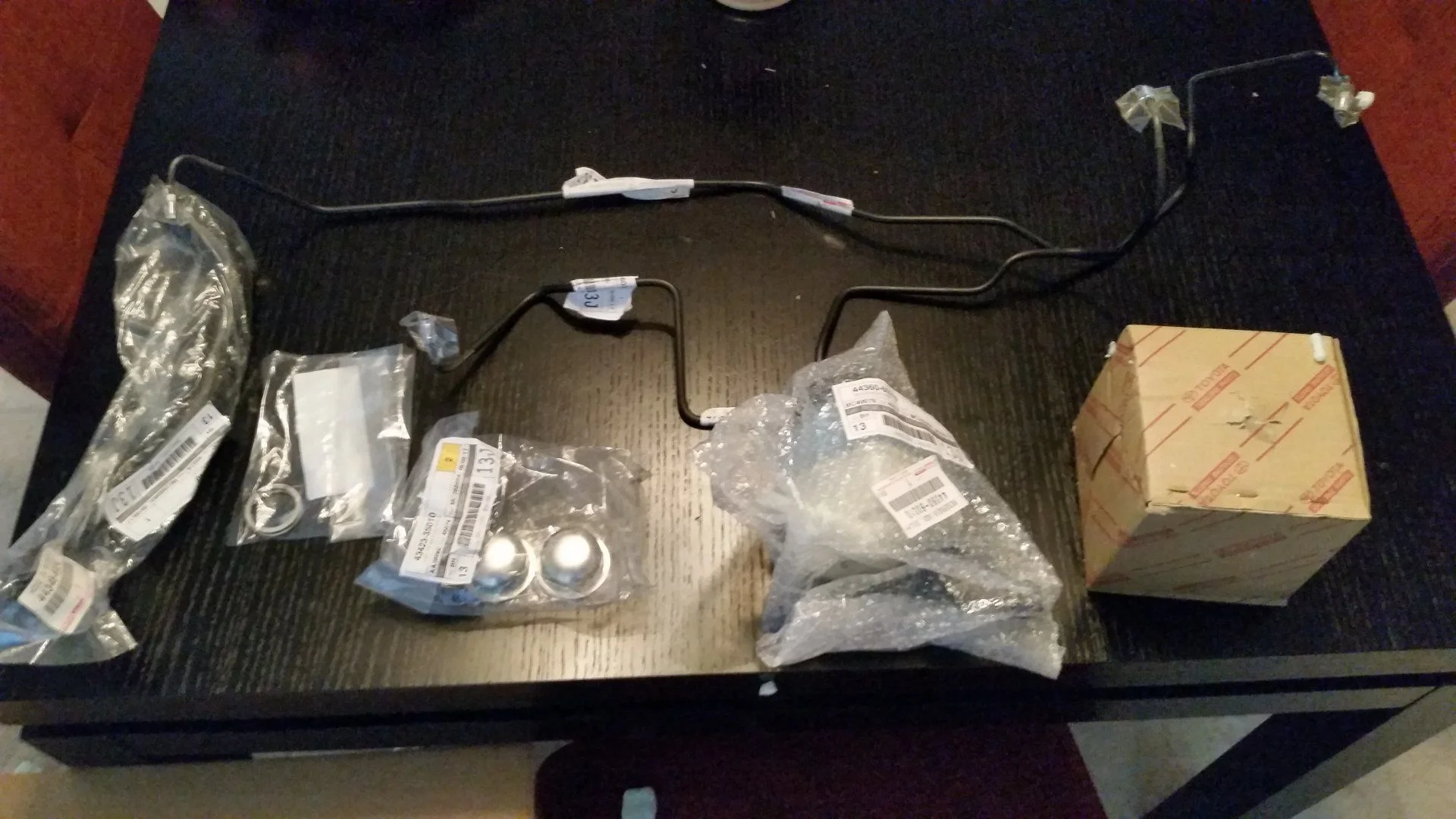

Parts in
And more .....
And more...
And more..
Some cleaning and packing

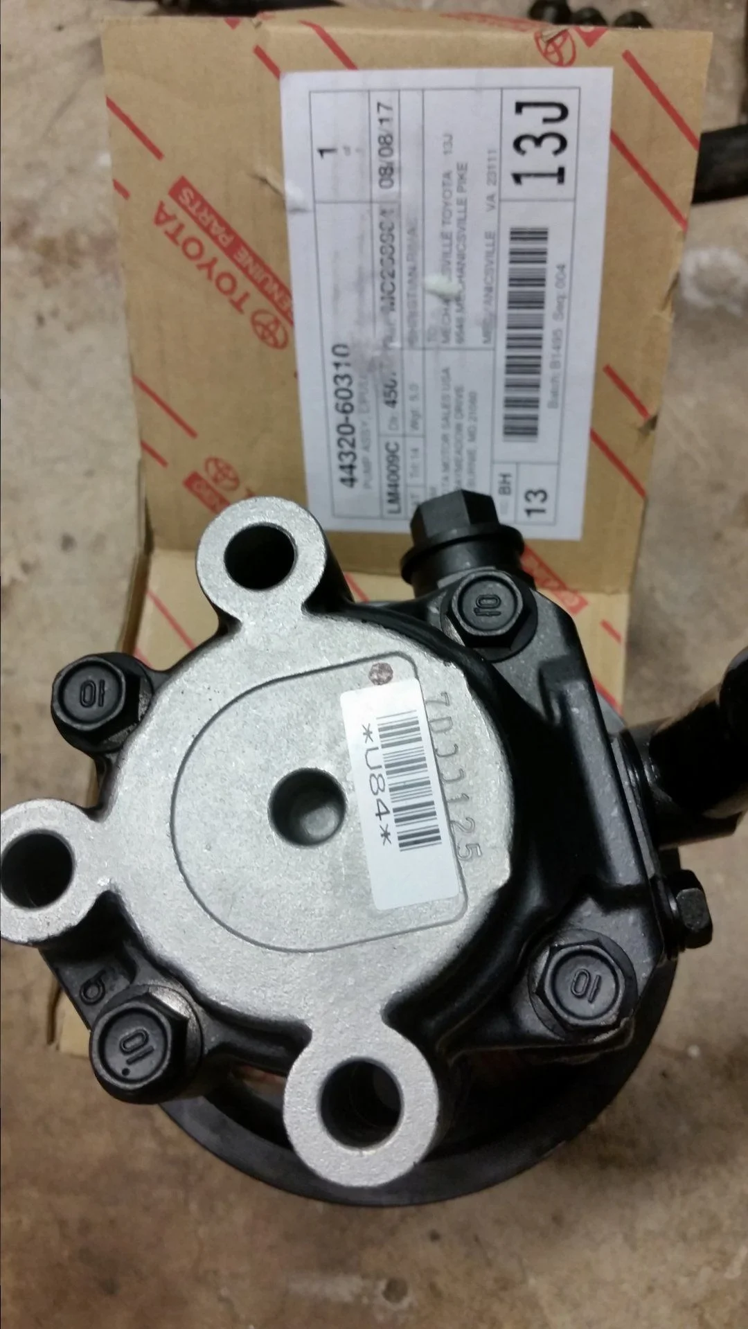

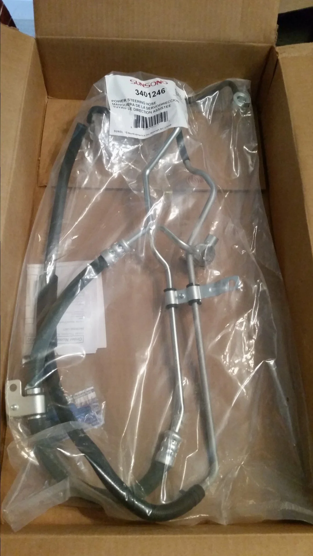

How come are you replacing the power steering pump?

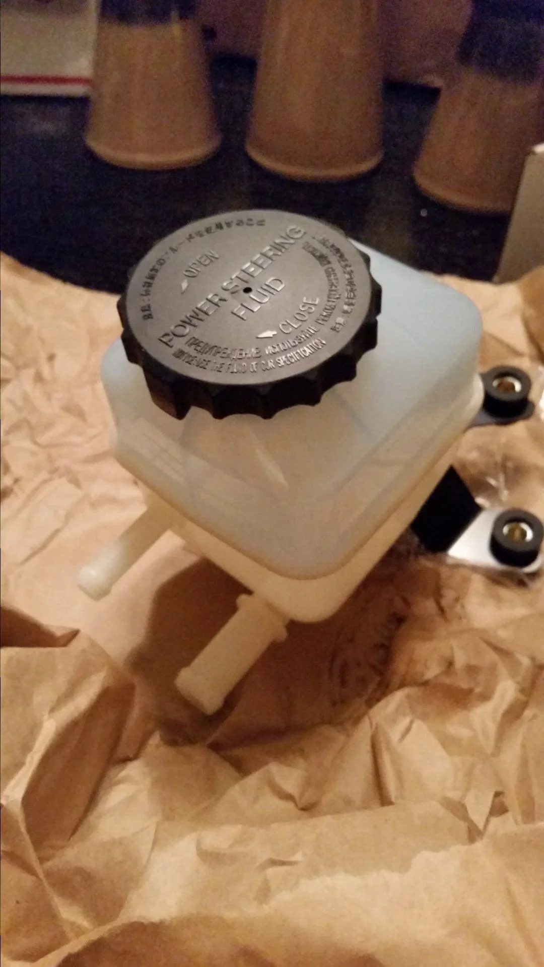

The pump had started a faint winding noise and I had been limping the pump with lucas oil for sometime. I also didn't want to mess with rebuilding the pump. Pretty much ordered the entire system except rack... hoses even new reservoir as it was showing spider cracks and looking brittle.

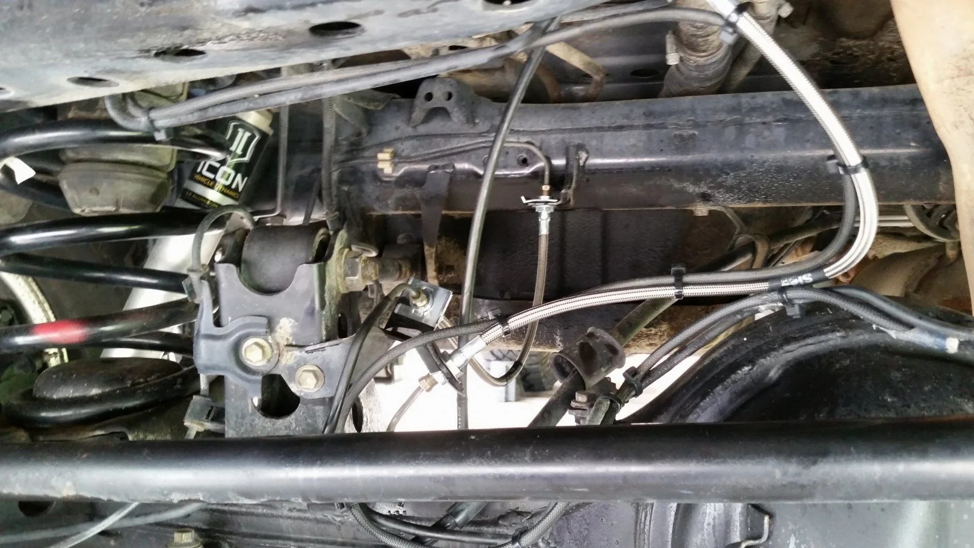

Out with the old in with the new
Lines and alt installed
