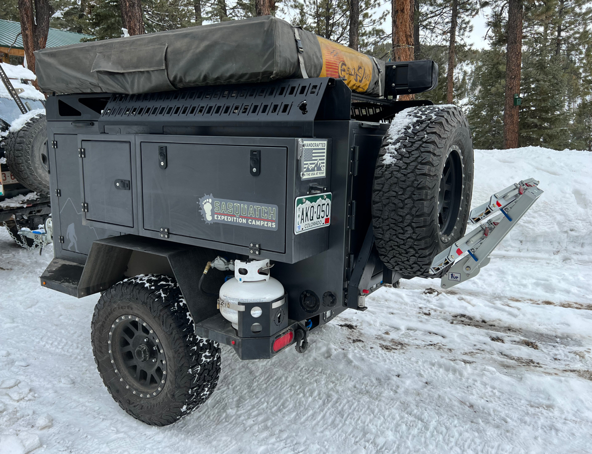

I got a new trailer and figured I'd post up. It's the "Smuggler" model from Sasquatch Expedition Campers out of Silverton CO. All aluminum construction. Dry weight is about 1600 lbs witth the awning and RTT. The Smuggler | Sasquatch Expedition Campers - https://www.sasquatch-campers.com/smuggler
Ask any questions you have. I'll get some more photos posted but most of their marketing photos are of this very trailer.. Working on my modification punch list for the winter.
Right now it includes:
Solar panels and controller.
PVC Fishing Rod Storage tube.
Power supply for RTT and Awning lighting
Bike rack for the rear
Eezi-Awn shower inclosure for under RTT
Awning walls from 23Zero
Jerry Can Mounts - initial thought is on top of nose box.

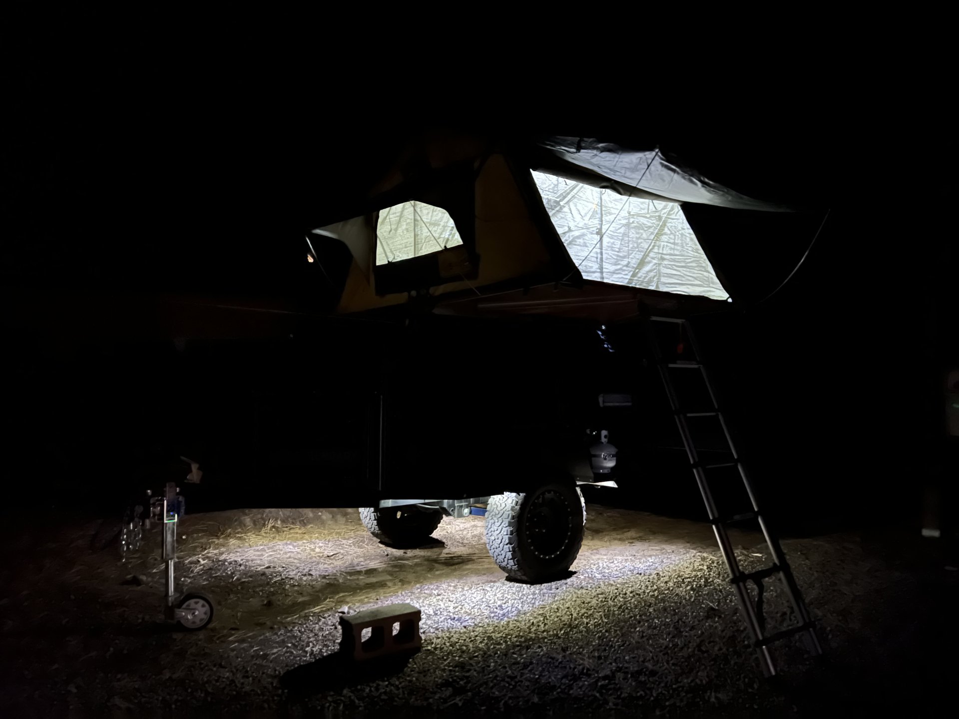

Trying to get good shots of the camper deployed on my driveway has been hard. Between other vehicles and shadows cast by the trees. But here you go.
Wife has Covid so I’ve been sleeping out here a couple nights. So night shots.
Some others.

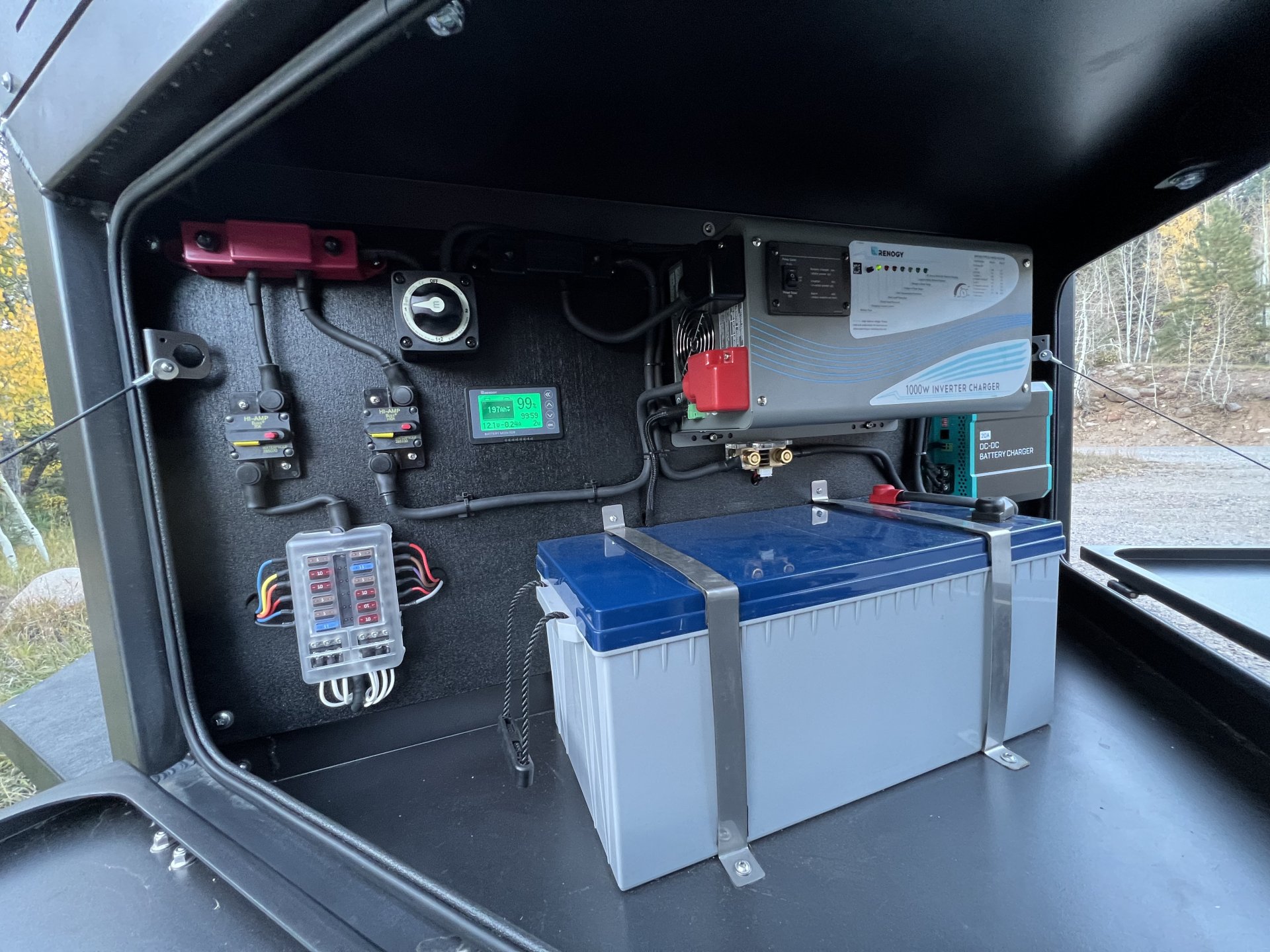

Electronics in nose box

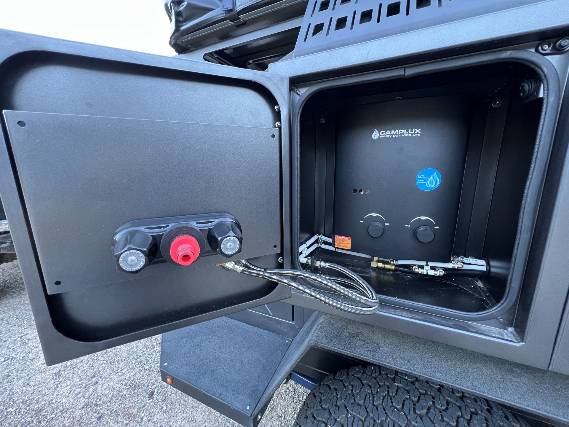

On demand hot water for Kitchen sink and shower

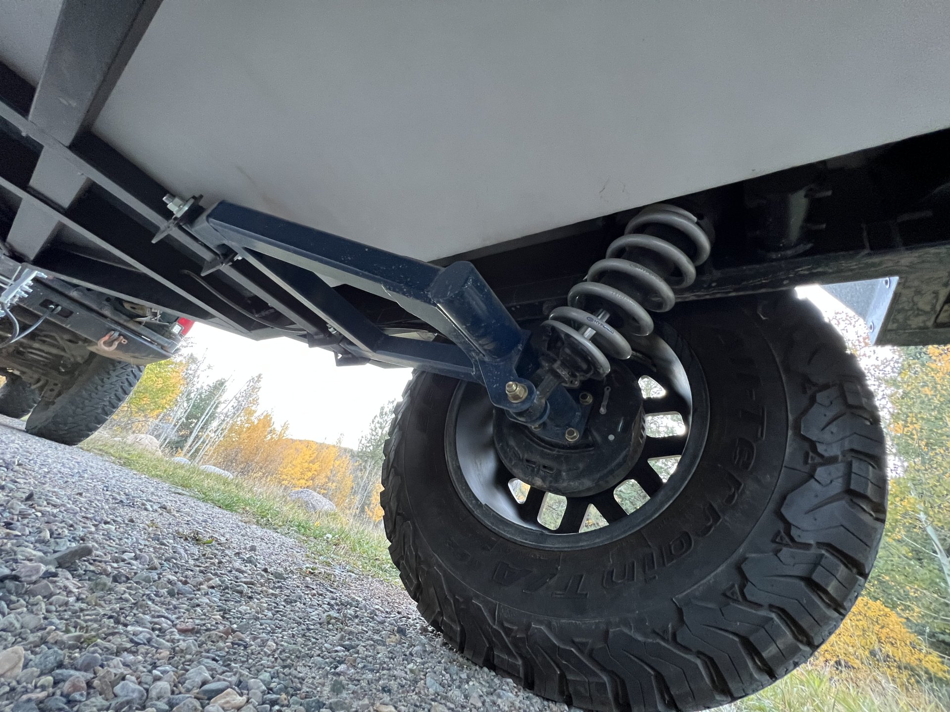

Independent suspension
I'll be interested to hear your long term appraisal of the independent suspension.
As well thought out as the rest of the trailer seems to be I'm a bit surprised at this, but I suspect that the battery might want some cleats at each end to keep it from sliding back and forth. Looks a bit like an after thought.

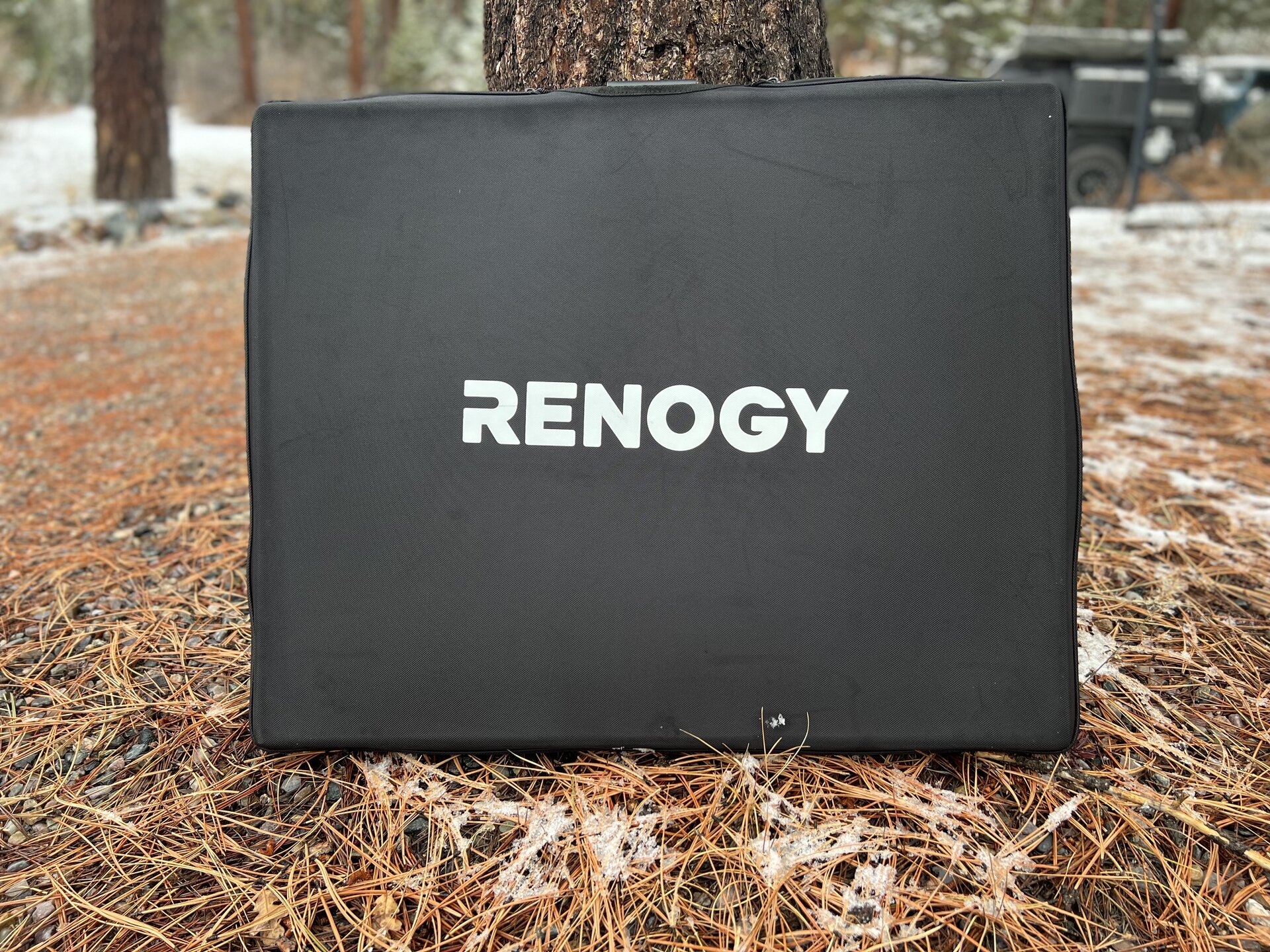

Thanks to Cyber Monday a 200w suitcase style solar panel has been sourced. As well as a solar controller. Wiring supplies were not on sale so I’ll source those later and write a post on the controller install at that time. When not in use I’ll store the panels in the main cargo compartment.
You are the 2nd one to comment on that. It feels very well secured as is with some rubber pads under the battery and strap but some additional stabilization can’t hurt. I’ll do that over the winter. Sasquatch has even offered to handle that for me.

Bike rack sourced. 1Up HD model. Nothing to add, everyone who owns bikes knows what it is. Only downside is that it will not fold into the full vertical storage position. It contacts the spare tire. If the Sasquatch receiver was 1-2” longer that issue would be resolved along with making installation easier. The rack contacts the spare but I can get the receiver locking pin in.
Could but then the probably wouldn’t engage the receiver enough. The aluminum swingout has a steel receiver sleeve inside the aluminum square tube. I think I’ll pull that out and source a longer sleeve to extend it out a little. Then drill two new holes. One to secure the sleeve and one for the hitch pin that holds the rack.
I guessed that it couldn't be simple, I just have no experience with those racks so no idea how complex it might be.
If you needed a lot more then a hitch extender could be used, but even the shortest of those is going to push the rack way out there!
