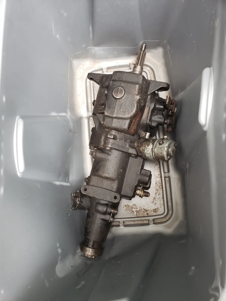

Anyone going North through SLC on the way home that could deliver something for me? Would be in North Ogden, about 2 miles off of I15. It's a transmission - but not a big one! PM me if we can work something out!
Was gonna rebuild it for a family member but just haven't had the time so he's gonna do it locally. It's a column shift 3 speed + "automatic" OD for a 56 Chevy that I found locally for him.

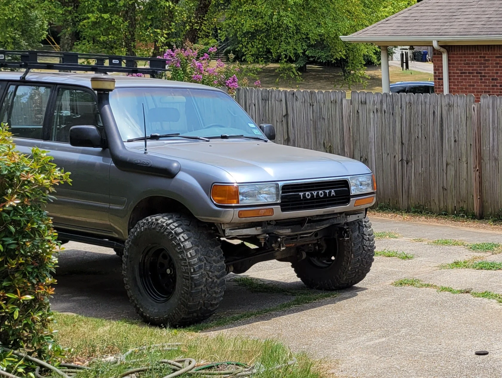

Too much too do and not enough time on both of my 60s. Still not sure which to take ... What do you think @Manitou Decline?
1. the one that's falling apart around me, but I daily drive it so I know the issues and turst it more.. Badly leaking tire (all the tires are in garbage condition), "snap" noise from the front left when going slow around corners, no power steering in over a year, bleeding t-case rear output seal (and leaks from about 8 other places too), pinhole radiator leak, mysterious disappearance of coolant more than what a pinhole leak would cause. Oh yeah, and the frame rot. This truck has the roof rack, front winch bumper, and rear swing arm bumper.
2. the one in nicer shape with 120k miles that I haven't gotten driving yet, and don't know what issues will pop up when I get there. I have a lot of parts for this truck so there's that. Manifolds will be redone, carb rebuilt, all new vac lines, brake work (new brake hoses, calipers, front pads, and fluid flush), new fluids for everything. 33s and front shackle reversal done ages ago. Status of diffs, transmission, transfer case unknown, though knuckles look pretty decent, not a lot of leakage or nastiness. It sat from 2018 until now and compression doesn't seem great, maybe because I need to run it and loosen things up. If I have enough time I can swap the swing arm rear bumper and roof rack over and ***n send it. KO2s were purchased by PO a week before he garaged this thing so they're very mint with no cracking.

Sounds like Option 2 is the choice and where to put the focus. Take it out to Slaughter House and see how it does. You know what the expect on this trip, so put it through a good test. The reverse shackles will make a much better ride off road.
Option 1 has been tested and works but that coolant issue is a big concern. Don't want to heading up Corkscrew and have the engine overheat (a lesson I learned). Spend a day and try to figure out where the coolant is going. If you can't figure it out, Option 2 for sure.

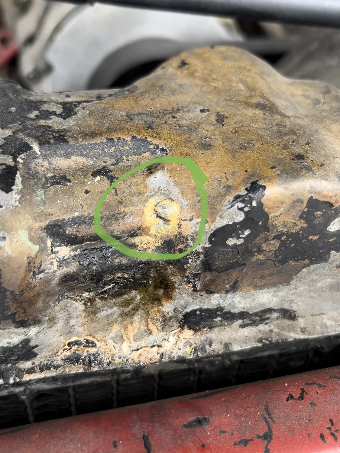

Coolant has been disappearing for a while in the daily driver - 4-5 months. No milkshake in the oil, no floaty oil sheen under the radiator cap, no visible leaks (at least not coolant anyway, we won't talk about the rear main or oil pan or t-case). I'm wondering if it was the pinhole all along and I just didn't see it until yesterday. But still, that's my BIGGEST concern with that truck. That's the truck I took last year.

Yeah those pin holes will push out some coolant pretty quick with 12 psi pushing it. If it is in the seam and not the fins, you can pull the rad and try soldering it. Hell I might even have one laying around the shop.
IT's right on top, not on a seem. There's a very small dent there (probably my fault). I epoxied it for now and it's held all day. I'm betting I could solder it up myself with a torch.
Out of respect for the neighbors, don't go full plumper and hang crack. Do go half plumper and solder it up like copper piping.

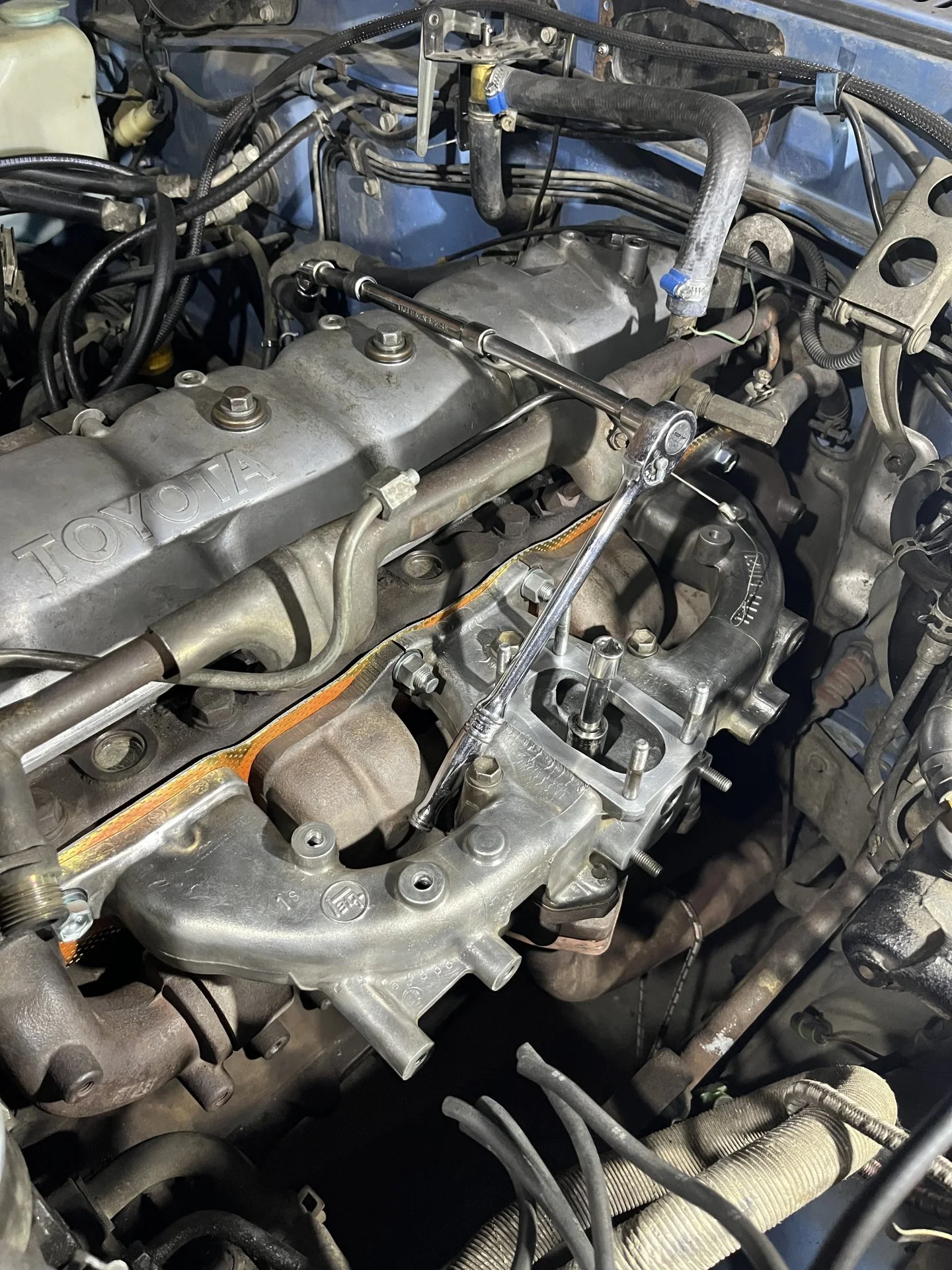

So far so good on the pinhole - epoxy has held dry all day. I appreciate it though. In the meantime…. Manifolds are on truck #2:
Truck is humming along. Radio works. AC is kickin'. Punch list is whittling away. Getting excited. Looking fwd to catching up with the SAS fam.
