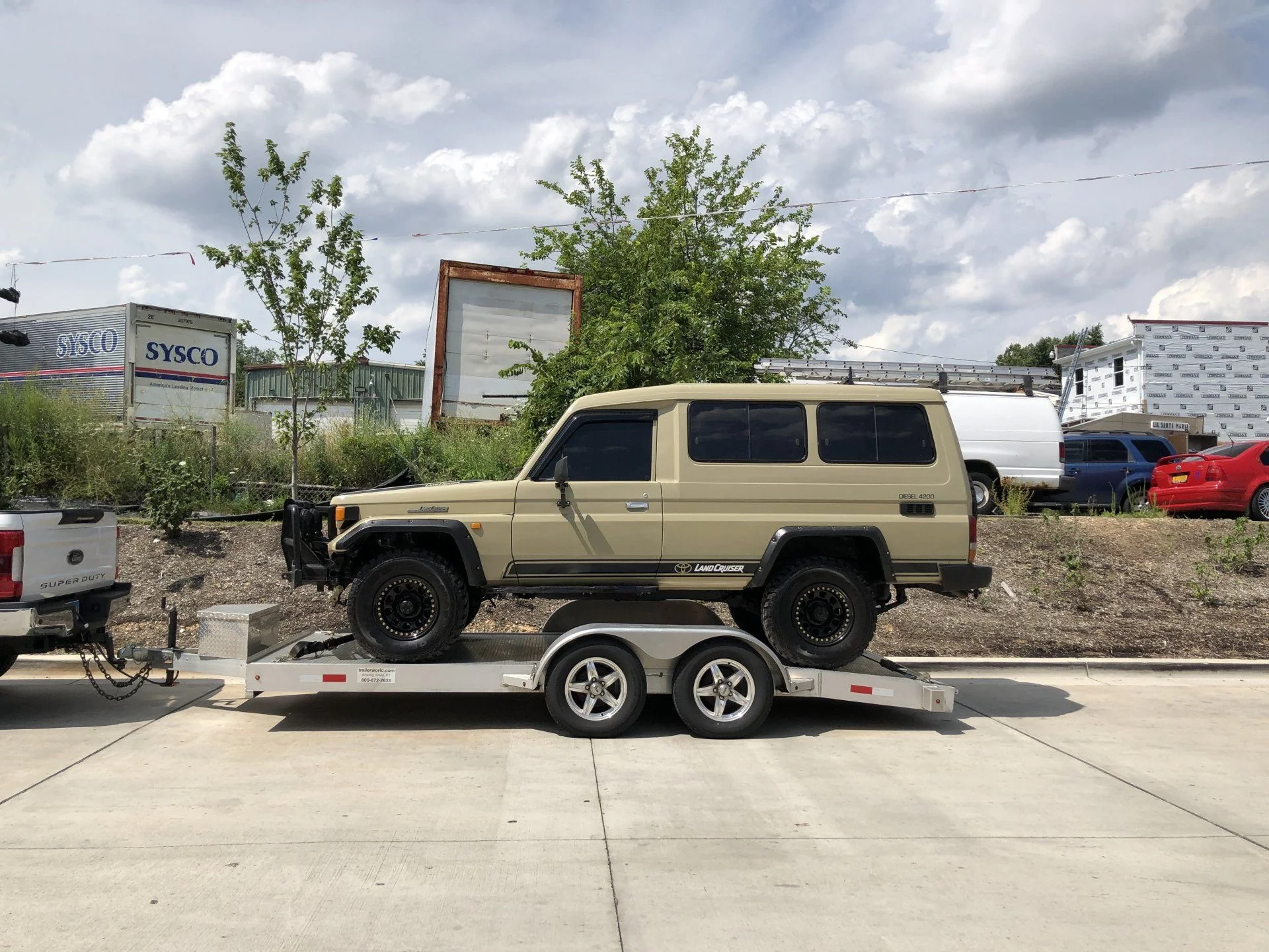

First time seeing it at the port. (note 60 series firetruck in the back)
Loaded up and ready for the trip home

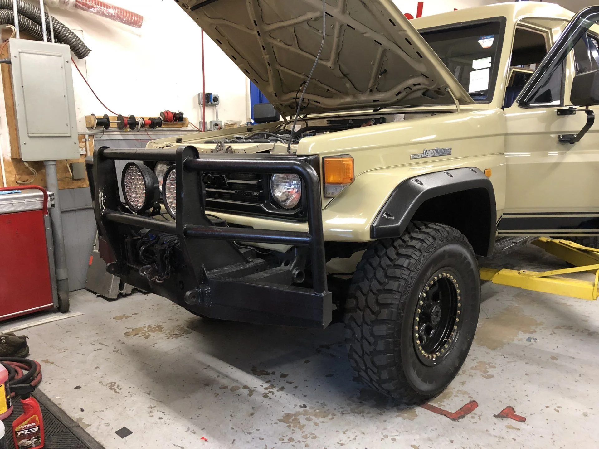

First order of business was to remove the PTO winch with front bumper and clean everything up a bit.
The bumper and winch weighed just about 250lbs!

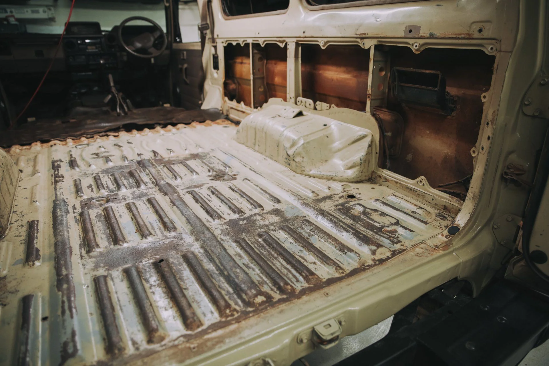

After a day of driving around and getting a feel for the RHD + manual transmission it was time to start digging into the interior to get it ready for paint and sound deadening. This is where I'm currently at on the project. I should be priming the floor and pulling the side glass this weekend. Unfortunately I'll be out of town for a couple weeks and then have to pick back up where I left off.

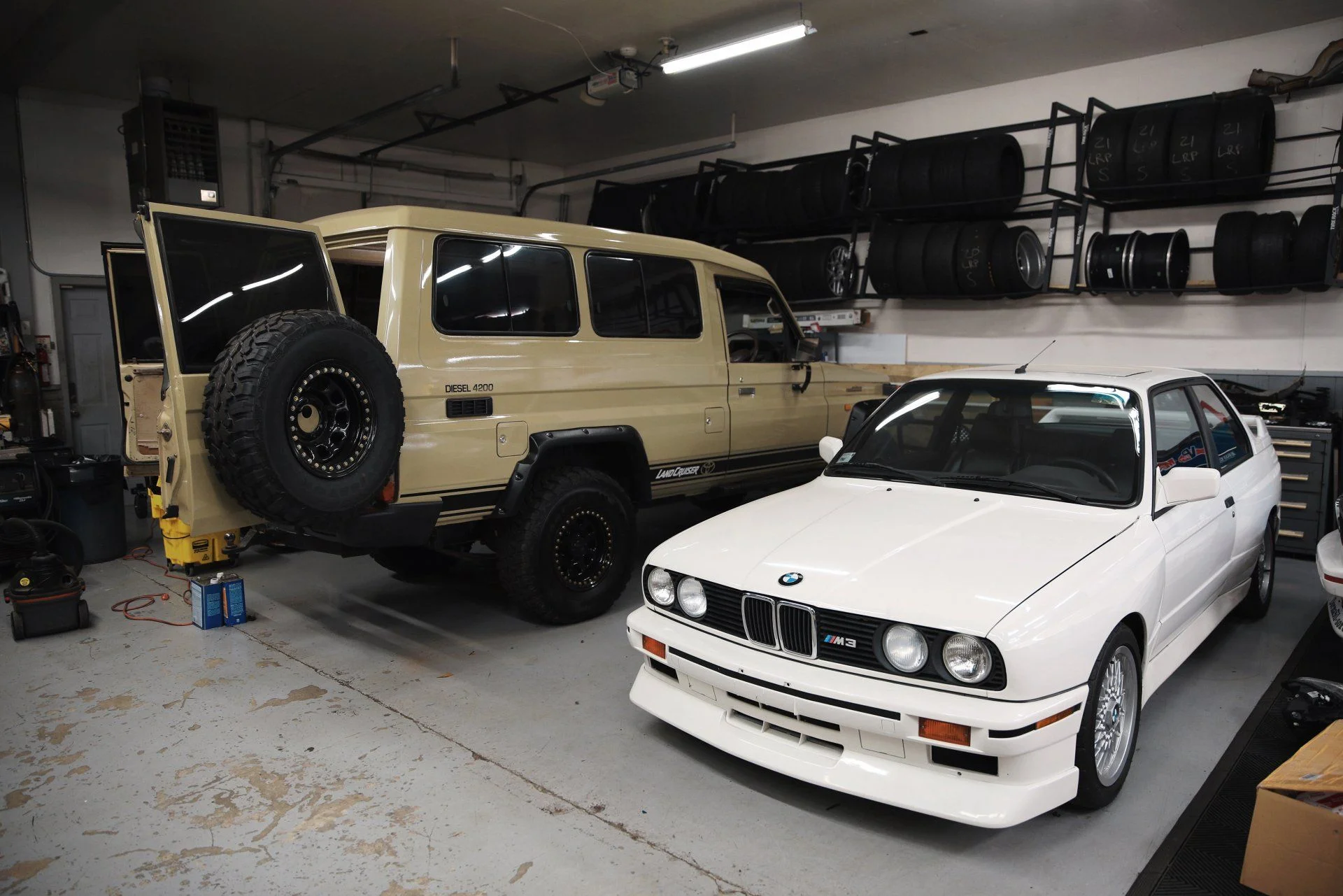

Slightly off topic -- does that e30 also belong to you? That is such an incredible duo. I'm so jealous I may s*** my pants
Haha the m3 is one of the boss’ collection. They’re such great cars. I have an e36 myself, as well as the wife. BMWs were the first automotive love for sure.
Love the e30 M3, purchased one new in 89, Salmon Silver with grey leather. Sold it in 92
