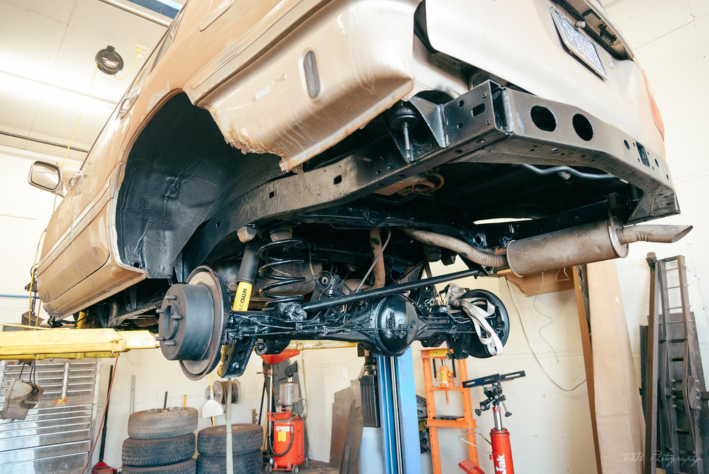

With the front end put together, I moved on to the rear. I have no idea why I decided to do one side at a time rather than one end at a time, but that's how it ended up. I pulled the upper trailing arms out as I was planning on cleaning them up, but the PITA factor coupled with wanting to be able to adjust the pinion angle pushed me to MetalTech adjustable arms. We shortened them by two turns on the Johnny Joint as a guesstimate to compensate for the lift. Then the rear spring was installed, followed the shock. I liberally applied grease to the bushings on the control arms, and slapped them in.
Check it out!
With one side done, my friend announced he had finished cleaning up the rear sway bar, driveshaft, and sway bar brackets. I hit them with a couple coats of rust converter before laying down three coats of paint all during breaks in working on the passenger side suspension. Again, I started in the front and finished by getting the rear all buttoned up.
Now that those major components were in place, I cleaned up the bolts for the remainder of the front suspension parts and laid rust converter on them. Then it was on to the dust shields. Again, big thanks to @arcteryx for these.
I got those installed and then cleaned up and reinstalled the tie rod ends onto the spindles. Again, a few clicks of a torque wrench and a couple of cotter pins finished off the job. Then it was time to pack it in for the night and make plans to complete the front end rebuild.

I was down to the final few steps to putting Sandy back down on her own tires, just a few quick things left.
First up was the rear sway bar. Again, I had to drill out a couple of the mounting holes, but these were tapped to accept a slightly larger bolt rather than use a nut, as all of these fittings are difficult to access. I used a slightly extended SuperPro sway bar end link kit and OE rubber bushings on the diff. Everything got a healthy dab of grease before being reinstalled.
While I was at the rear axle, I also went to work installing my extended diff breather. I got the ARB kit, which I do like, though the plastic tubing is a lot more persnickety than rubber would be. I really like the upper breather though. I picked a spot on the firewall and mounted the manifold before pulling the old breather hose off and securing the new line to the rear diff. Then it was a long process of routing it up to the firewall.

With the truck mobile, my work was done for a short time. But rest assured, there's still plenty to do....
I love this thread. Keep it coming! I have the same rust spots on the body as you, so I'm definitely keeping an eye on your solutions. For the rear quarter panel, I'm planning on just grinding that down and capping it as is. Is that what you guys are doing?
I've had to drill out my sway bar brackets as well, the same ones as you. Front and one rear. I quickly diverted on the rear one once I broke the first bolt on the frame. I figured all of them would have to be drilled out, so I left the old brackets on there for another day when I have more time to drill out bolts hah.
