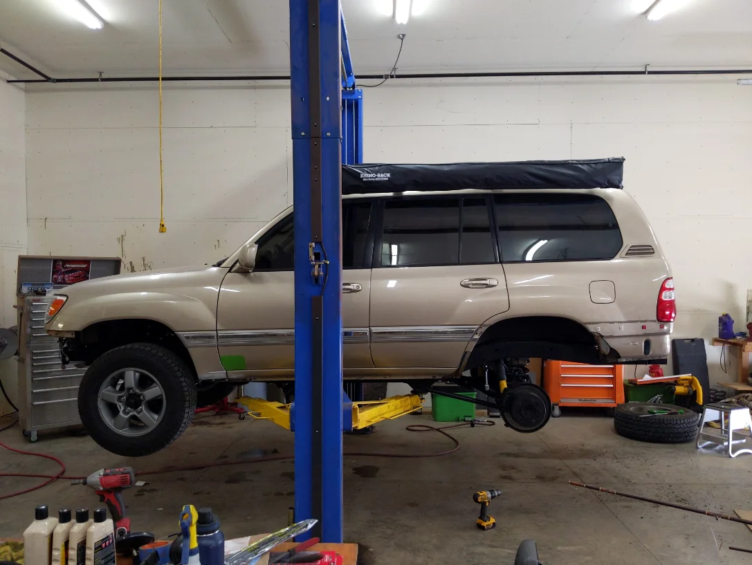

Sandy: 2003 Land Cruiser 100 Series Rebuild & Upgrade Thread

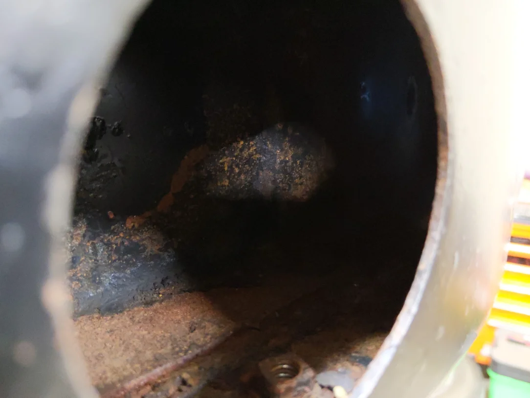

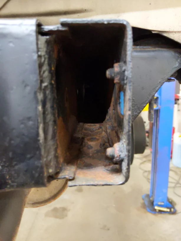

I had a chance to get over to the shop last week and put my rust buster to the test.
Good news: it worked.
Bad news: it worked briefly.
The drill attachment was hokey at best, so I ended up figuring out a way to slap an electric impact on it and used that for a bit. Unfortunately, I melted the plastic drum, so I had to come up with a better solution.
The metal snake part is essentially a long, tightly coiled spring, so I clipped off an 18" section and figured out a way to attached three links of chain to the end, then I cinched the other end in a drill chuck. Et voila, a new frame cleaning tool! This worked better, but occasionally I would snag something in the frame which would turn the spring into a pretzel, so I remade this tool a few times.
After about two hours, working front to back, I was satisfied with the result. I hit the entire length of each frame rail, as well as each crossmember. I spent extra time working on the rear section of frame, as this is the most corroded. Then, starting from the front, I blew compressed air through the frame until debris stopped flying out the rear of the frame rails. There was a copious amount of junk that flew out, so I'm glad I took the time to do this.

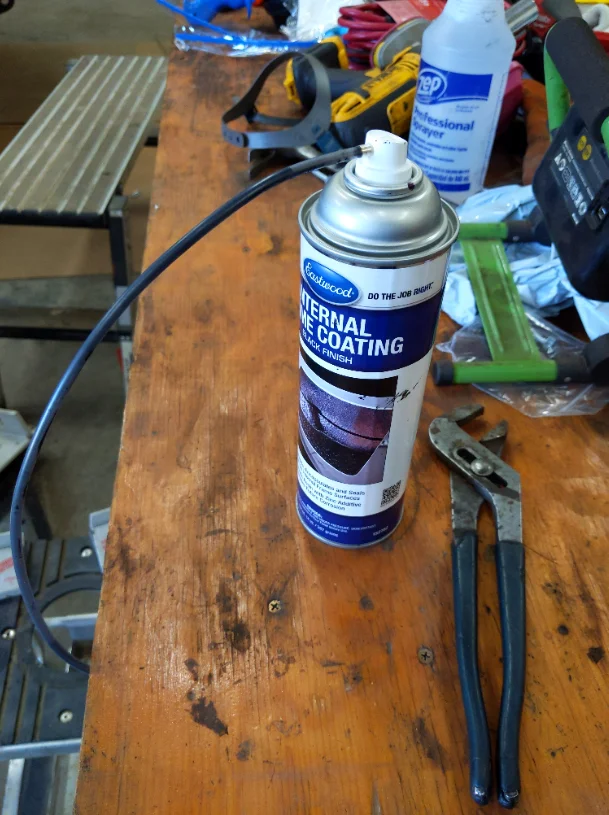

I received the internal frame coating this weekend, so my plan is to get over to the shop at some point soon, tape off a bunch of frame holes, and get the frame coating laid down front to back. There's some areas of the rockers I'll probably be able to hit too.

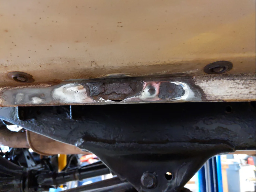

After rust busting, I took a grinder to the pinch weld and opened up the places were corrosion had eaten through the outer layer. Once I cleaned those up and got to substantial metal, I began fill-welding the holes, then grinding off the excess. I have one of the holes mostly filled in and ground back, I just need to finish it up and move on to the next ones. Shouldn't be too long. I'm hoping I can get this finished up soon and get primer on the pinch welds so that can be crossed off the list.

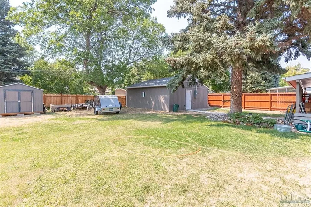

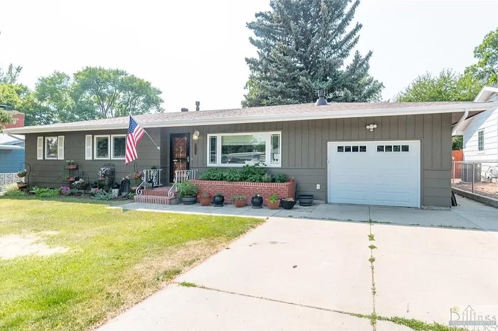

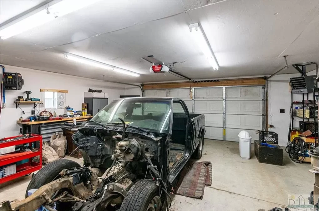

We close on a house 9/3. Took us a couple months of searching in the hottest real estate market in America, but we found what we needed. 2400 sqft in a nice neighborhood, nicely updated, original wood floors, big yard, and plenty of trees. Importantly, it has two garages. An oversized single-car is attached to the house, which is spacious enough as it is. In the back yard, though, is an oversized 2-car garage, fully insulated, heated, and with 240v power already set up. Just needs some additional lighting and workspace figured out.
Which brings me to a new project: setting up my own personal shop. Because there is an attached garage and a shed, nothing but shop stuff needs to happen in there. It's my own space. So now the question is how to arrange it and get the most out of the space. I have a few ideas brewing, but my ultimate goal is to turn it into an ultimate modern workshop/garage/hang out area. I'd like to build some chairs out of car seats from a junk yard, with seating and a TV mounted to the wall. I have three Whalen industrial shelving racks from Costco that could easily be made into a workbench and storage/shelving. I'm trying to work out how to arrange everything and keep it tidy. It's going to be quite the project!
Meanwhile, the house itself will be updated as well. The whole house will be painted since there are some dark colors that need to be exorcized. The kitchen will receive painted cabinets and a new countertop. We'll probably throw in some light fixtures too, and I'll build a pallet wood surround for the fireplace upstairs.

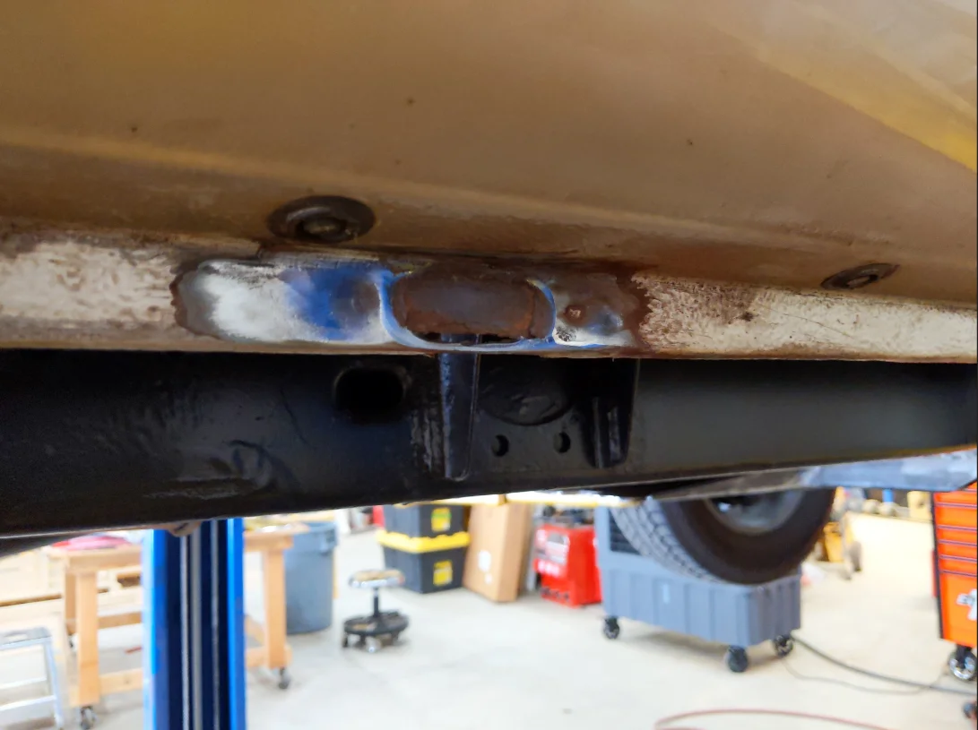

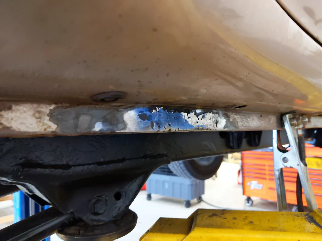

Next up, I pulled Sandy back into the shop to continue working on some of the necessary rust repairs. I'm starting by giving attention to the pinch welds.
The passenger side pinch weld showed three bubbling spots, otherwise everything was nice and straight. So I got out the wire wheel and began peeling back the layers until I hit clean, albeit pitted, metal.
Once I got to this point, I cleaned it up a little bit more, than started filling the damaged area with weld. Now, this probably isn't the best way to solve this, but I think with the work I put in plus some rust encapsulator and primer, it won't give me any trouble going forward. The perfect cure for this would be to peel the outer layer of pinch weld away, add material, and get it welded back together. Being that this area is no longer going to be enclosed by the side steps and that Montana is so dry, I think this approach will work out fine. I do plan to grind away the undercoat and reinforce the backside of this seam, so I'm sure this will be enough for a long-term solution.
My original welds didn't take very well, so I had to go through a bit more cleaning before everything started to go my way. Once I had this sorted out, I was able to get decent fill. Then I ground back and did more fill-welding until I got a pretty smooth result. This is a "half-way" stage.

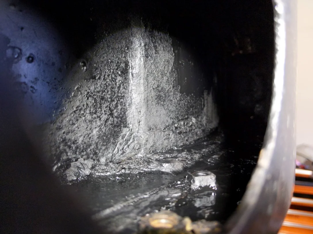

Next up was attacking this nasty crap.
This is after my roto-rooting of the frame and blowing the dust and flakes out. @crolison had pointed me towards Eastwood Internal Frame Coating, so I took a stab at it. I masked most of the frame holes (which turned out to be not nearly enough) and used the extension tube to hit the frame from front to back. I used 4 cans and think I should use one or two more for the crossmembers and rocker panels. This stuff is no joke! I'm very impressed with how effective the coverage is, and it seems to do a real number on the rust as well. Hopefully this will be the end of the line for any internal frame corrosion.

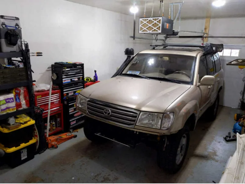

BIG things have happened!
I did a few things on the shop to get it prepared, but the cold weather moved in, took away the already meager humidity, and caused flooring temps to drop. As such, I won't be getting the floor coating completed until conditions improve. However, I did make some big steps towards getting back into the Land Cruiser.

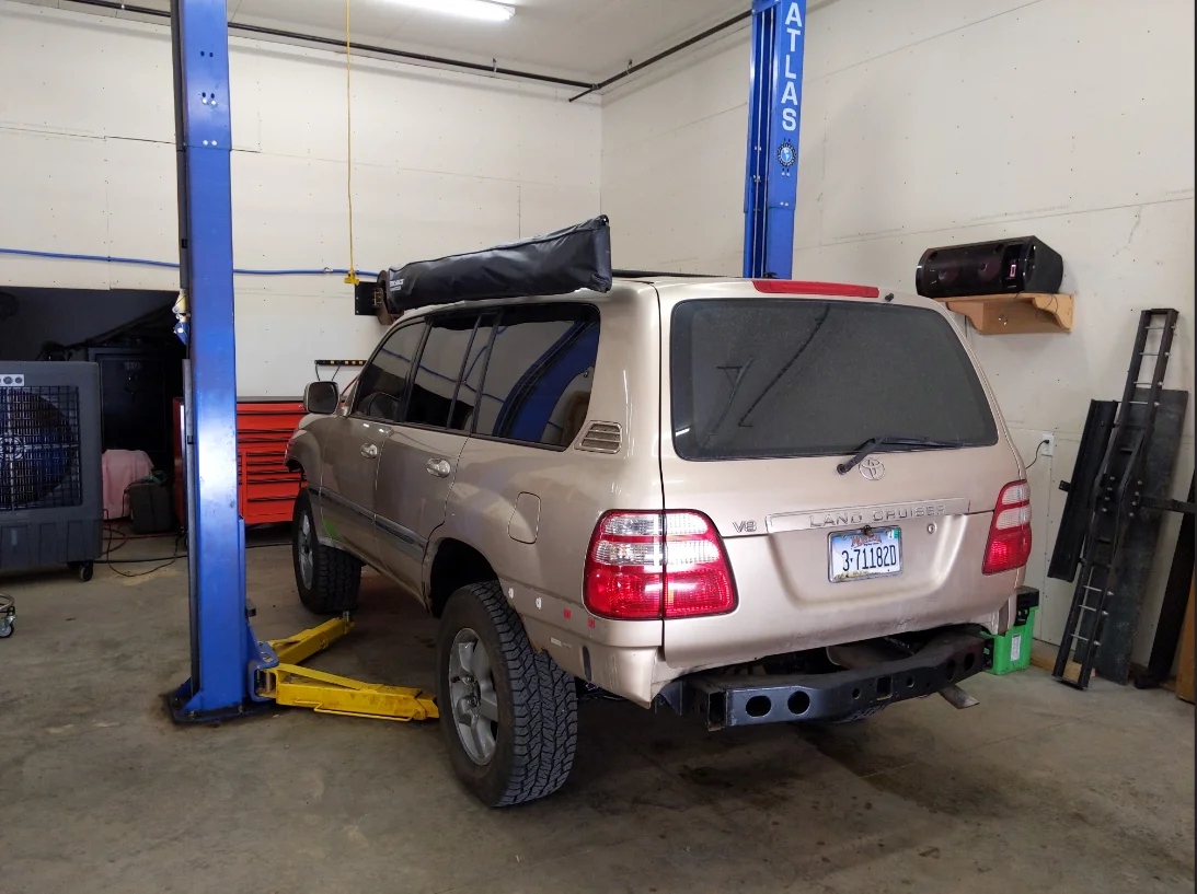

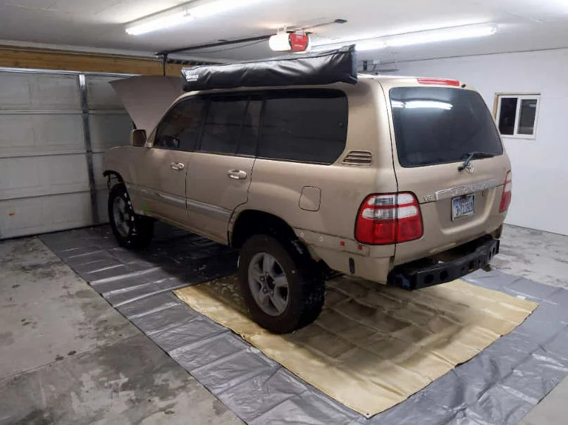

Primarily, I brought Sandy home. Due to a foot injury and needing a scooter to get around his shop, my brother in law requested I move her, so I picked it up and drove it home.
In order to keep it out of the weather (raw metal) I cleaned out the attached garage and got her parked inside.
It dawned on me that since my brother in law was once again laid up, I would need to work on the body repair myself. I watched a lot of videos and did plenty of research to figure out what I needed and the kind of work I would need to do. Luckily for the stuff that will be visible, I have patch panels, which makes life a lot easier. But I still needed some things, so a trip to Harbor Freight got me set up.

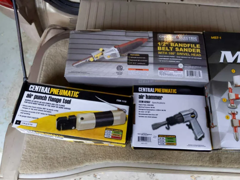

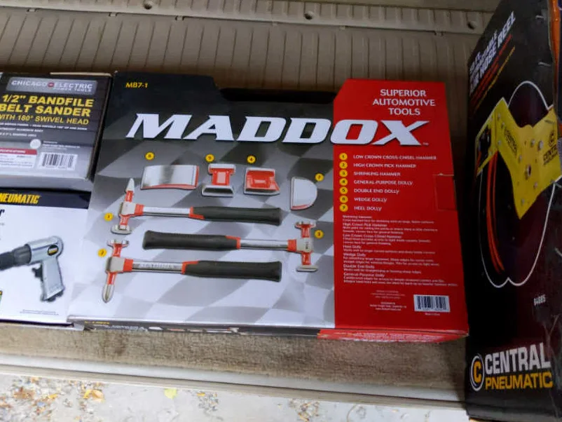

The flange/punch tool will allow me to make lap joints where necessary and plug weld body panels together, which will be a big help. The narrow belt sander will allow me to more easily open up spot welds and clean out rust spots on the hatch and doors. The air hammer will help me separate the layers on the patch panels so I can weld each individually.
I also picked up a hammer and dolly set for planishing work.
I picked up a few other things as well, and made an order. For this:

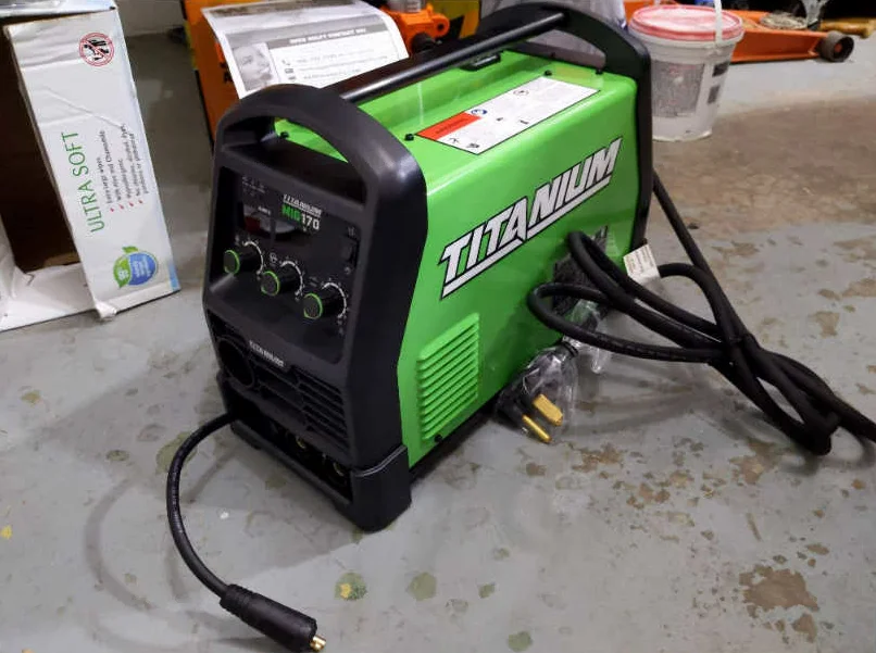

Since the shop has a 220v outlet, I could afford to pick up a 220v MIG welder. This is HF's Titanium, which from all reviews seems like an amazing deal. For my relatively limited use case, I think this is a good investment and plenty of welder for me. Reports say up to 1/2" plate is doable, but I'll likely never need that capability. Can't wait to get going with it!

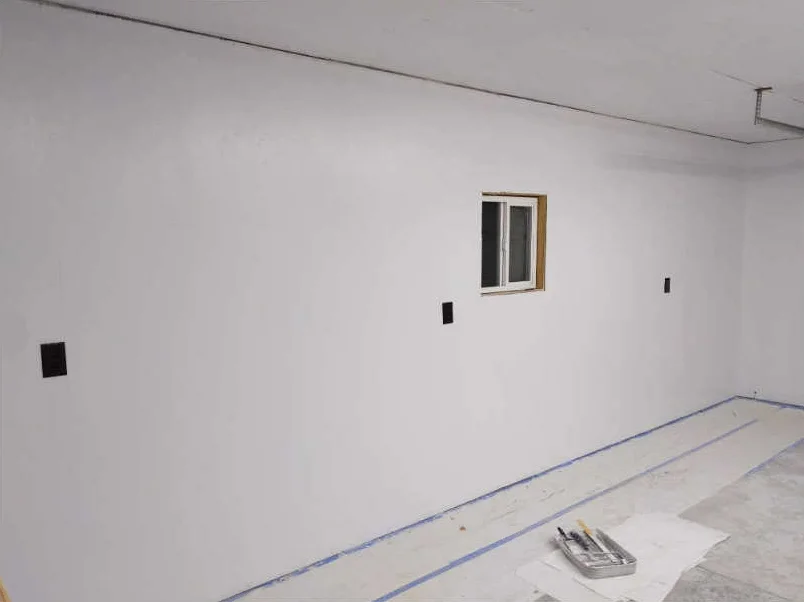

Originally, I was going to get the flooring done, panel one of the walls in old pallet wood, get some benches and cabinets built, and a few other projects to get my shop space up and running. Unfortunately, due to the weather, I opted to wait on the floor coating. I had already completed the wall paint, which was a feat. I used patching plaster and a load of paint to smooth out the OSB walls, so they're nice and smooth now.

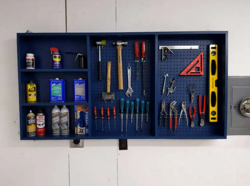

I then built a wall cabinet to get some tools and consumables moved into the shop. This is the color the cabinets will get painted.
With my brother in law laid up, the weather changing, and spring/summer getting closer, I decided there was no sense putting it off. I Picked up a large tarp and welding blanket from HF to protect the raw concrete, then laid it down in the shop and got Sandy moved over in preparation of metal work.

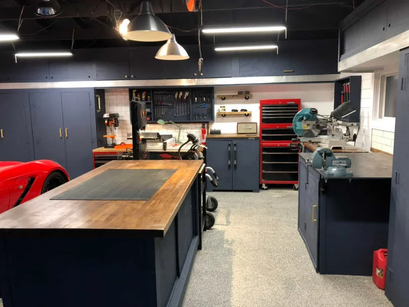

Nice space you made for yourself! Our garage is so tiny it’s useless for a shop space, I’m working on a deal with my buddy who has a shop just down the road to be able to get my Scout project up and running again over the weekend too. Good luck with the deadline!
Looking good, the great thing about our rigs is they are worth bringing back to life.
Thanks Dan! The space is getting there somewhat, but it's a lot slower than I want. Such is the way it goes I guess. I'm really working hard on making this a genuinely useful space but also a cool place to hang out. There will be a TV, coffee table, and seating. Should be great once it's done. Aesthetically, I'm stealing a lot from this gentleman:
I'm planning on doing cabinets like this along one wall, with 208" worth of 18x24 cabinets and one 72x60x18 behemoth. Should make it very functional and very nice looking.
I have dealt with those tiny, useless garages before. It's awful for sure. I can't tell you how excited I was to find this place complete with detached shop. I do wish the building was a little bigger, but I'm not going to complain.

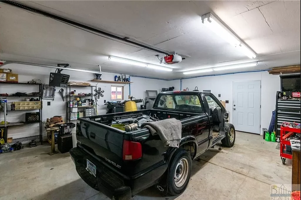

1975. Here she is in all her leaky glory:
So much work to be done to get it functional and much of it tedious, still motivated to finish it though!
