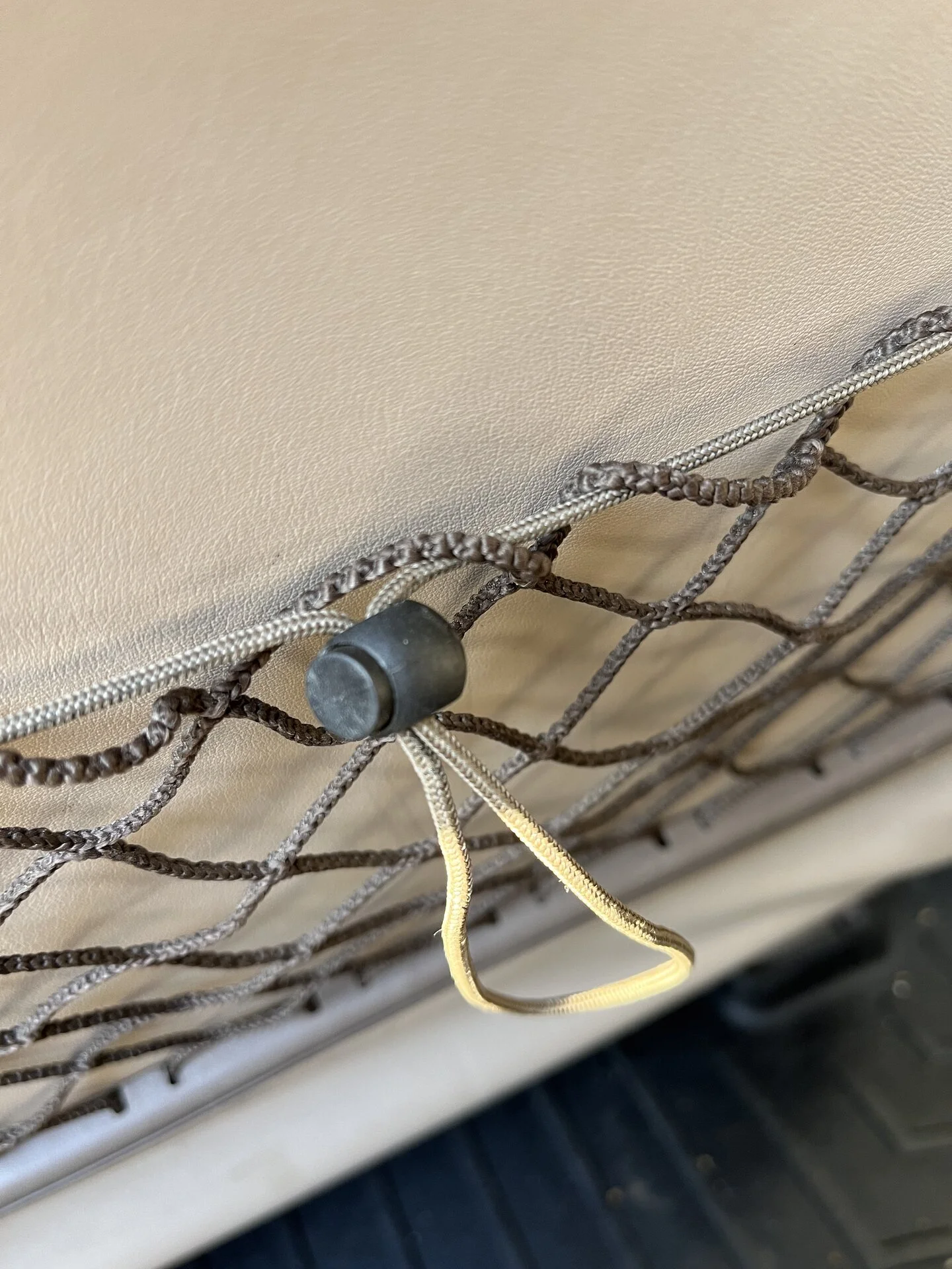

Thought I'd share an easy hack I came up with that eliminates droopy seat back netting. See pics, just loop the center of the cord and slip a sliding cord lock over it. I did this awhile back so this link isn't available but there will be multiple options on Amazon for 'sliding cord locks'. Craig

Occurred to me, but thought I’d throw it out there on the off chance I’d had an original idea that others could use.
Nothing wrong with that. Serves as a reminder to most and a newbie might never has seen it.
Just glad you fixed yours, hate those saggy webbing's.
I would have never thought of this. Thanks

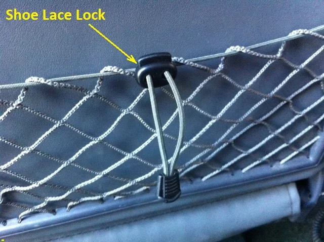

I’ve had the shoelace solution for years but because the fob sticks out a little I’m always catching it when loading things in and out of the rear footwells and constantly having to re-tighten them and it’s annoying.
