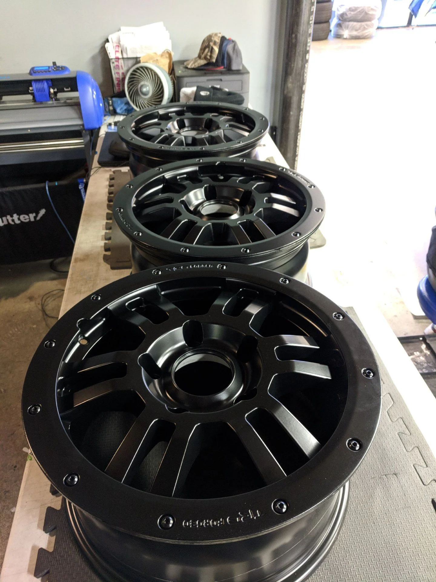

I'm getting ready to do change wheels & tires on my 19LC. I really like the look of the ICON rebounds but have to admit just inherently feel better going with the proven Toyota product. Any thoughts would be appreciated.
Secondly, if I go with the RW I think I'd want to powder coat the lock ring a matte black. Has anyone done this or have any negatives to this approach?

TRD CENTER CAP IS BLACK AS WELL .
