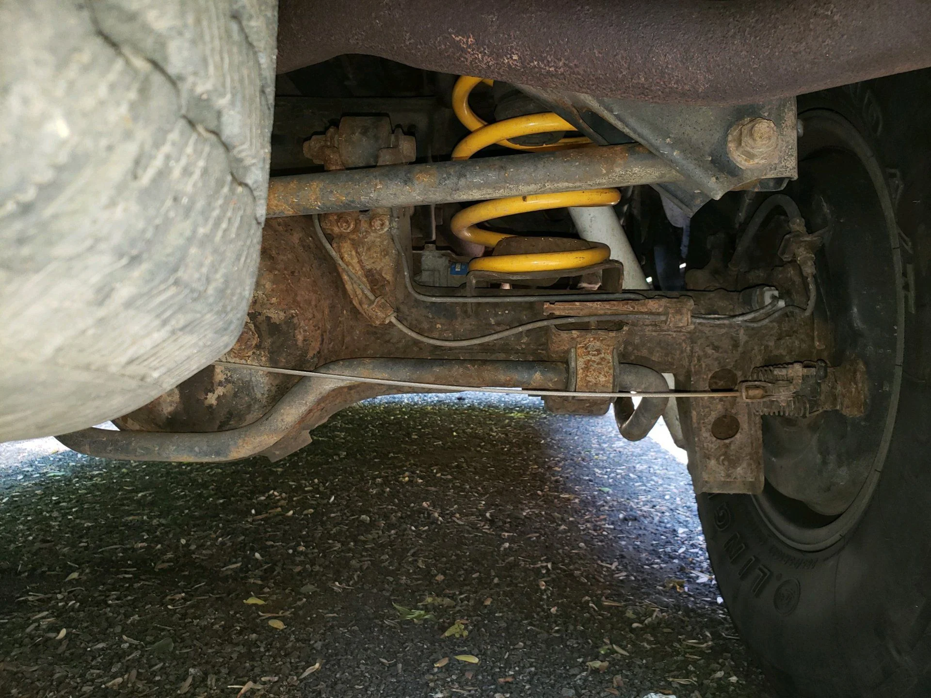

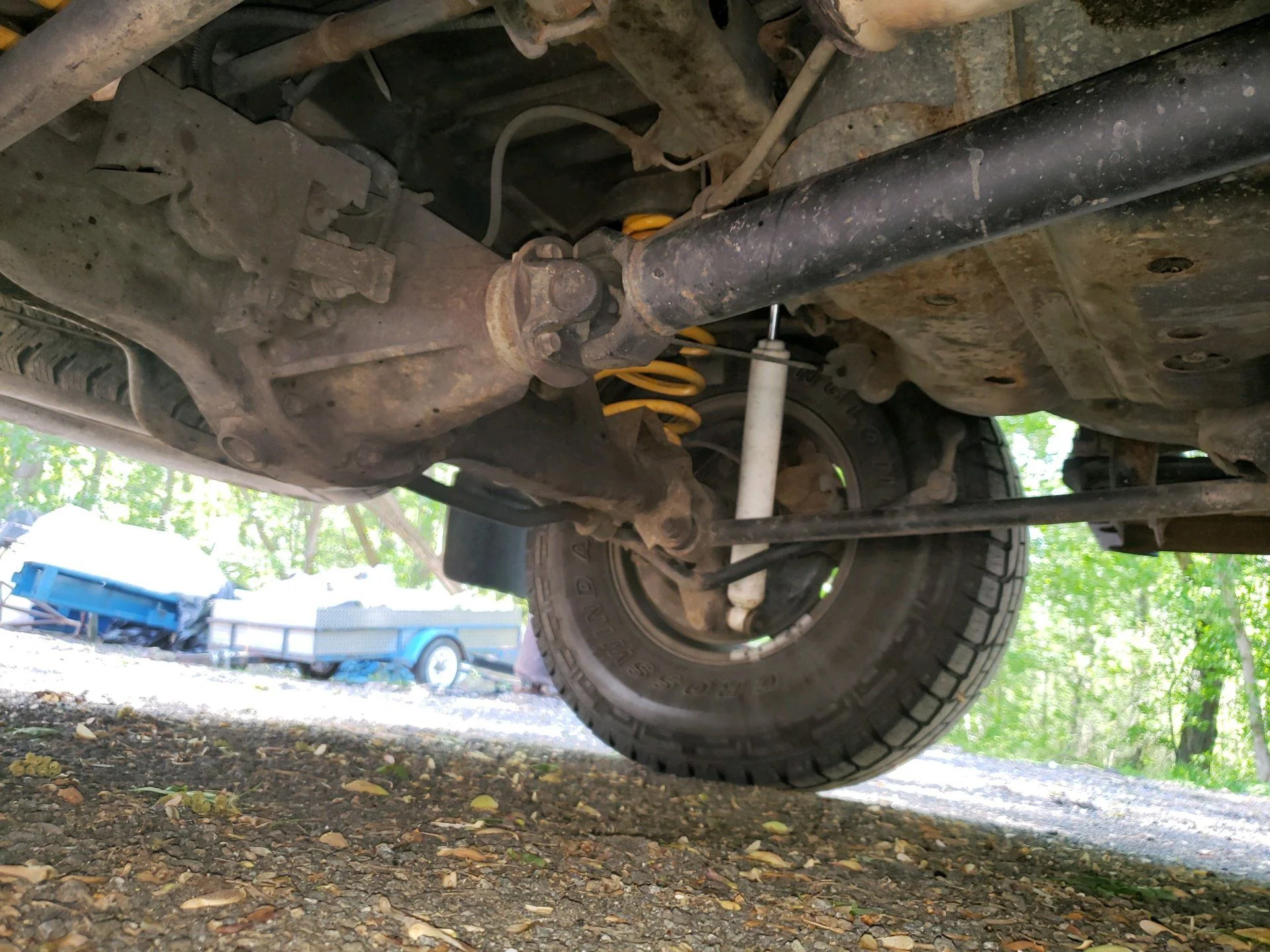

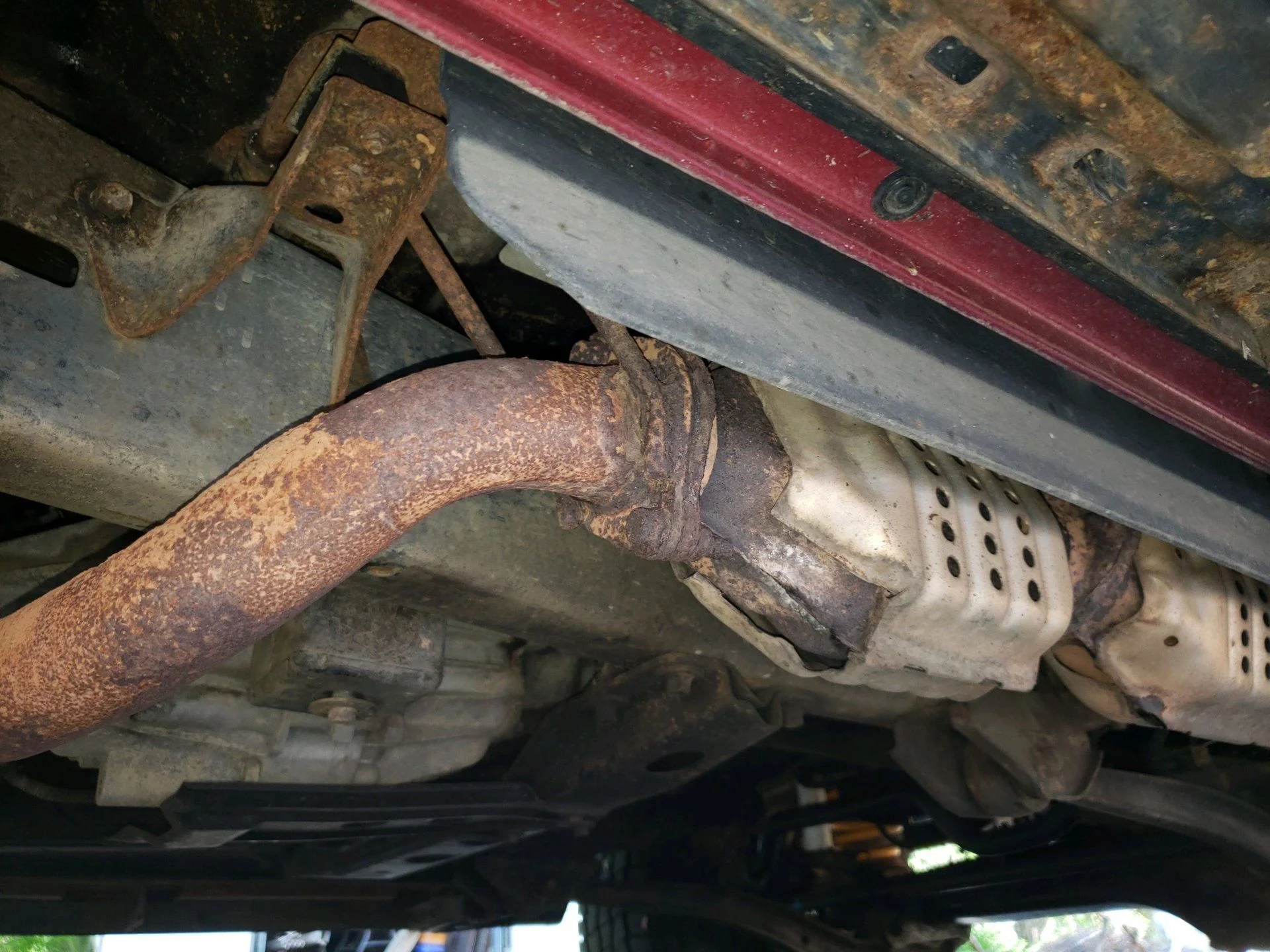

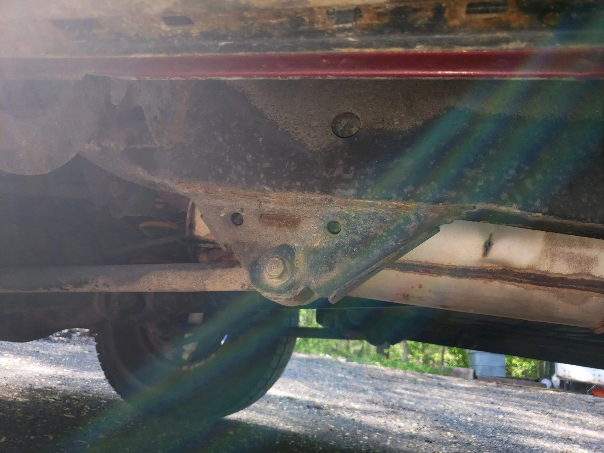

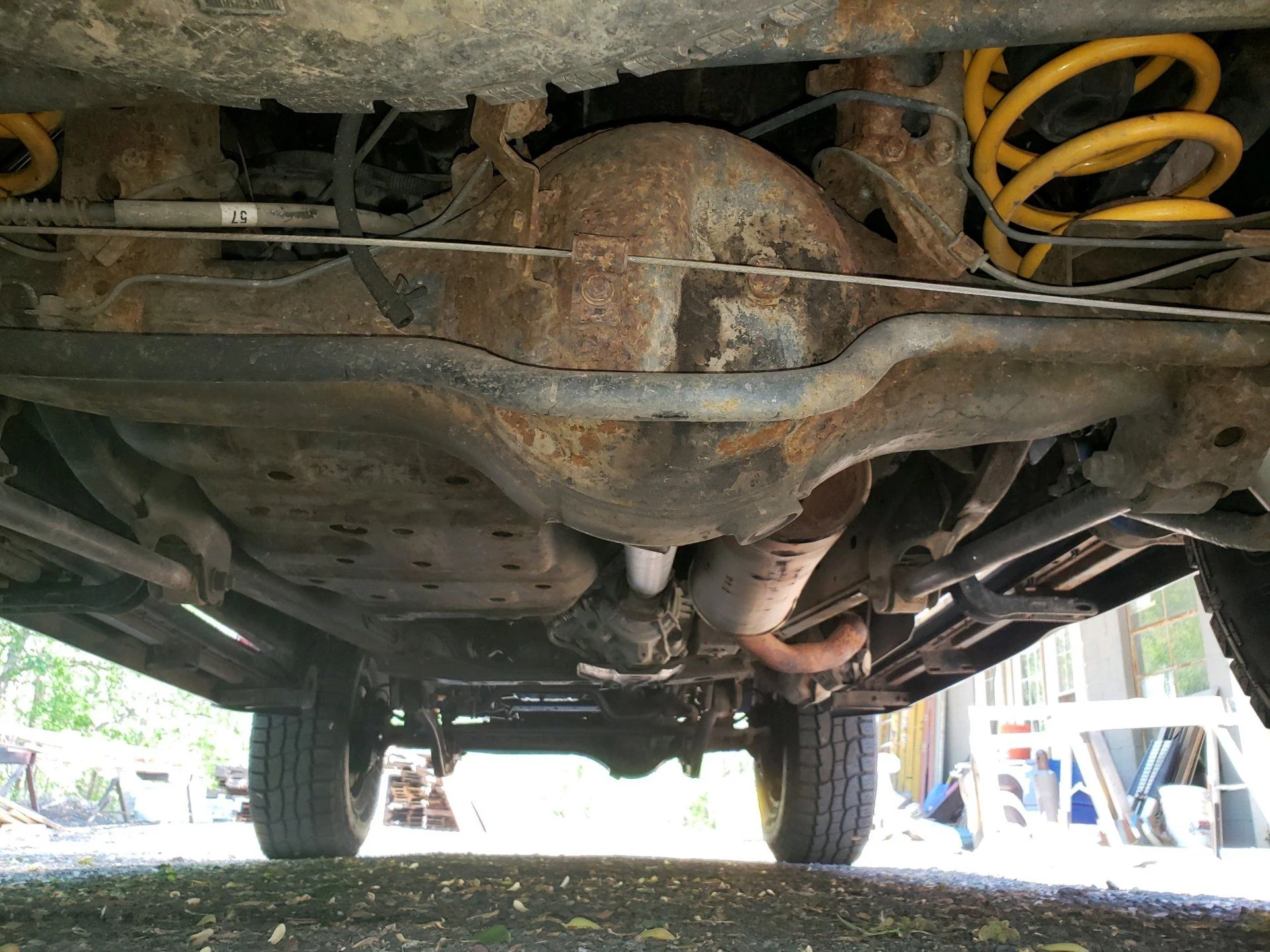

Former FJ-62 owner. Considering purchasing a '95. Here are some pics of the underbody. Is this amount of rust concerning? Thanks in advance.
In my opinion, looks to be some pretty light surface rust. Nothing a few beers, a wire wheel and some black paint can’t fix. Use fluid film or this Ultimate oil undercoating guide (DIY Waxoyl)
The worst rust I had was on the arms holding the running boards on. Just keep up with the rust prevention and it will be good
