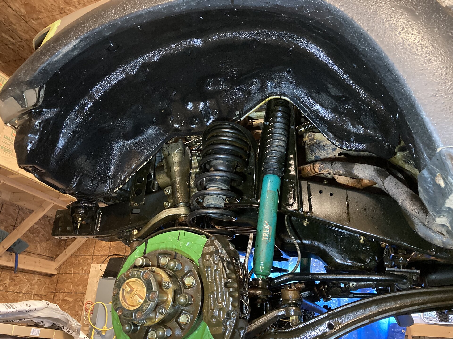

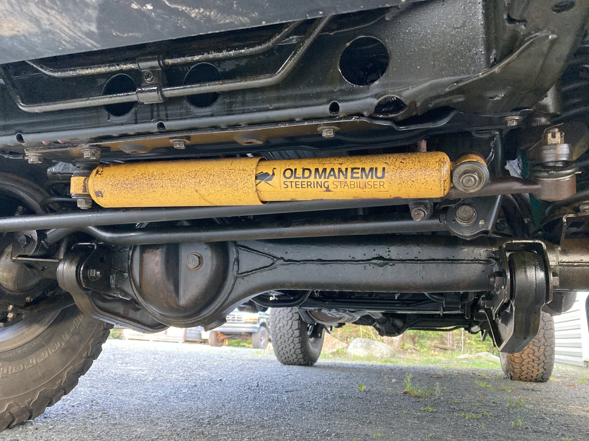

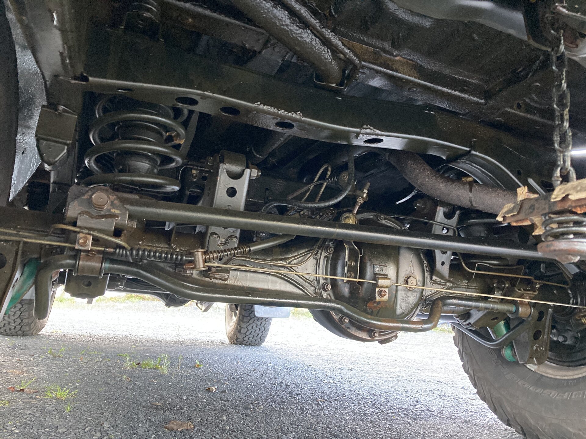

I did my 80 in cosmoline this fall and expect that it will work quite well. As mentioned it’s only as good as the application, so I cleaned everything real good, removed a lot of parts and used a gallon of the “industrial grade” as well as 4 cans of RP-342. Also filled the insides of the frame rails and panel cavities with red Rust Check which creeps very well and doesn’t seem to break down the cosmoline (fluid film does).

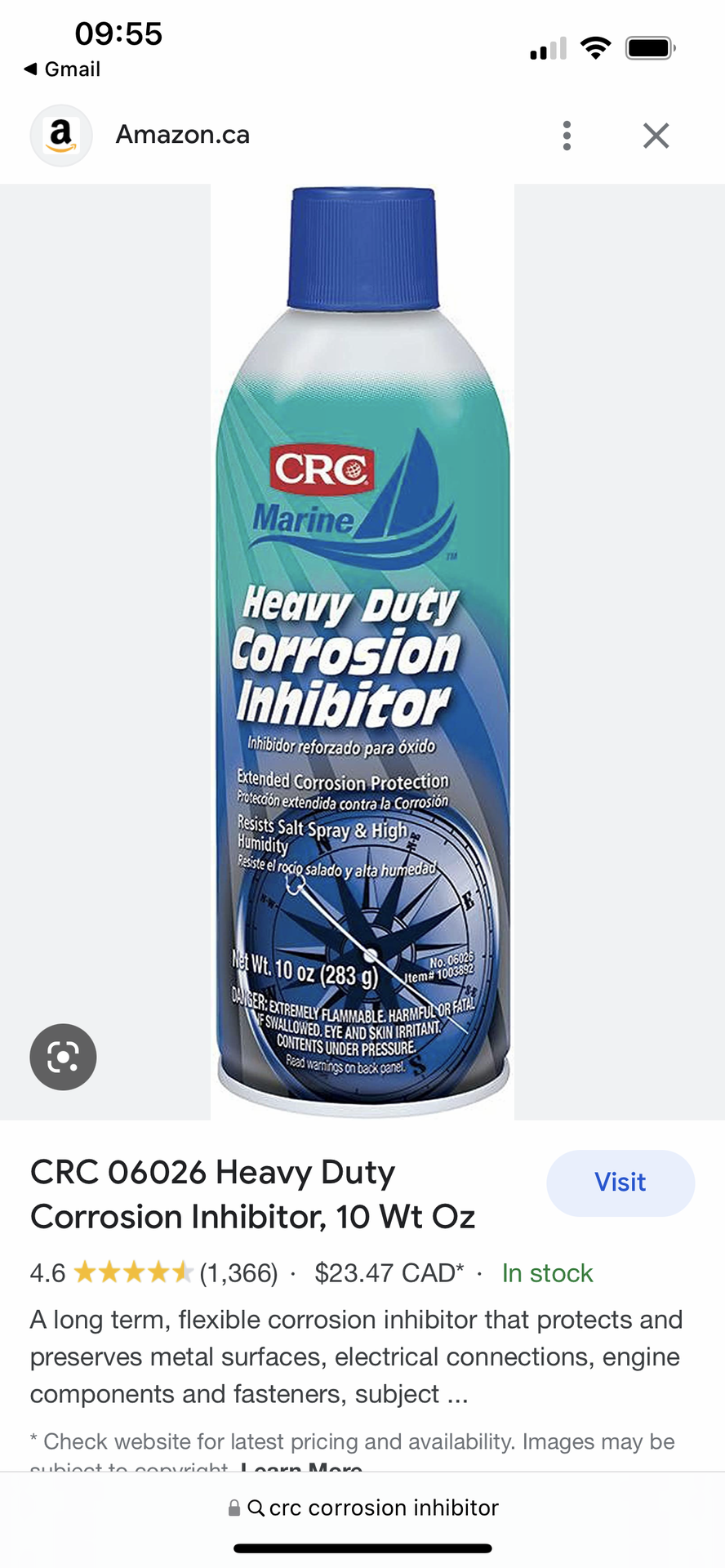

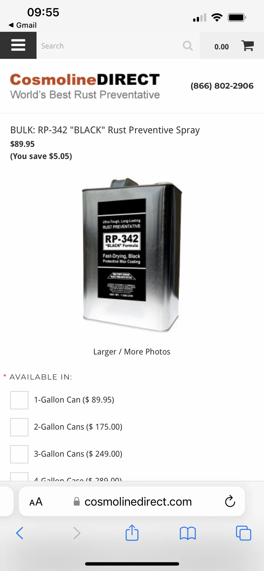

Think you could post a picture of the actual can of Cosmoline that you use? So I can see exactly what it is. I keep seeing the name, but
this stuff comes in all kinds of brands. An a pic of the RP-342 as well. Thanks. I've been holding off, but looks like my 60 is about

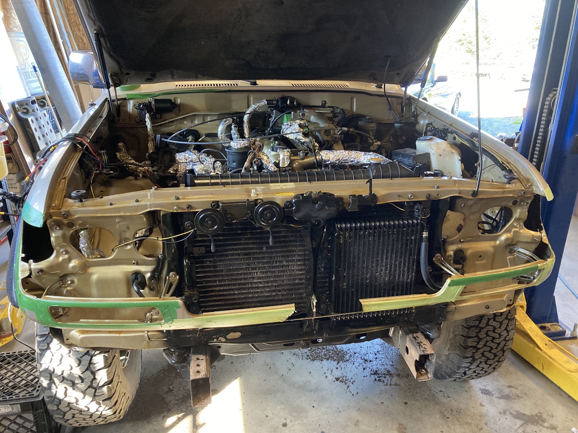

Sure thing. I used Cosmolinedirect’s RP342 “Industrial grade” in bulk for the chassis and most of the underside. I used RP342 “Black” for the wheel wells, because they accidentally sent me some. And I used RP342 in spray cans for the engine bay and smaller pieces of hardware, etc.. I also used CRC Heavy Duty Corrosion Inhibitor in spray cans, which is essentially the same as the RP342, just lays down a little nicer.
I noticed that the RP342 Black (Id assume regular RP342 would be the same) came out of the jug almost like water, where the industrial grade came out like 20w-50. It laid on really thick, which I liked.
